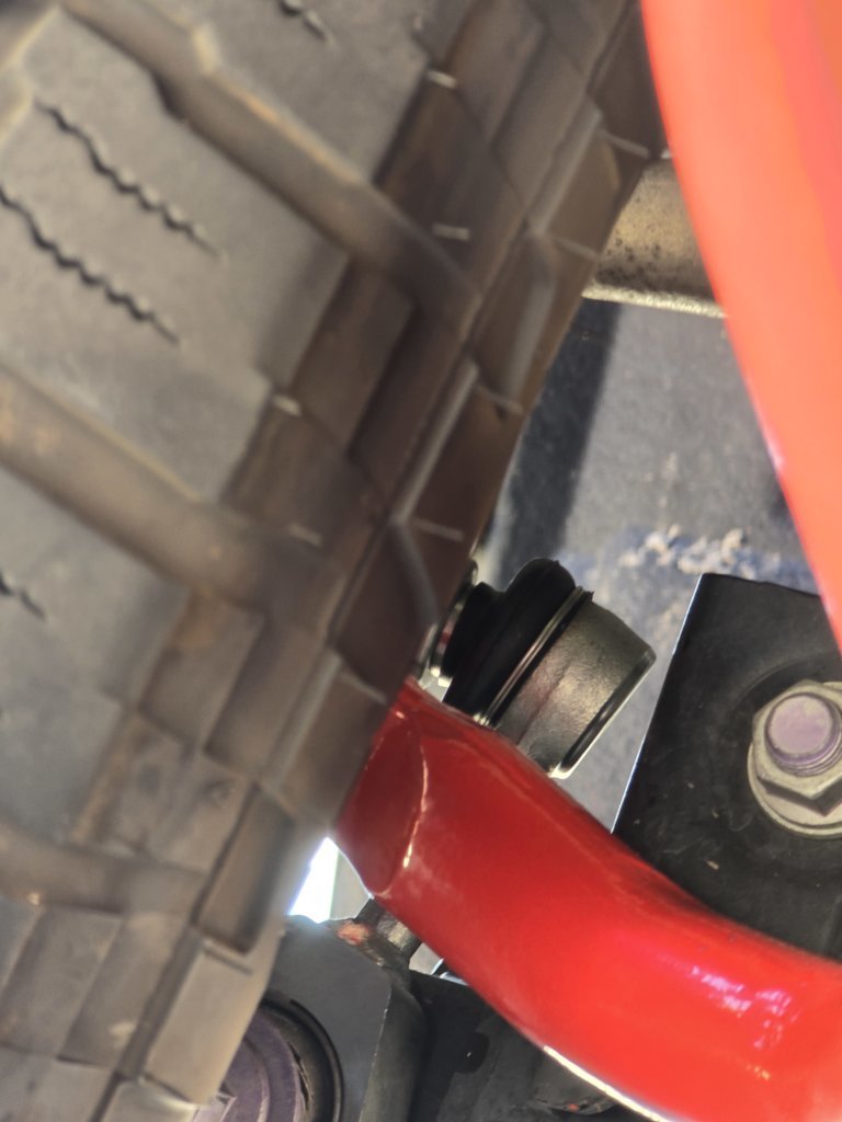

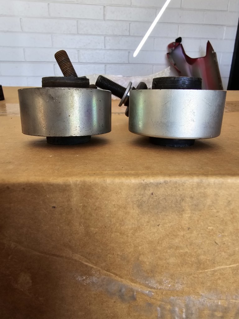

    @az 3rdGen
    Did you notice this tear... see below ?
  5. Jan 23, 2025 at 11:24 PM
    #125
    az 3rdGen
    az 3rdGen New Member
    Sep 1, 2023
    #103216
    212
    Arizona
    2022 Black Tundra SR5
    Yes I did. It's like a coating that cracked the second I tightened the bolt and it flexed. I think it's like a wax coating on the rubber bushing or something. Someone might have more info on what it really is. But I couldn't feel a difference when I ran my finger over it. I'll go out tomorrow and grab a new pic and see if it's changed at all.

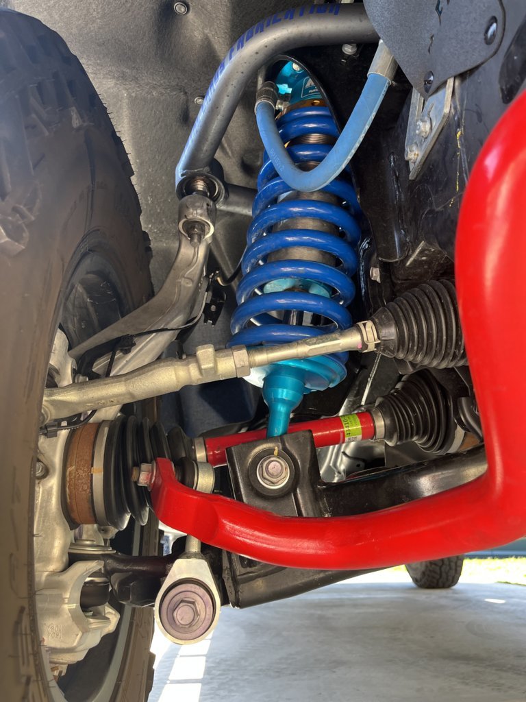

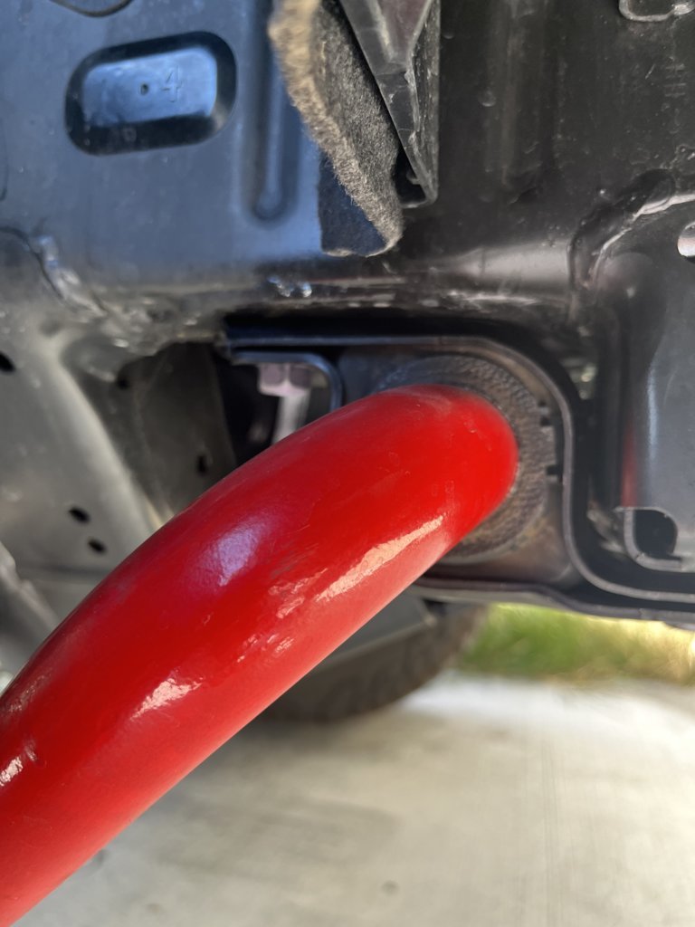

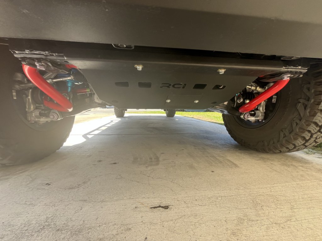

  27. Apr 5, 2025 at 7:20 PM
    #147
    lunar_rock_sr5_24
    lunar_rock_sr5_24 New Member
    Oct 3, 2024
    #123789
    31
  28. Apr 5, 2025 at 7:20 PM
    #148
    lunar_rock_sr5_24
    Oct 3, 2024
    #123789
    31
  29. Apr 5, 2025 at 7:22 PM
    #149
    lunar_rock_sr5_24
    Oct 3, 2024
    #123789
    31
  30. Apr 5, 2025 at 7:25 PM
    #150
    lunar_rock_sr5_24
    Oct 3, 2024

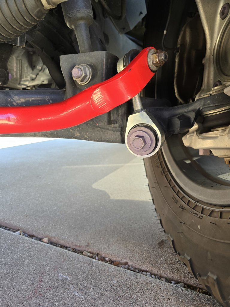

    #123789
    31

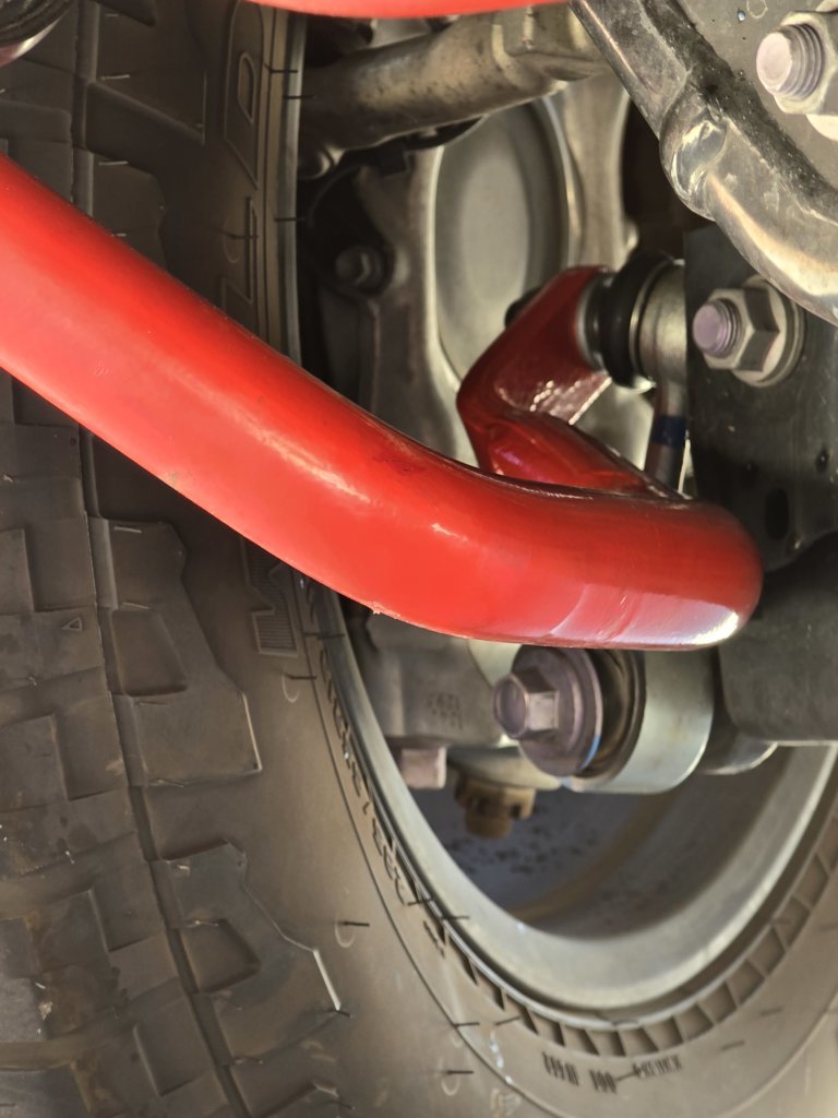

    Love it! A lot less front brake dive. Definitely has a lot better turn it. I have King 3.0 IBP. I am also not running the sway bar spacers too.
