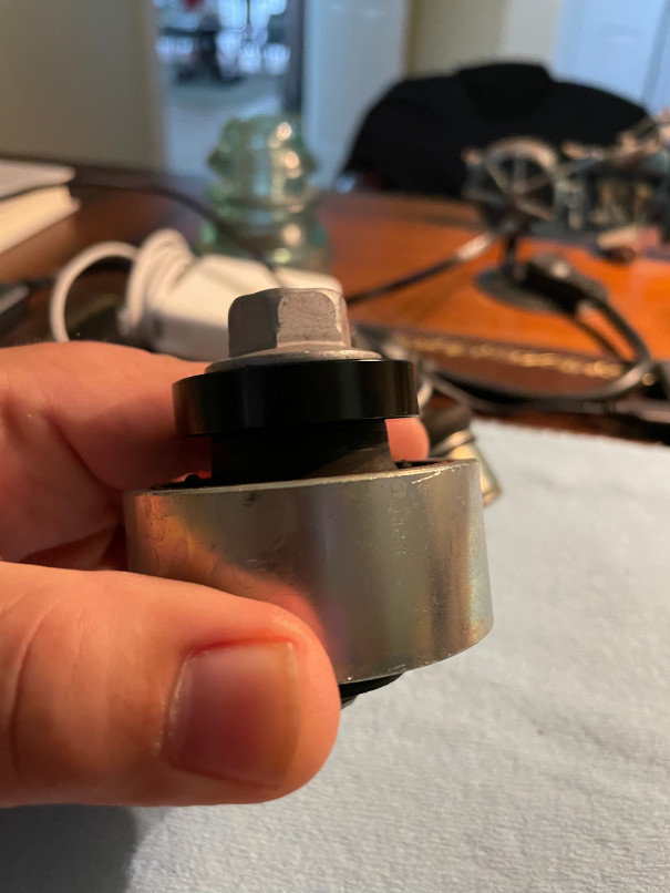

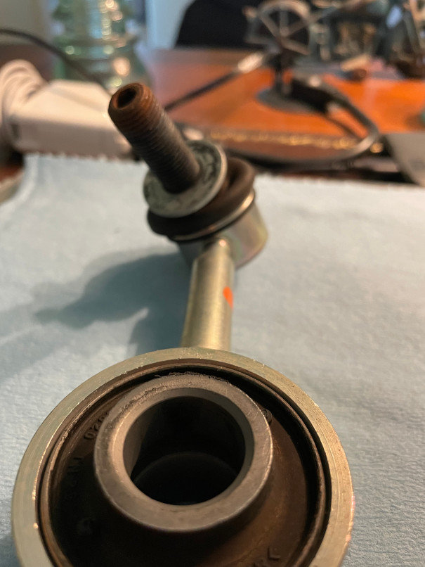

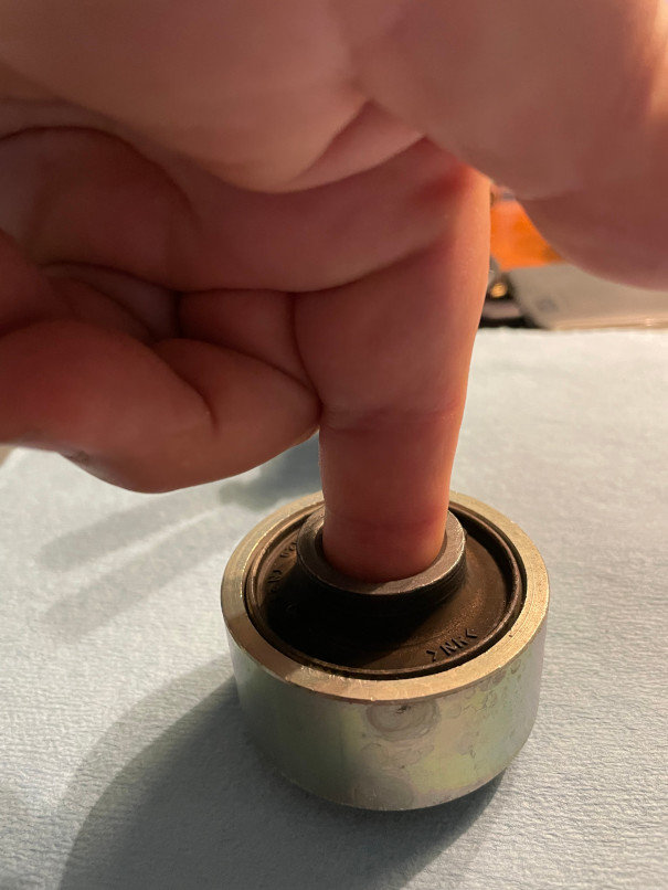

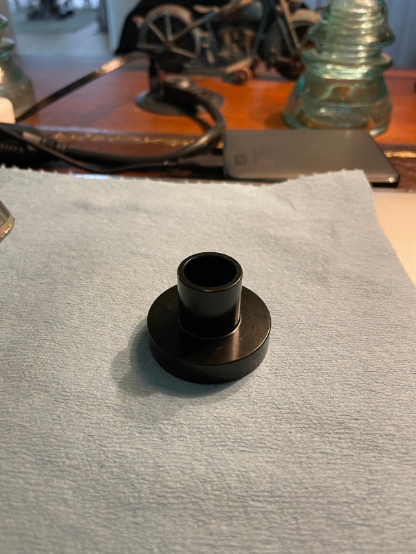

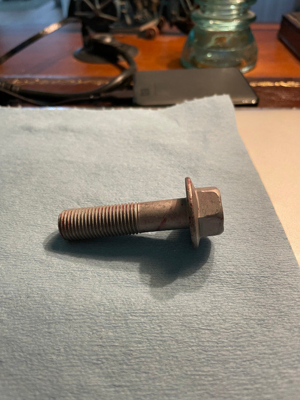

    Thought I would follow up. I purchased the bolts (90105-A0232) and PT983-34340 cap, link adapters shown in the TRD 3" lift kit instruction. The instructions are for the OEM parts. I don't have the 3" lift. I just used those instructions as a guide.
    The cap.link adapter can occupy that space.
    Due to the thickness of the end of the adapter, you need to use a longer than factory bolt.

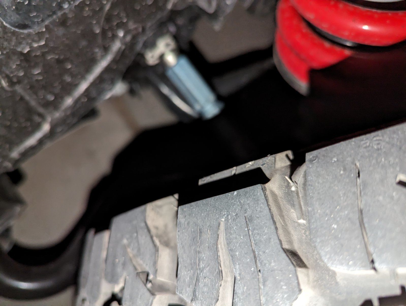

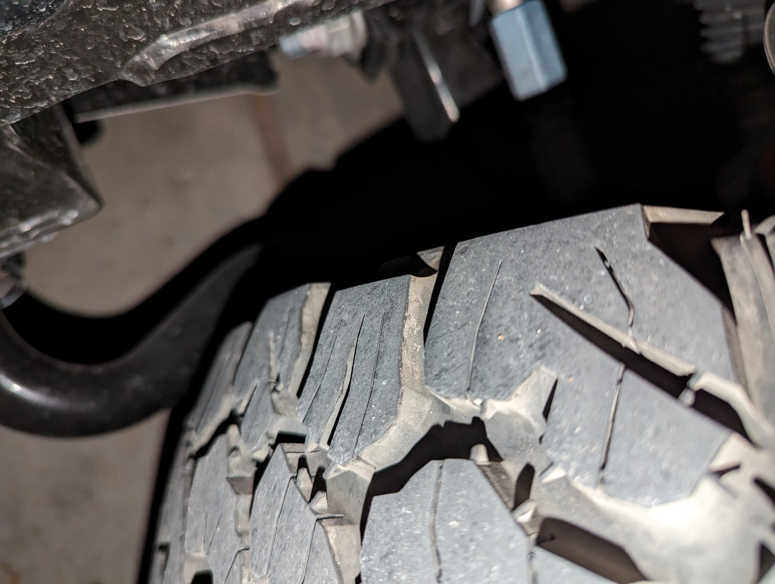

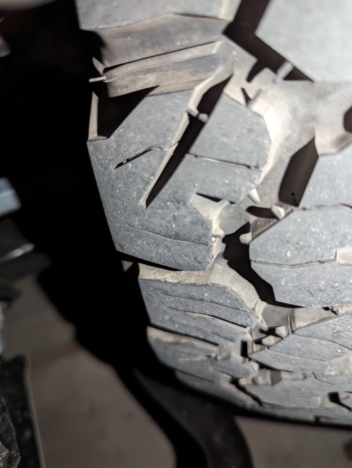

    I should clarify my statement... The sway bar is on the outside of the skid plate. It can't go behind the skid bar, for protection, without cutting out the corners of the skid bar. Sorry about the confusion.
    The adapters are between the frame and the sway bar connections. They are maybe 1.5" or so and are between the sway bar connection and the frame. There's a longer than stock bolt used to secure the sway bar. I hope that make sense :)
    ryanwgregg likes this.

    While not the best pics, you can (hopefully) see where the rub happens. This is only during a very tight turn, either left or right.
