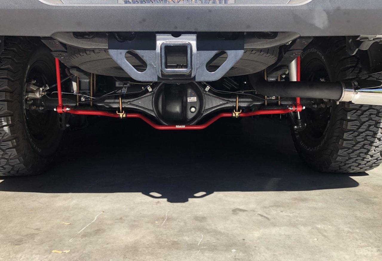

    103F4B5B-6058-4C09-9CE2-082B536609D6.jpg 7B617D8E-A381-4B80-9E38-C300872A7E8F.jpg I came here months ago looking for info on extended rear links, I wanted to contribute what I found to this thread.
    Hellwig does make extended adjustable links, #7963 for 6” lift. It’s Pricey and in my experience, it’s always on backorder. I wasted a few months waiting just to cancel my orders.
    It ended up working out better as I found BDS makes extend links, 2 sizes and at good prices. Arrived a few days after ordering. Painted them up and installed.
    https://blog.bds-suspension.com/?p=21587
