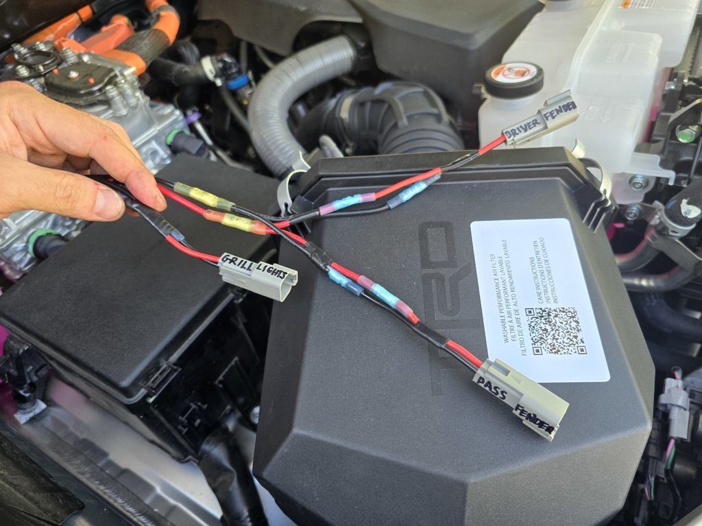

    Just finally installed the camo flares today. I had already added the TRD Pro rear spoiler, as well as the Heritage Grill with the “raptor” lights and light bar. I had my raptor lights just running off an ignition fuse tap prior to today. Today I did the 7 pin to 4 pin at the rear of the truck, ran hot and ground along the passenger side frame rail up to the engine bay. Tied all 4 fender flares, as well as the raptor lights into that. Works great.

    I don't mean to be pedantic - but to be clear - this method actually ties the marker lights into your parking lights and not your daytime running lights. That means the following:
    1) They will illuminate when auto-headlights come on
    2) They will illuminate if parking lights are manually turned on
    3) They will not typically illuminate during the day with your forward facing daytime running lights.
    I've seen a few people trying to debug some issues where these markers aren't illuminating w/ DRLs so just wanted to clarify!

    Correct. That’s actually the way I prefer them to operate. I don’t want all the extra lights on if it’s not dark out. It seems pointless (IMO) for them all to be on during the day. I had my (Heritage) grill lights tapped into the fuse box before I did this method, and I didn’t like that they were on all the time.

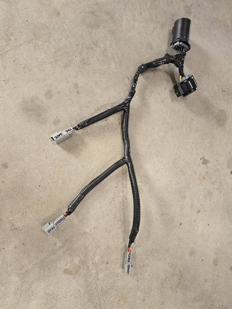

    Did they supply you with T taps or actual plugs? I just got mine in the mail and I’m questioning where to put the rear harness splitter. Has OEM style male and female plugs.
