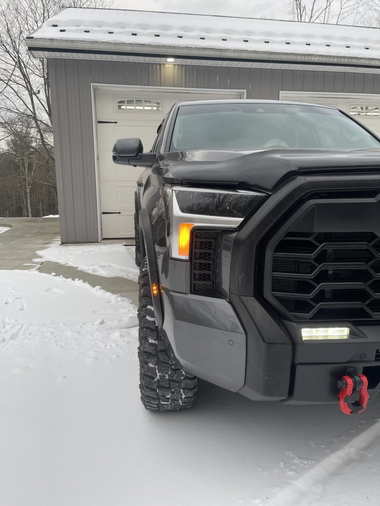

    Has anyone painted to match their truck color the TRD Pro Fender flares? I am assuming it can be done successfully, however might entail a few more coats of paint to hide the Camo design? Thanks!
  7. Sep 16, 2024 at 11:05 AM
    #667
    Ipaddick
    Ipaddick New Member
    Apr 16, 2023
    #95577
    684
    Canada
    Platinum hybrid w/advanced package
    I’ve seen a couple. One sanded down then painted. Another where they kept the camo. Both looked good.

    here’s gloss black. Seen mgm too.
    the one with the camo is a Mesquite and looks great
  10. Sep 16, 2024 at 11:19 AM
    #670
    Ipaddick
    Ipaddick New Member
    Apr 16, 2023
    #95577
    684
    Canada
    Painted
    Nighthawk84 likes this.
  11. Sep 16, 2024 at 3:20 PM
    #671
    Ipaddick
    Ipaddick New Member
    Apr 16, 2023
    #95577
    684
    Canada
    Not mine.

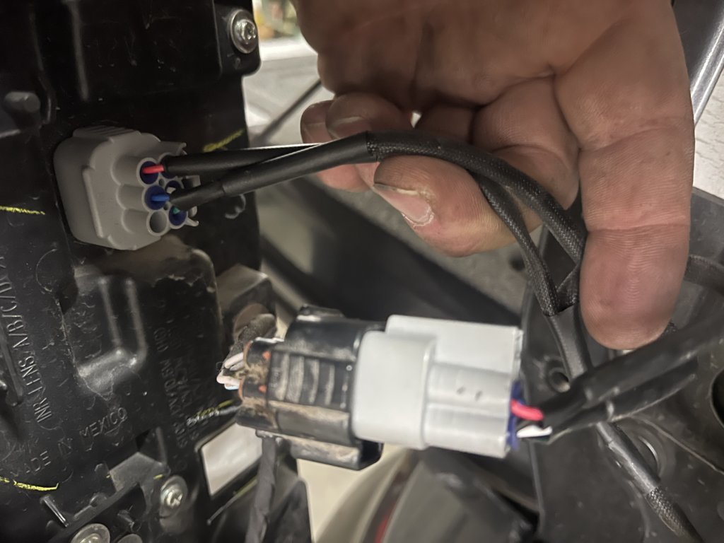

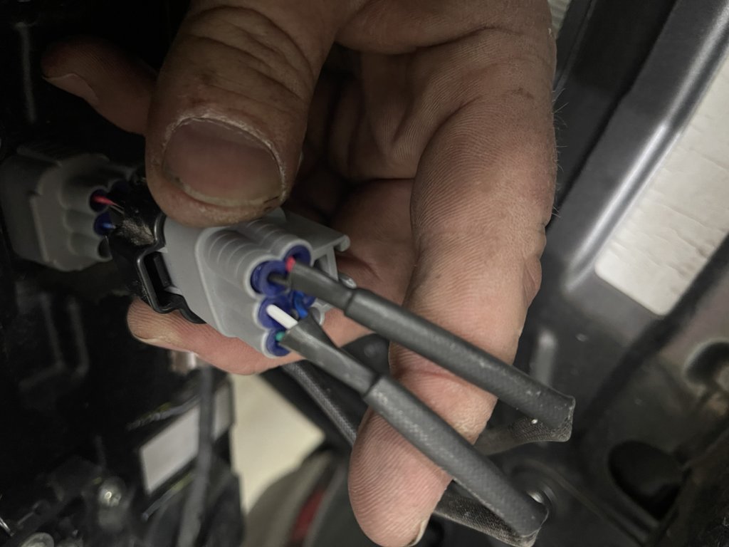

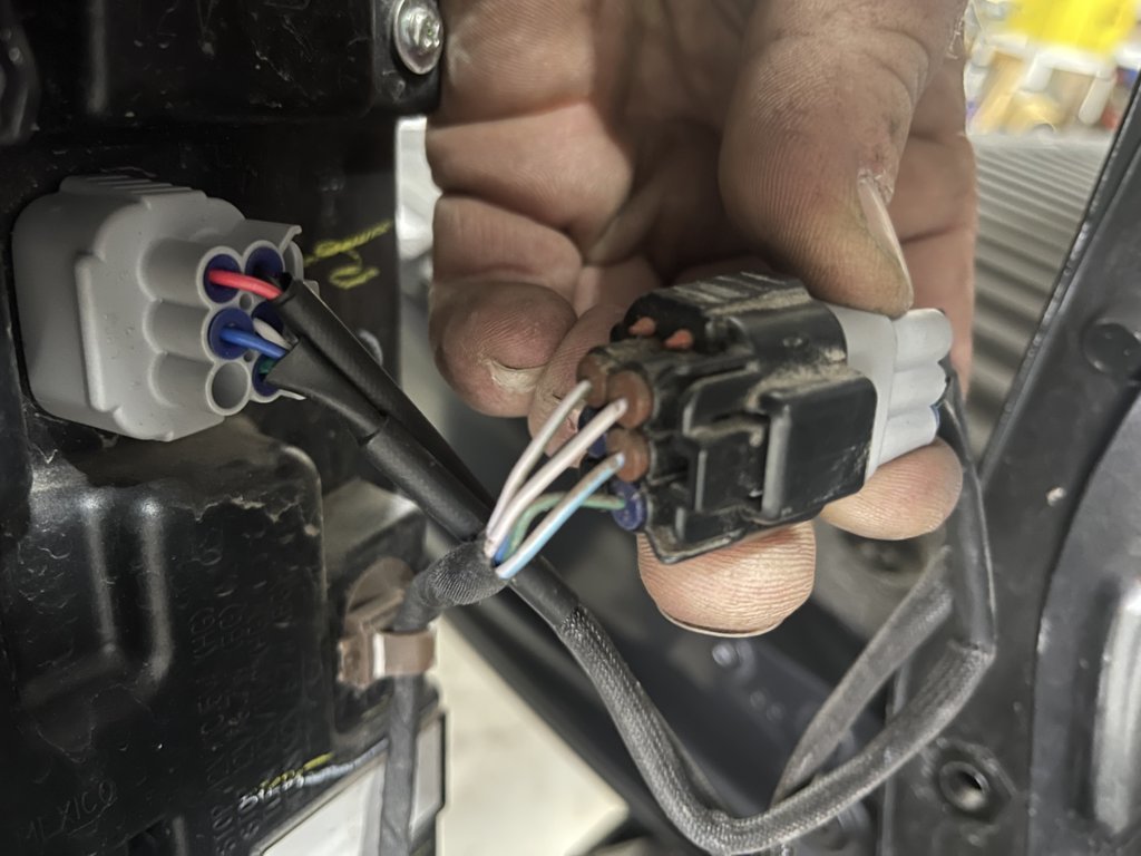

    Hello all. I’ve searched this site under multiple forums to try and find a wiring solution. This is what I have. 2022 SR5 TRD Off-road with non-sequential LED DRL. I found this wiring setup from this company:
    https://www.toyotafreaks.com/produc...-wire-harness-kit?_pos=1&_sid=33d4b9e93&_ss=r
    This kit turns the fender lights on when the parking lights are on.
    The harness comes with a double pigtail (photos attached, I tried my best to get wire colors as well). I plugged the double pigtail into the Rear Passenger Tail light and chased one wire set to the Rear Driver Side. What I changed was how the front fenders were wired. I “T” tapped off the Red and Black wires from this setup from the Right Rear Light and chased two 18 gauge wires lummed up to the front passenger side wires (the front is two wire sets one red and black to front left and a red and black from the front right combined into one tail) I cut the ground ring off the wire as well as the fused wire meant to plug into the fuse box. I crimped with heat shrink waterproof splices. Cleaned up the wires with wire ties from the Rear Driver side counterclockwise to the Driver Front headlight. Hope this helps some of you who are looking to complete these fender flares.
    No change to factory wiring, about 45 minutes laying everything out. Install was 3 beers long.

    Just FYI I have 2024 SR5
    ****Not the premium LED headlights****
    I just tapped into the green wire on the headlights for my TRD Pro grill swap for the amber grill marker lights.
    don’t think you can do this with the Premium LED headlights cause of the CanBus garbage.
    Marker lights come on and off when I turn on the lights or DTRL and do NOT stay on all the time like if I fused into the trailer lights fuse.
    Hope this helps someone.
