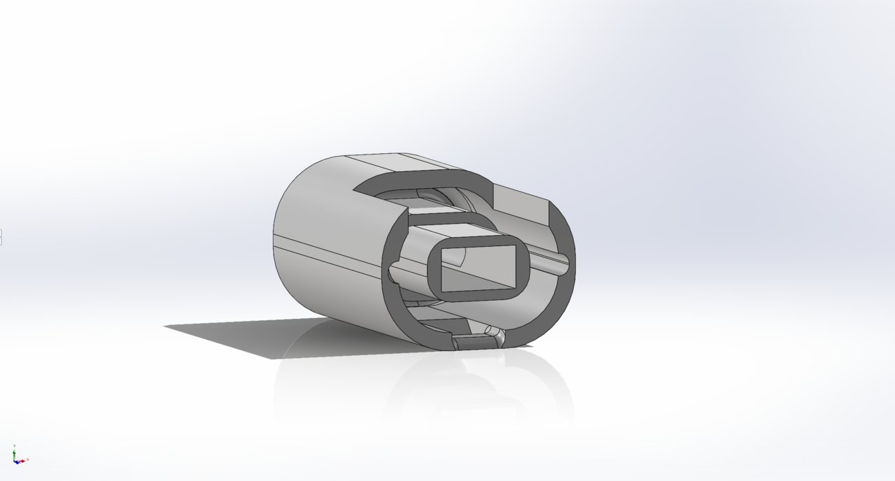

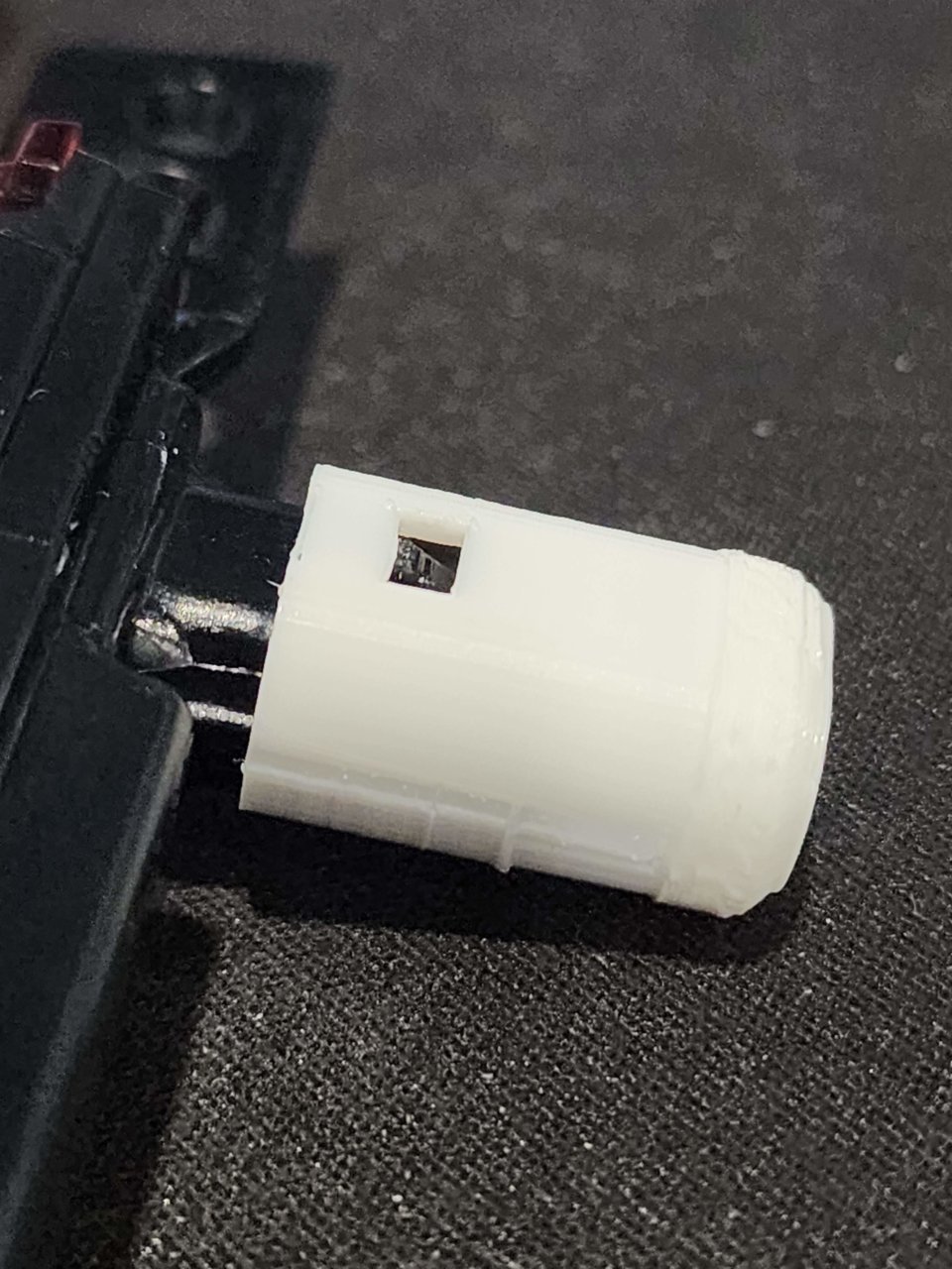

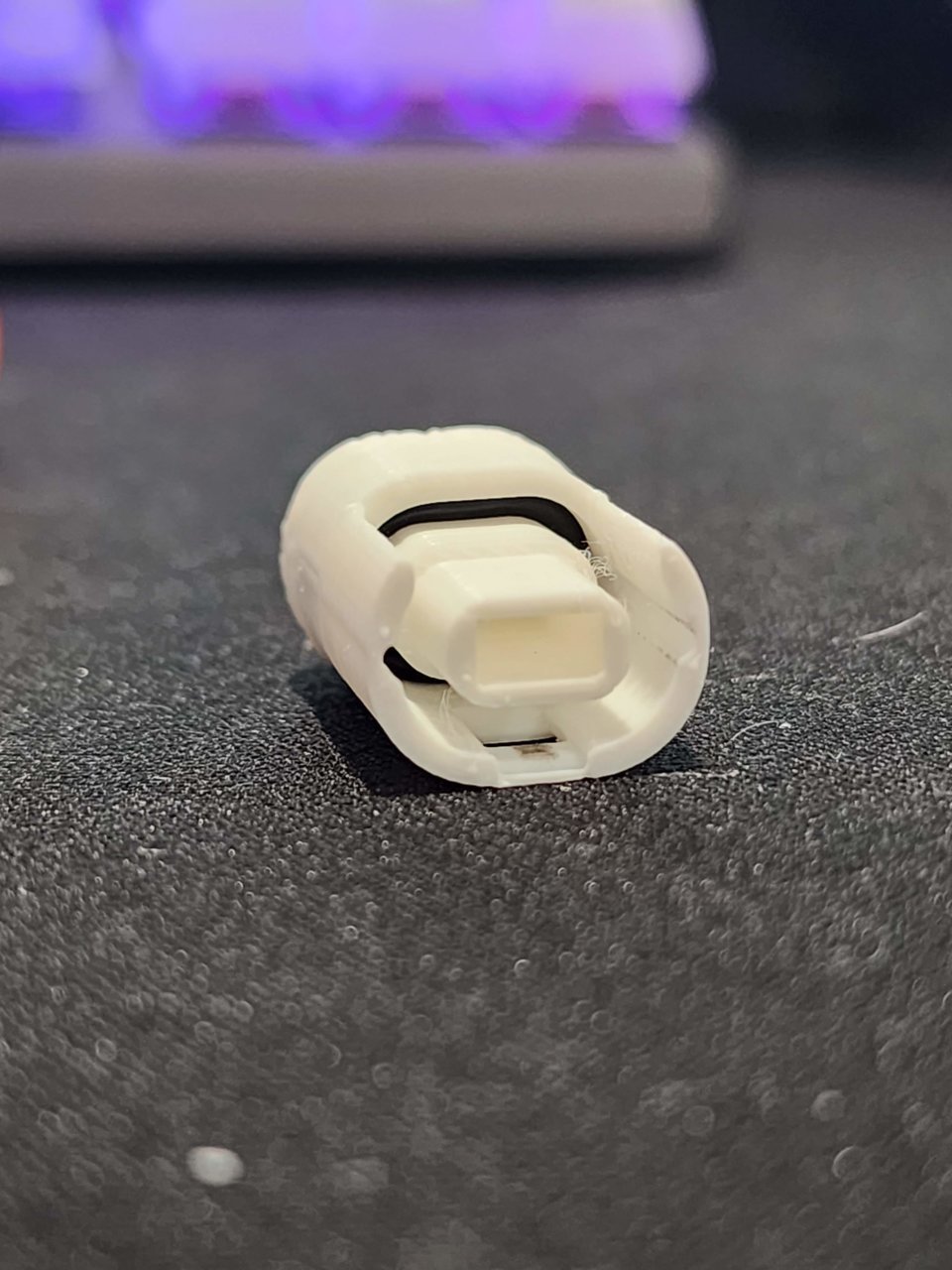

    Any chance you can share the CAD so others can 3d print? thx

    Do you have the .stl for sale to home 3D print or the part itself?

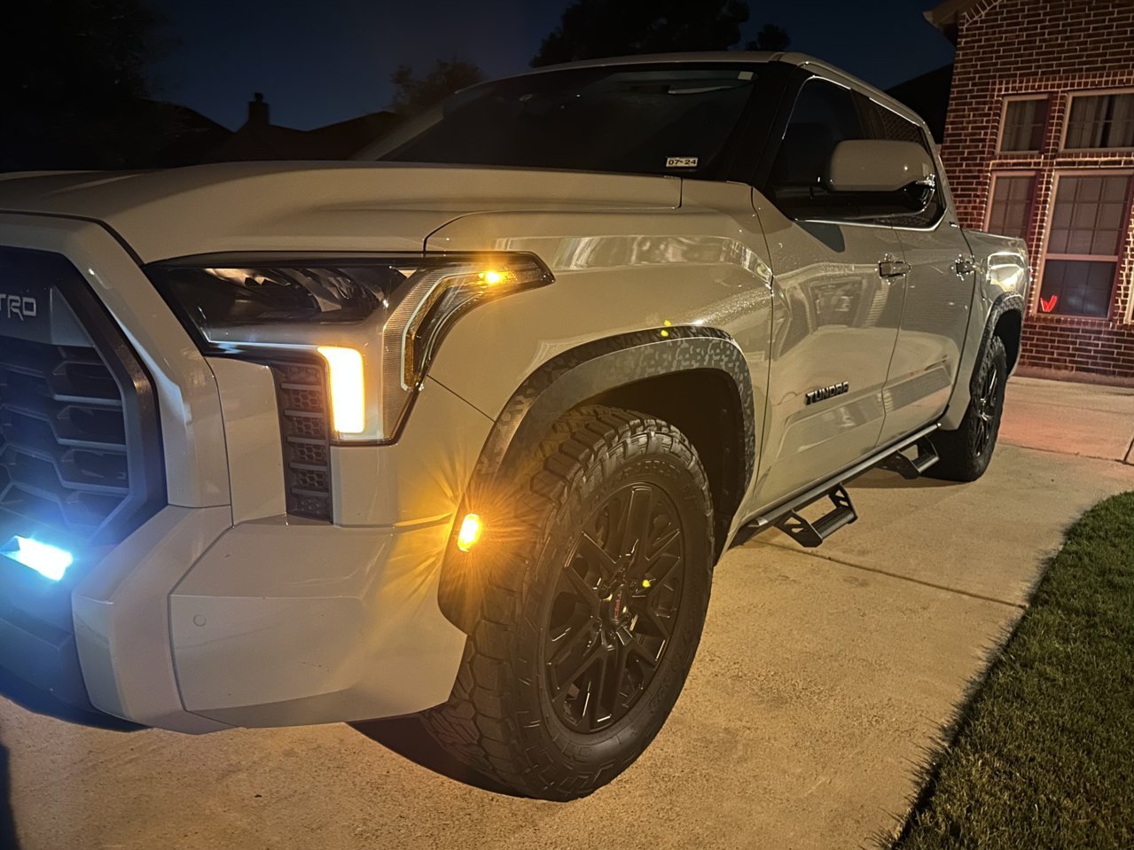

    Any pics from further away? Looks amazing and would love to see this in windchill

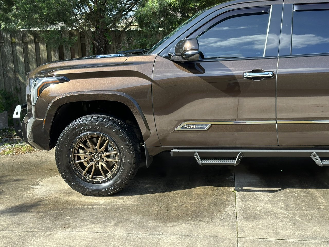

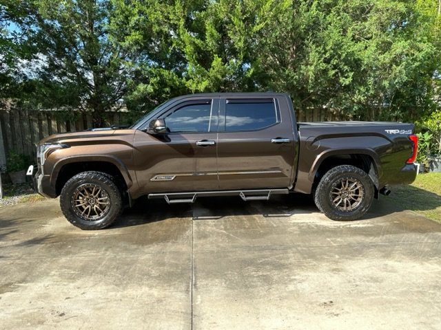

    Fuel Rebel 6 Bronze 20x9 +20 Nitto Recon Grappler LT295/60R20 PRO fender flares color matched and wired Fox suspension from TRD Pro TRD Pro shift knob Grille surround color matched CBI Covert bumper with bull bar Rear bumper arms color matched BakFlip MX4 tonneau cover WeatherTech mats Gloss black window trim TT cat shield Black TRD grille Tufskinz tailgate letters Tufskinz TRD logo and stripes Tufskinz door sill protector Center console safe TWC 5” exhaust tip TWC slip-on exhaust TWC titanium valve stem caps Beat Sonic amp TRD air filters Diode Dynamics amber fog lights Color matched digital camo fog light bezel OEM Dashcam

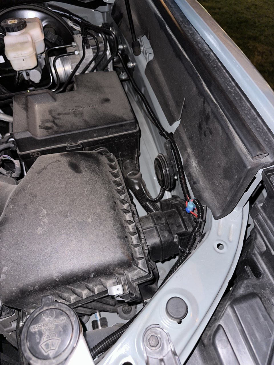

    this is what I was planning on doing. Question, are they on whenever the truck is on, or only when parking lights are on?

    If you tap into the brown on the curt harness. That is the “running lights”. So they are not always on.

    Figured. I’m thinking of running them to the front to an add a fuse. Put the marker lights and grille lights to that.

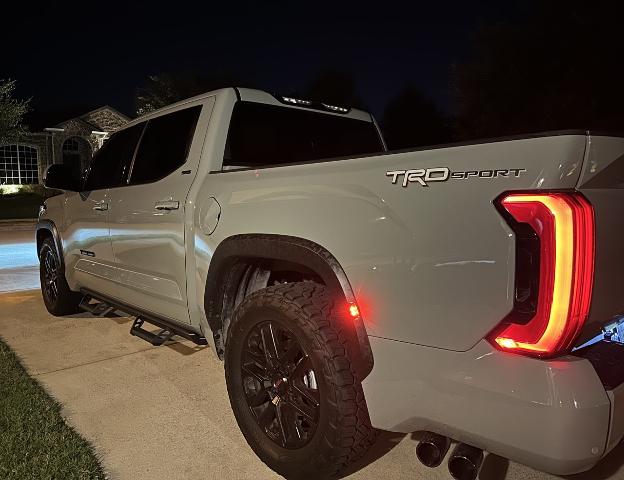

    2022 Toyota Tundra SR5 TRD Sport Lunar Rock
    Any DFW folks not good with their hands, like me, I randomly ran into a guy with a clean Landcruiser (1993 5th Gen) filling up gas. Got to talking and learned that he’s an electrical supervisor at an Off-Road shop locally. Ended up ordering the @trailhunters hookups, and he did the rest. $200 for the labor. Let me know if you’re interested, clean and professional job. Just took pics at night, can take more in the AM if anyone’s interested. Cheers!IMG_5905.jpgIMG_5906.jpg IMG_5910.jpg

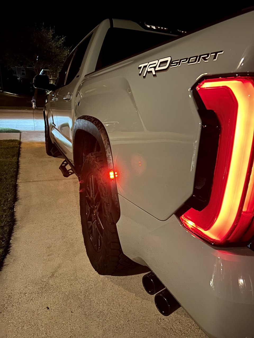

    looks great! where did you get the flairs from? also, are the marker lights on all the time? or only with DRL/headlights
  19. Sep 5, 2023 at 6:25 AM
    #559
    KingAK55
    KingAK55 New Member
    Jun 23, 2022
    #79896
    47
    AK
    They are only on with parking and headlights. Tried to wire them to flash when unlocking/locking, but said there wasn’t a way to do that.
    The flairs I ordered and received a while back from Lewis Toyota in Topeka,KS. Not sure what their inventory is like these days!

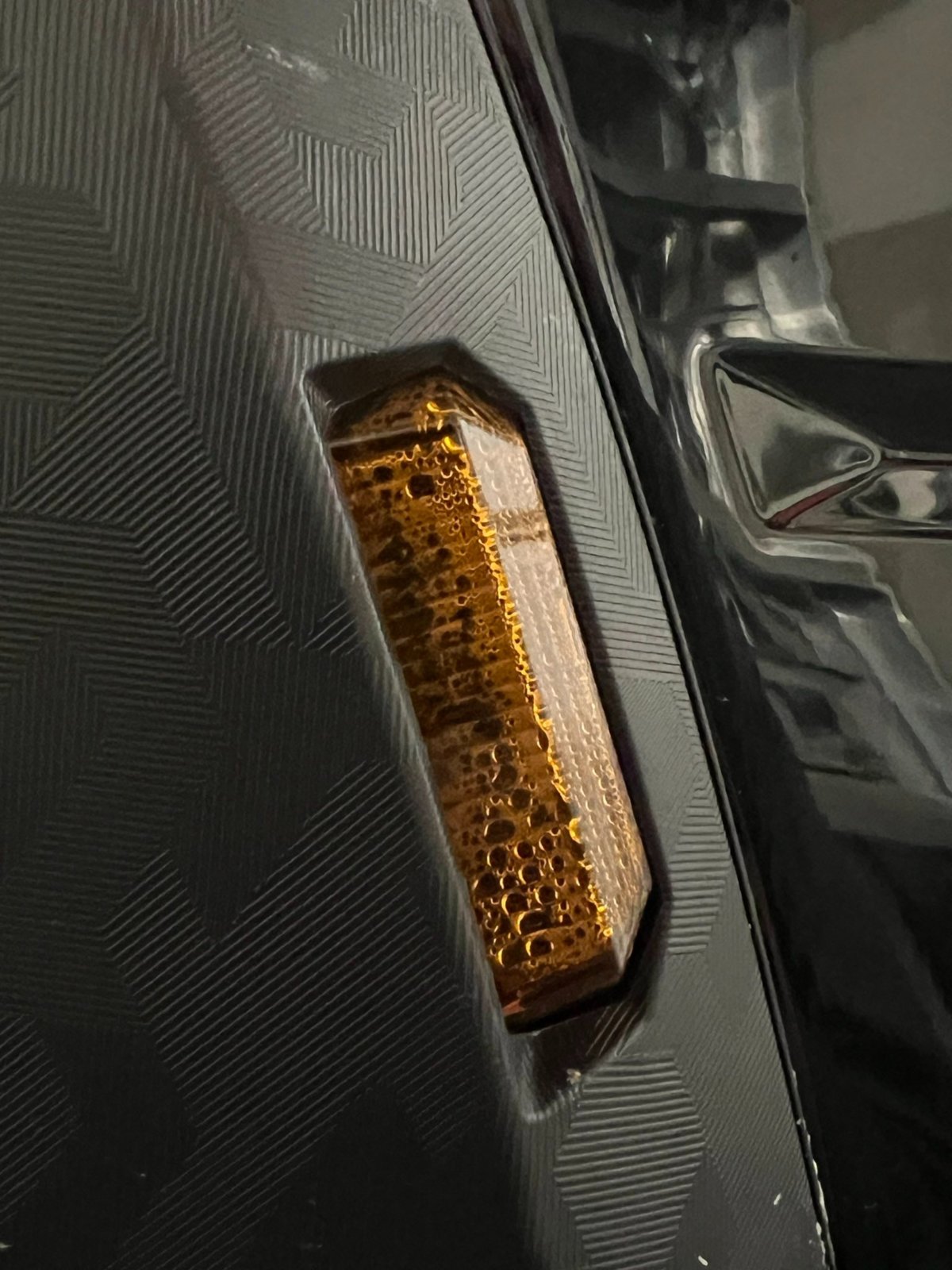

    Alright guys.. I have a leaky marker light :bananadead:
    Passenger side, front. Has anyone else had any issues? I looked over these pretty darn closely during install and they appeared to be fully intact/sealed. Purchased new from the dealer, in unopened nor damaged boxes. Interestingly enough, my truck is stays in the garage most days of the week and rarely sees rain. The truck hasn't been through any low water crossings, etc, so I can only imagine this is simply condensation from rapid changes in temperature and humidity. Scratching my head here...
    I do not believe the marker lights are available on their own, so it looks like I'll be purchasing another front, passenger side fender flair to obtain a replacement.

    Doh! I forgot they are indeed the same light. I'm hoping they're no longer on back order. Thanks for the heads up, Ryan! :cheers:

    Lights weren't on back ordered when I ordered mines on sparks parts a couple weeks ago took about a week to deliver
