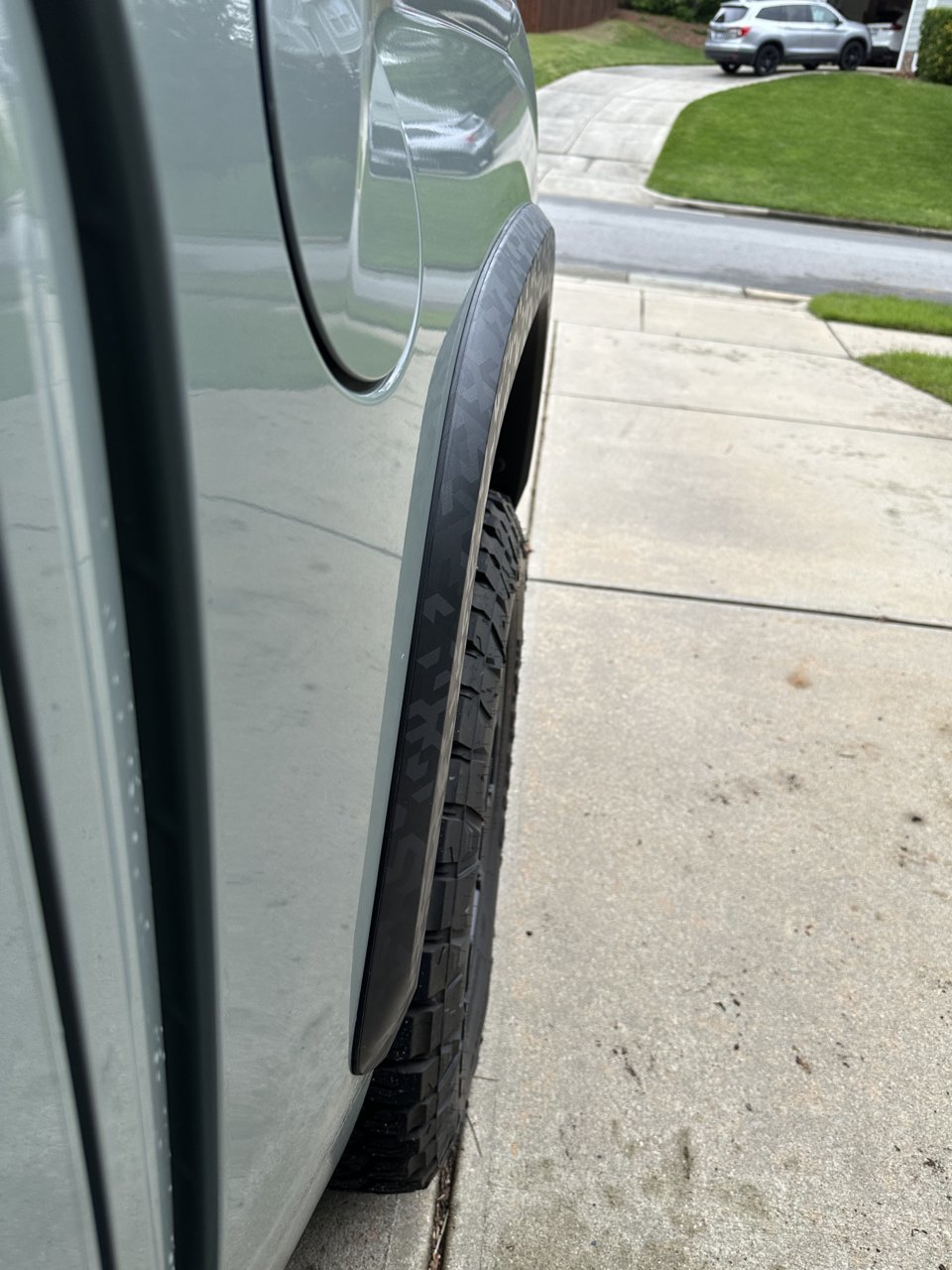

    I have this exact setup. 1" spidertrax fit the pro flares perfectly w 285/65r20 tires

    Thank you jhtram! Your setup looks great! Gives me confidence the 1” is just right. Really glad I placed the order. My spacers were delivered last week and having them installed soon will share pics.

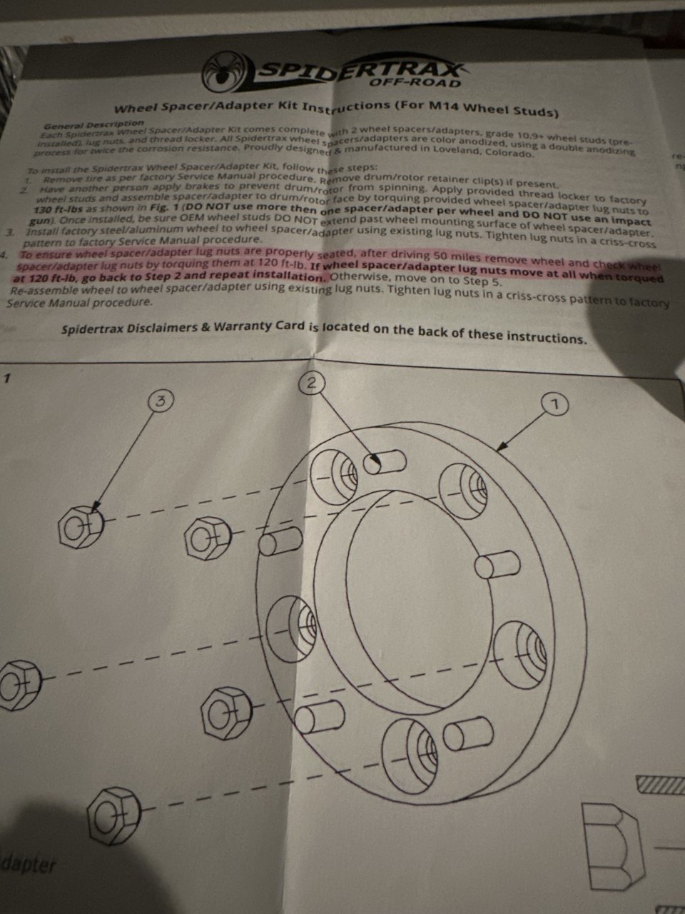

    Thank you jhtram! I called Spidertrax and they also confirmed no alteration to the stock studs should be made. Glad to hear it!

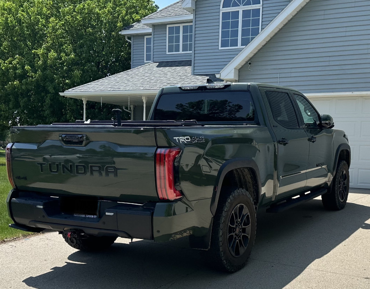

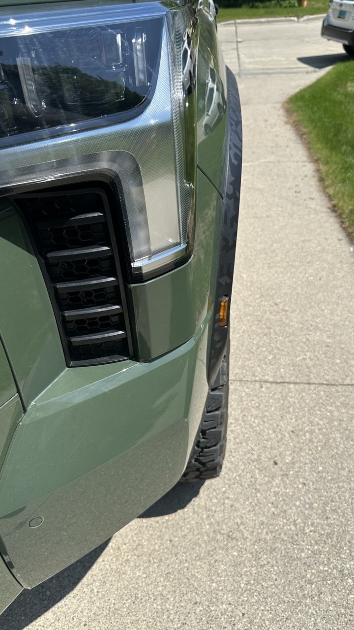

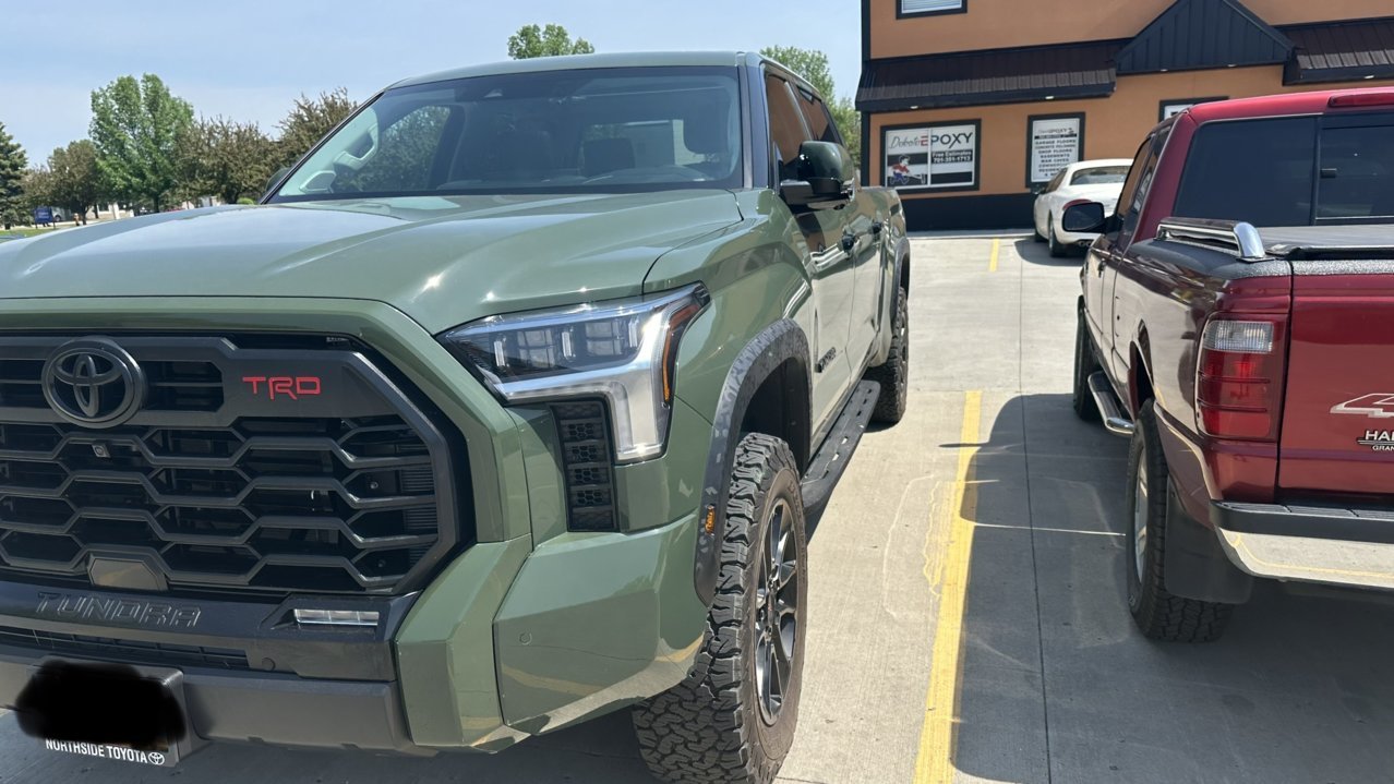

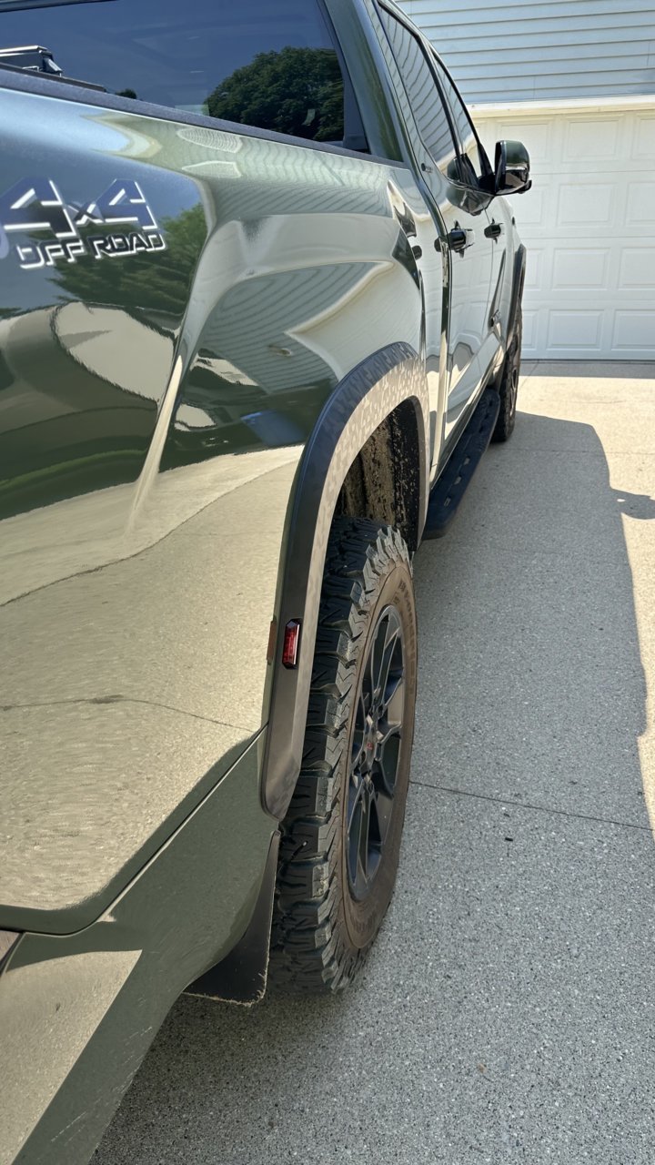

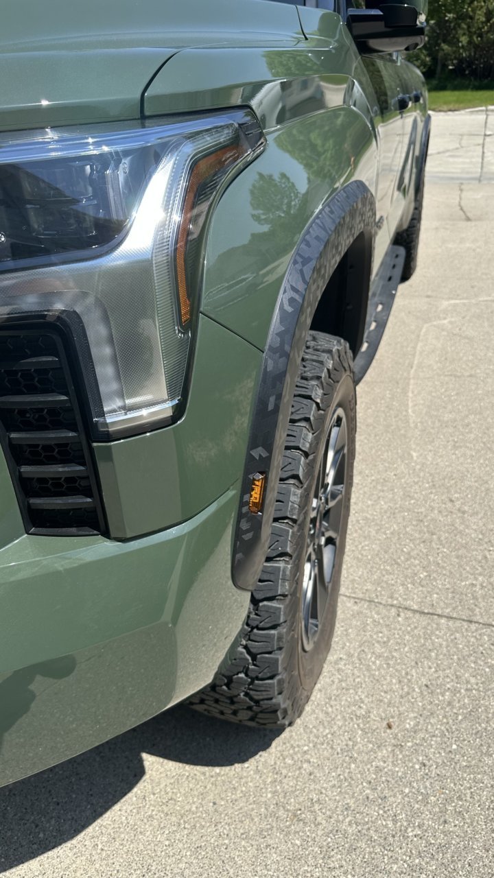

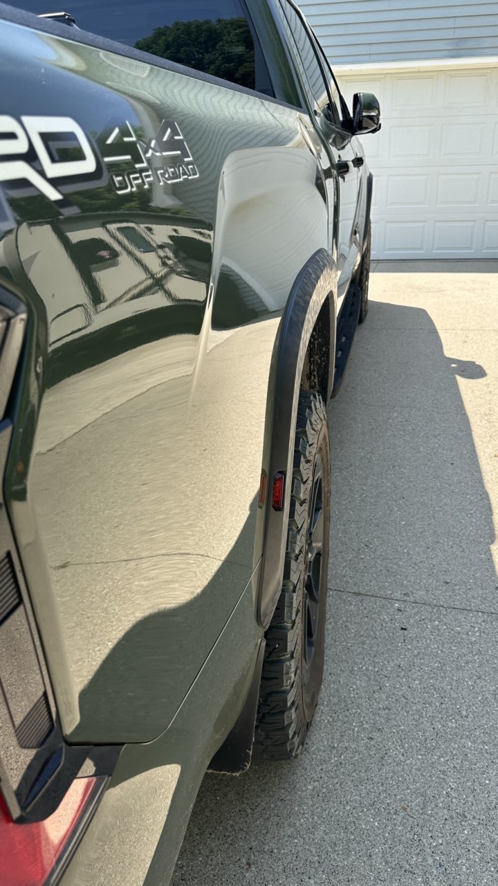

    Just got my truck back. No trimming of studs was required. I LOVE the spacers with the 285/65R20 and the TRD Pro wheel well trim. It totally changes the appearance and stance of the tires/truck. You know some mods give you an immediate feeling of satisfaction and joy? That's what this did for me today! Thank you all for your help. I totally recommend the 1" spacers. I don't think I would want more this is perfect (for me). Subtle and totally BA. A+!

    Looks great Takiowaza!! Did you apply the red loctite?

    Red loctite was used! And torqued to 130 ft-lbs! Will be returning to installers after 50 miles driven, to have the setup tested at 120 ft-lbs.
    If wheel spacer/adapter lug nuts move at all, will repeat installation on those. I do not expect any movement! Super happy with the spacers can’t stop admiring the setup. So good.

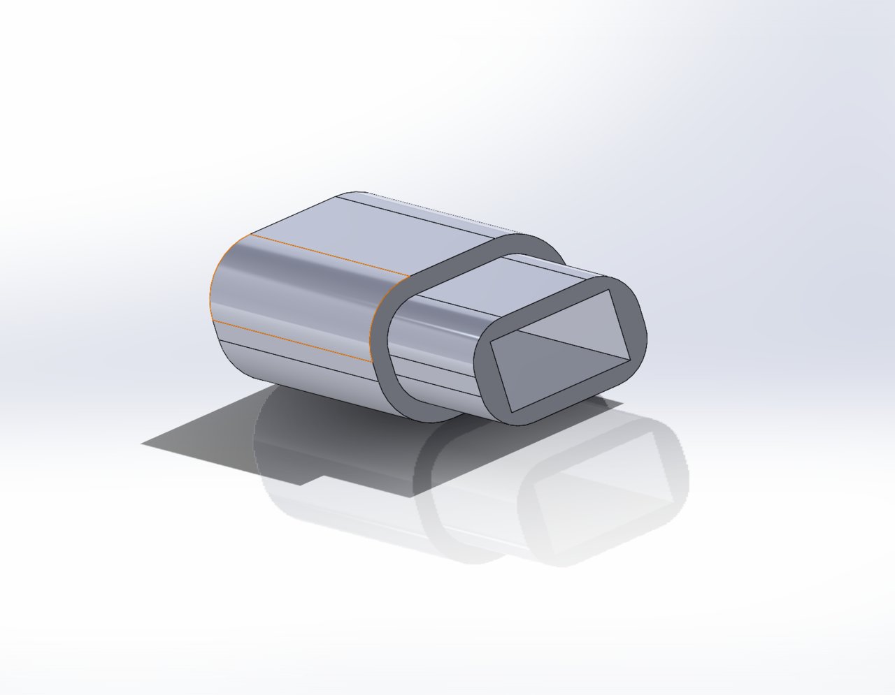

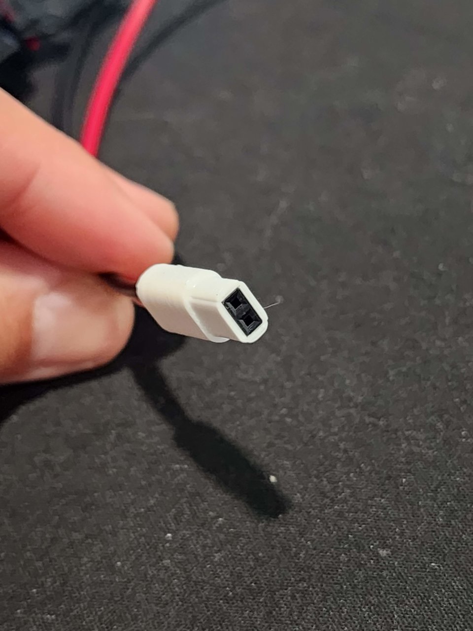

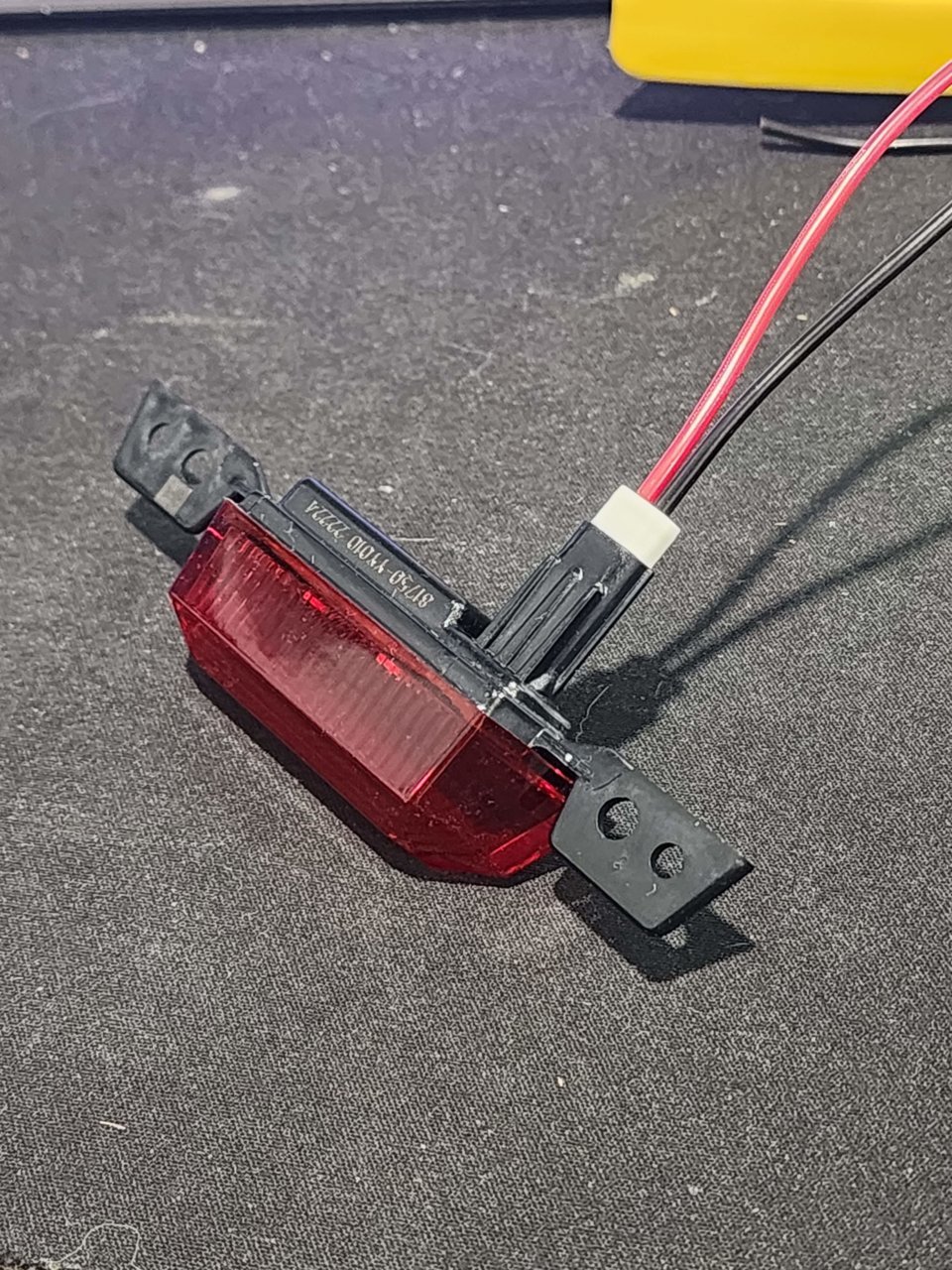

    So I just created a 2-pin dupont connector adapter for the marker LED lighting and it might work? 3D printed with cheap filament for now. Not the best water proof solution but the connector pins are perfect for the LED marker. Only thing is that it is 18 AWG wiring. Not sure how it will do for longer extensions as I plan to run 4 of these up to one 7.5A fuse in the engine bay. I'm not an electrical circuit load genius.
    Anyone think this will be fine to connect my TRD Grille lights + all 4 fender lights (18 AWG) into one 7.5A fuse tap with a 5A fuse?

    Nice work on the connector. To answer your question on the wiring gauge, you will be perfectly fine with 18 AWG. The 5 amp fuse will also work fine (the wire will handle much more than 5 amps). 18 AWG is actually what I used, but only because I ran out of smaller wire and forgot to order more. You will likely be under 1 amp of draw with all 7 lights on the same circuit. I pulled under .2 amps when I did a quick test with the front 5 marker lights on.

    I can see that being a lot of wire but it makes sense to tap the lights at the 4 pin trailer plug. Glad to hear the the RCTA isn't affected which was my concern, it is probably triggered off the trailer brakes like you suspect. I would need a few 100 feet of wire for my land barge!
    Running a fuse tap is probably the easiest approach but offers very little control if you want to be ins stealth mode ;)

    Great work @trailhunters!! If your 3D printer setup works, you could generate harnesses for this application! I and many others would absolutely buy them from you if it could mean plug and play installations for our Trd Pro Wheel Wells! Great work again BTW!!!

    I'll test and see if it works first. If so I'll release the 3D model for free here and could possibly offer a print service if you don't have a printer - just pay for shipping and material. I'll keep you posted.
