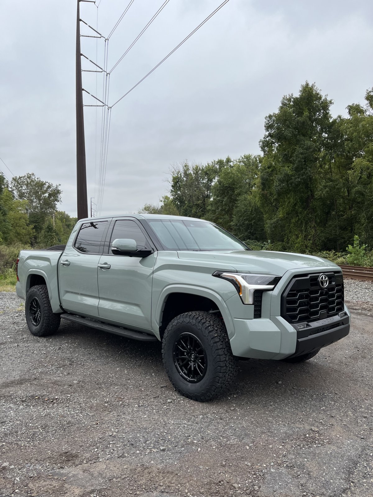

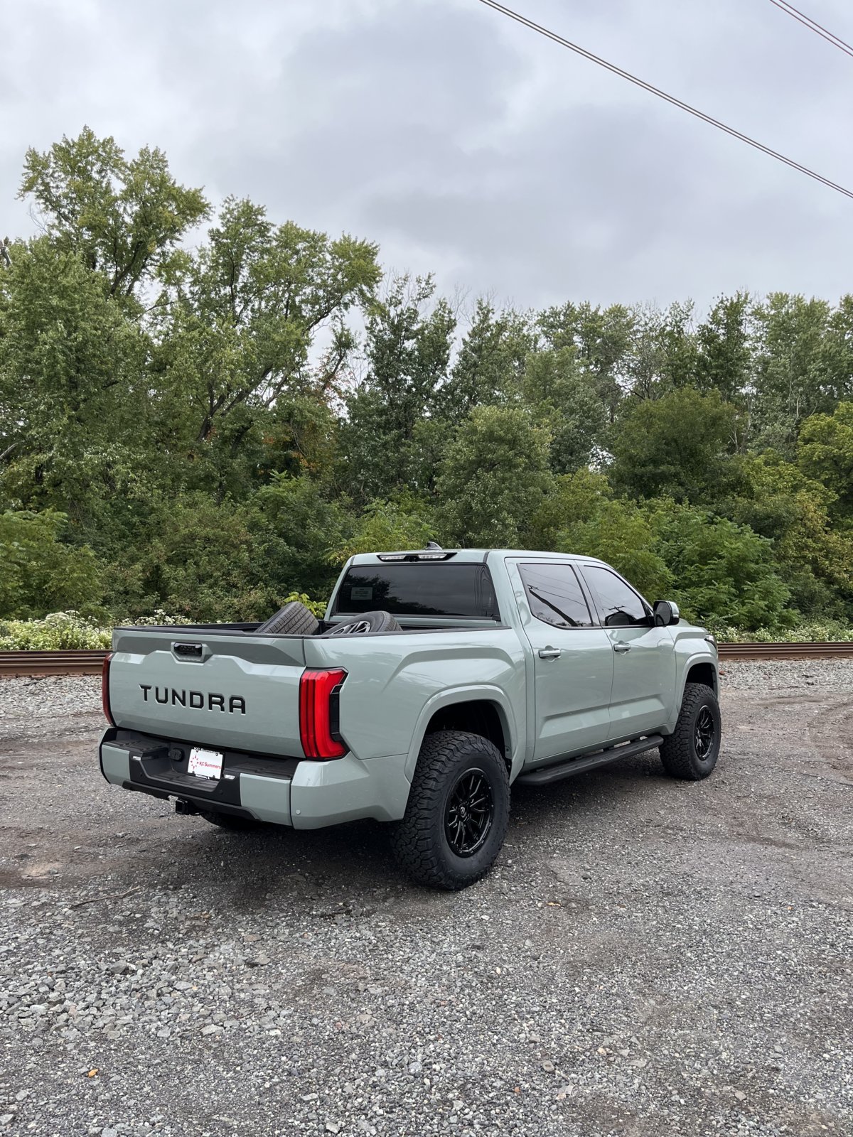

    I lifted my Sport with the TRD 3" Lift. No issues. So many mixed reviews prior if it can be done or not done. Just jumped off the deep end and the dealer did not bat an eye at it. Just kept on rolling and rocked it. Sold the sport wheels and put on 35" BFGs and 18" Fuels. Done and Done.

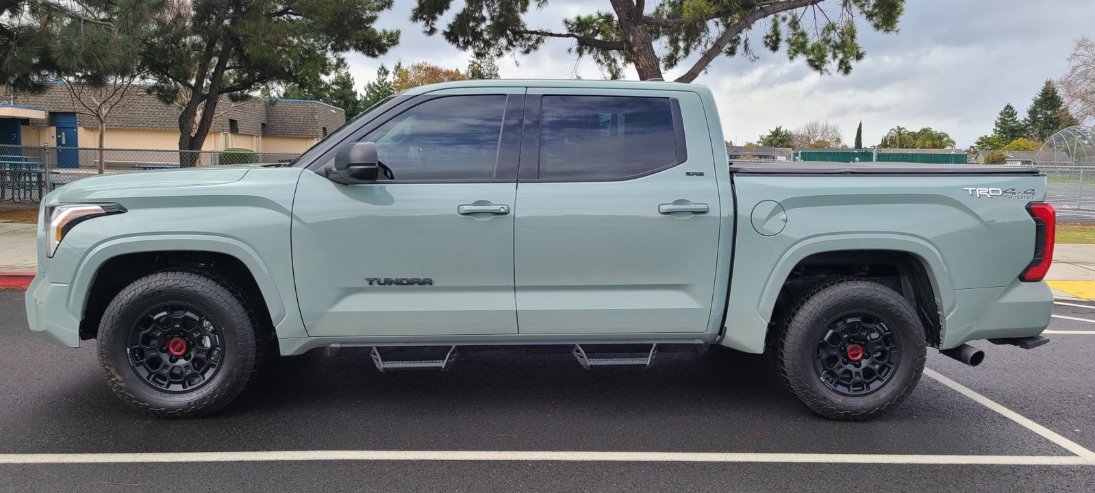

    22 Tundra Crewmax 6.5
    33" Tires, Black Toyota Rims, TRD shocks

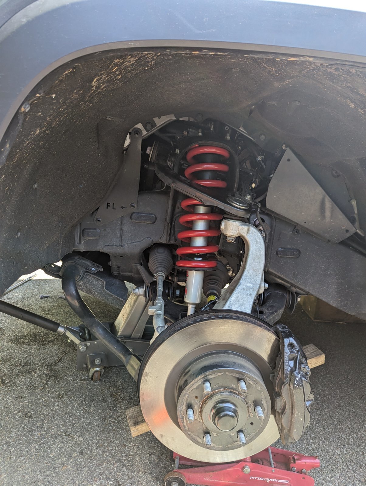

    I just added TRD lift kit shocks, nothing else. Pretty happy with it. Not trying to make it a PRO, also happy to have 6.5' bed and under seat storage.

    I have the same truck but platinum. I see you also have the red springs, so did you also buy the springs with the shocks from the Trd kit? it doesn't look like you have the red axles. so I was just curious on your set up thanks.
  27. Jul 2, 2024 at 12:28 PM
    #57
    2021 work truck
    2021 work truck New Member
    Nov 12, 2020
    #54786
    28
    Steve
    I bought springs on eBay for $60, had powder coated for $80... Used a spring compressor, had alignment done at Toyota dealership. Original axels, no problems since it's less than 2" lift
