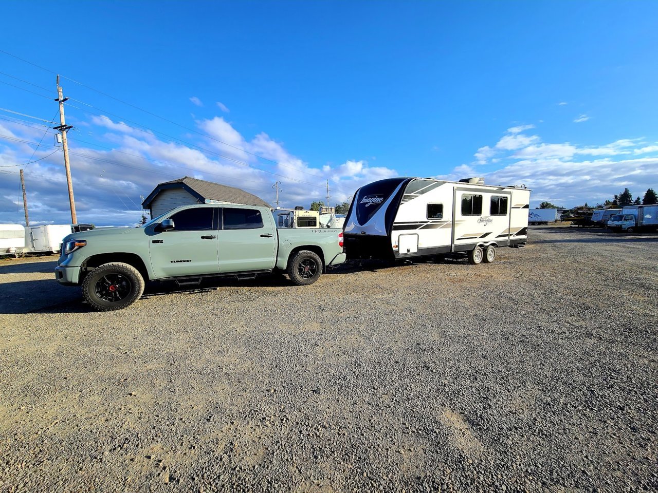

    @Tdalk458 that setup you pictured is almost identical to my setup even similar axle weights when loaded. I put sumos on when i tow and it keeps the back end of the truck perfect. You’ll love some support back there. I find with a trailer that weight the wdh will make it handle poorly with extra tension. Helper springs were far better for this application

    That Hideout travel trailer is a single axle and not very big. Not that much in the bed. Your 2 axle weights add up to 7,800 pounds or 600 pounds over payload. I am amazed that setup weighs that much.
    You have 5 240 lb. Adults in the. An with you?:)

    I have +3 CB shackles in the rear with an E2 WDH. Towed my TT twice with that setup and I had pretty bad sway. Have since installed the rear TRD sway bar and literally all the sway is gone... it's on rails now and I highly recommend it. 30ft TT, 5800lb dry w/ 600lb hitch weight
    Edit: WDH is adjusted for dry.. pic is full of water and generator in the bed

    Also my experience between single axle trailer vs a heavier trailer, the single axle pulls better lighter. I would much rather overload my bed than put more weight in a single axle trailer. They get a little bouncy feeling

    I definitely do not condone overloading but everything felt perfectly fine and safe. When my dad was driving on the freeway, a car about 150’ or so in front of him slammed on their brakes so he had to do the same. It was definitely a pucker moment but the truck stopped with plenty of room to spare.
    I just remembered I had my entire tool bag in the bed, which probably weighs 40 lbs. Our generator is a beast, Honda EU3000. It weighs almost 140 lbs so we could probably get a smaller one. We needed it for construction but don’t do that any longer.
    With the other unneeded items, I could probably get the weight down another 200-300 lbs at least.
    Thanks all for the feedback!
