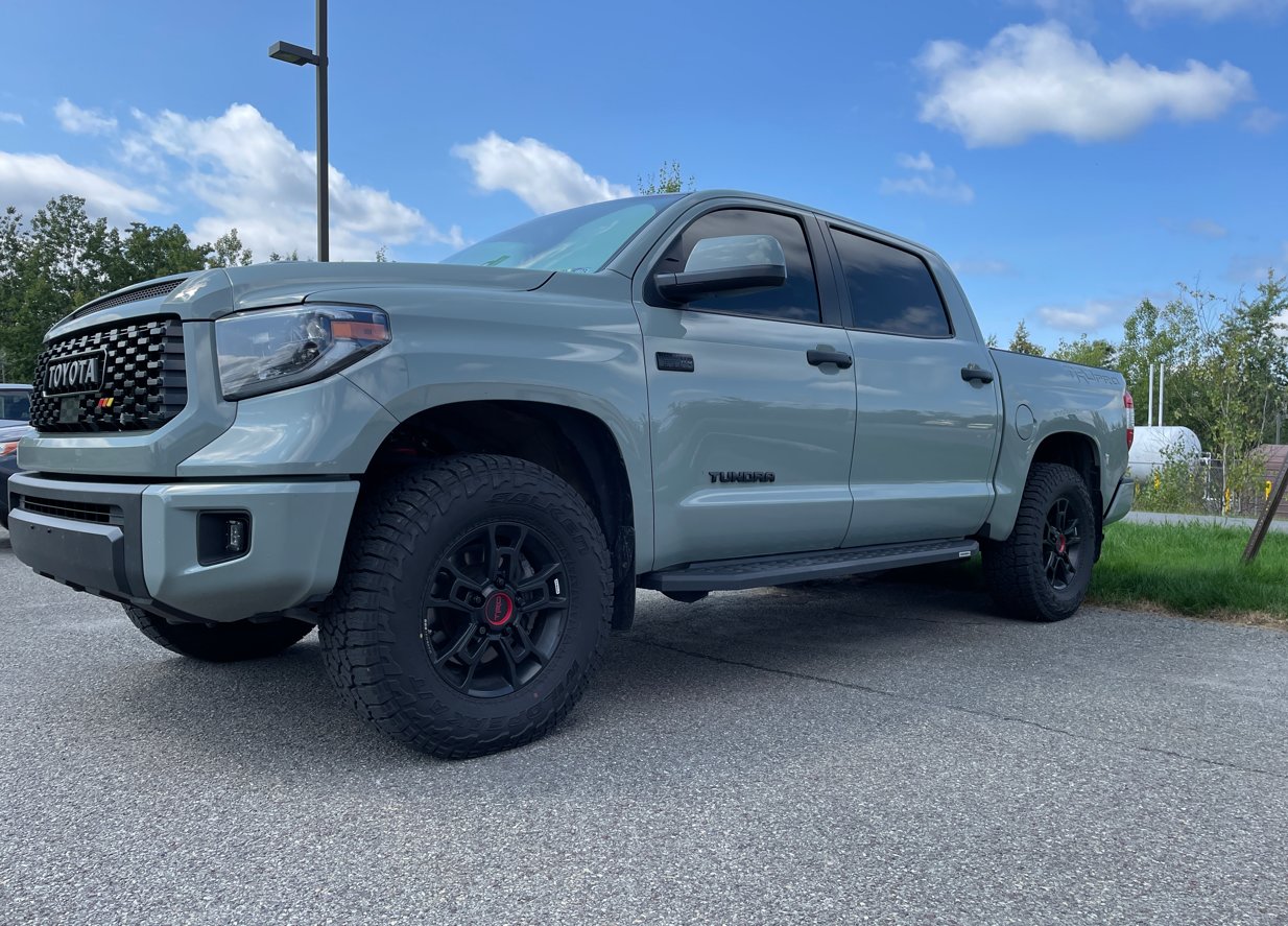

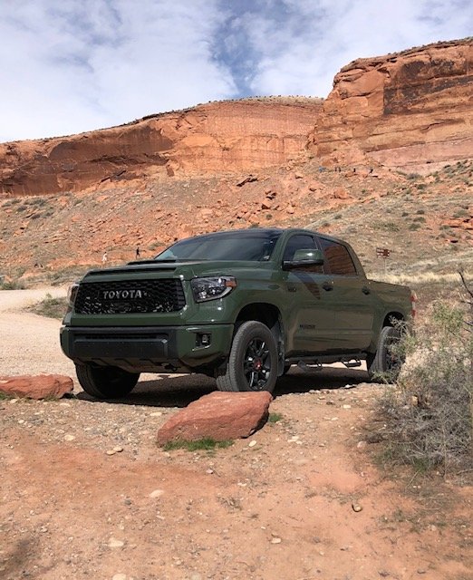

    The dealership where I bought my tundra put on some of the cheapest LT tires you can buy, looking to upgrade. With 295/70r18 being the biggest tire you can put on a TRD Pro suspension, I see a lot of people going with the Ridge Grapplers. I've seen KO2's, Wildpeaks and Coopers, but what about the Kumho Road Venture AT52. At only $299 a tire, 3 peak snow rated and one of the lightest 295 tires at 62lbs, I'm surprised I don't see anyone wearing these.
    Pretty sure the majority of people are on-road 80-90% of the time and off-roading here and there, this tire sounds perfect and has the ability to off-road well.
    If anyone has these please let me know and show some pics!
