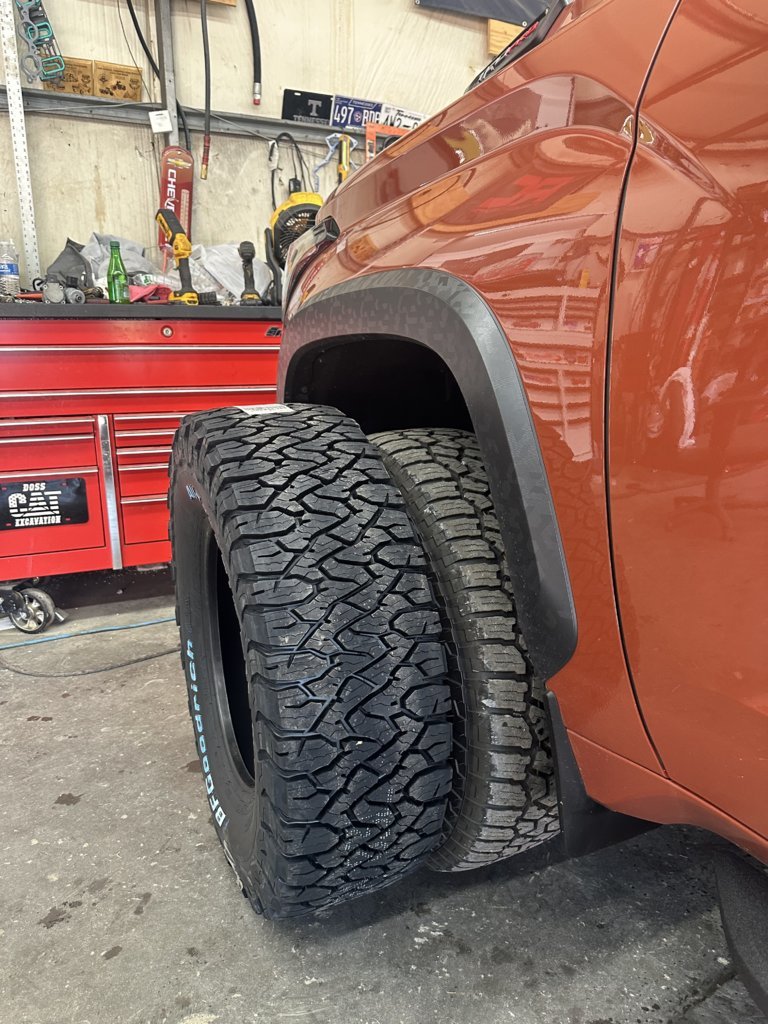

    These are KO2’s. I don’t think the 3’s were even out yet when I got these last yr.

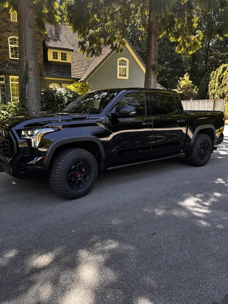

    Hello - new to the chat and member as well. I'm replacing the stock Falken AT3W's with Falken AT4W's in the 295/70/R18. Won't be doing any mods' to the truck as well - hopefully all works out....from what I've read here and researched - should be ok.

    Youll be fine. Truck may feel a little more sluggish due to rotational weight

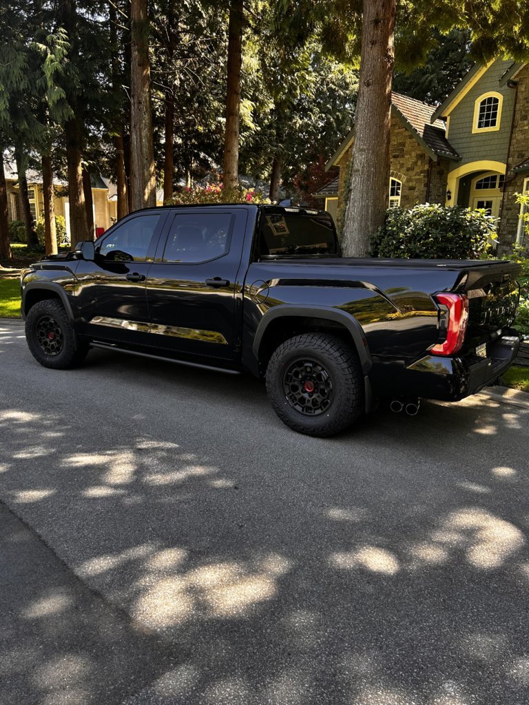

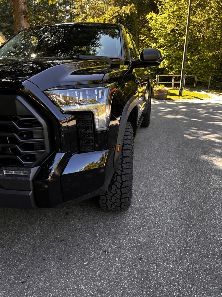

    Just had the Falken AT4W's (295/70/R18's) installed along with an alignment. No issues at all. Very happy with the end result. Not only does this tire look better, the overall ride quality has also improved vs the stock. Great upgrade and would recommend, should you choose to not do a suspension lift.
    Toyota should've went with a 35" tire from the get go. Suits and fits the truck much more so. The pictures here don't give it justice but it really is a noticeable difference when you see it.

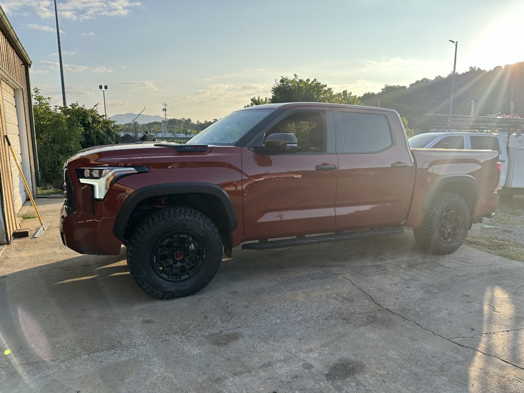

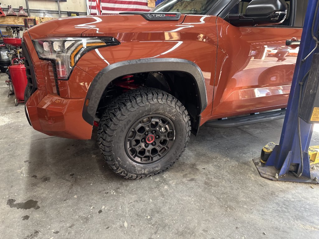

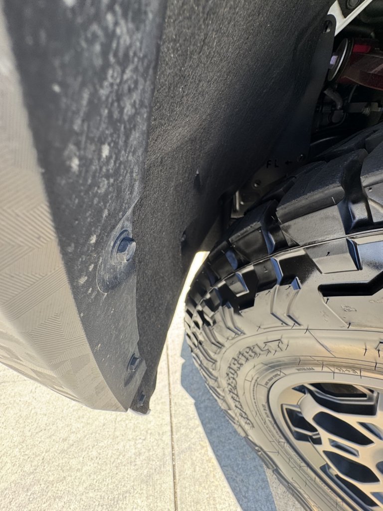

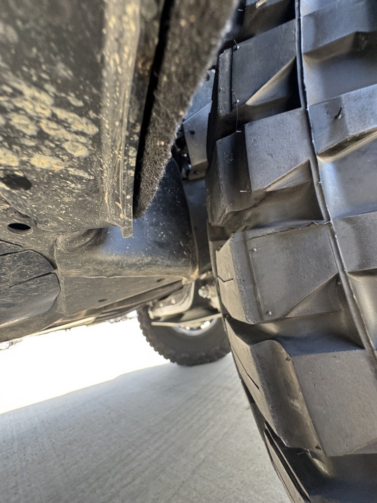

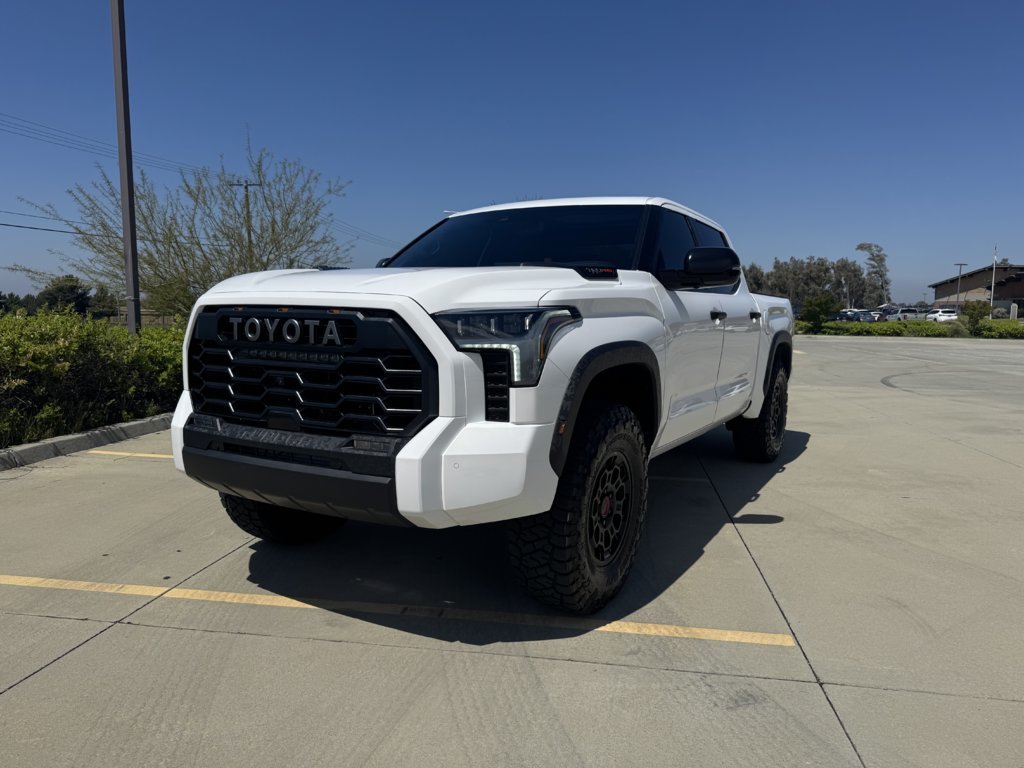

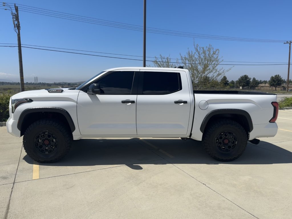

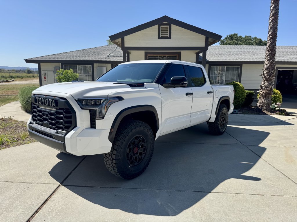

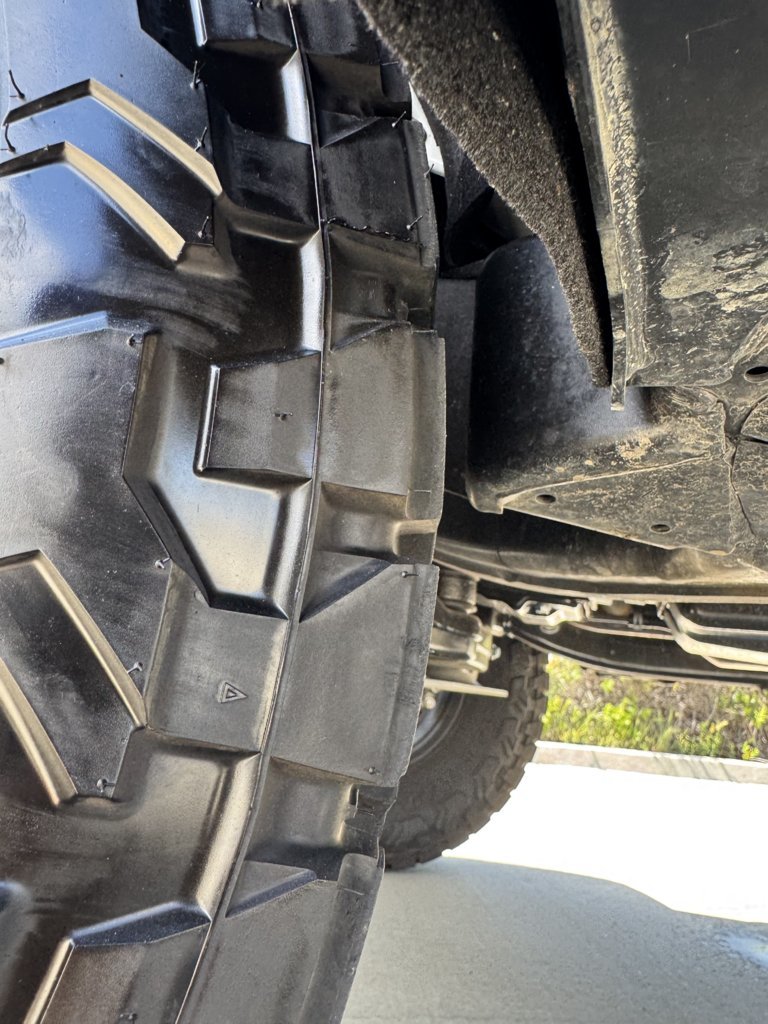

    TRD Performance Package Westcott Designs front preload collar with top shim installed by dealer covered under extended warranty. Stock rear height with slight inside liner shaving. 37x12.5r18 Toyo Open Country RT trail tires. Front liner bracket removal with liner pinned back. No fender liner trimming in front. No rubbing in front on liner or body mount with dealer alignment. No body mount chop due to voiding warranty per my dealer.
    Westcott front kit only. Ride is great. Front is 1/2” higher than rear both sides. No rubbing up front with bracket removal and liner pinned back. Toyota dealer did lift and alignment so it’s covered by my extended warranty. No frame chop, would void warranty according to dealer. No front liner cutting. Shaved inner rear liner slightly. 37” RT trails. Couldn’t be happier with how it turned out.

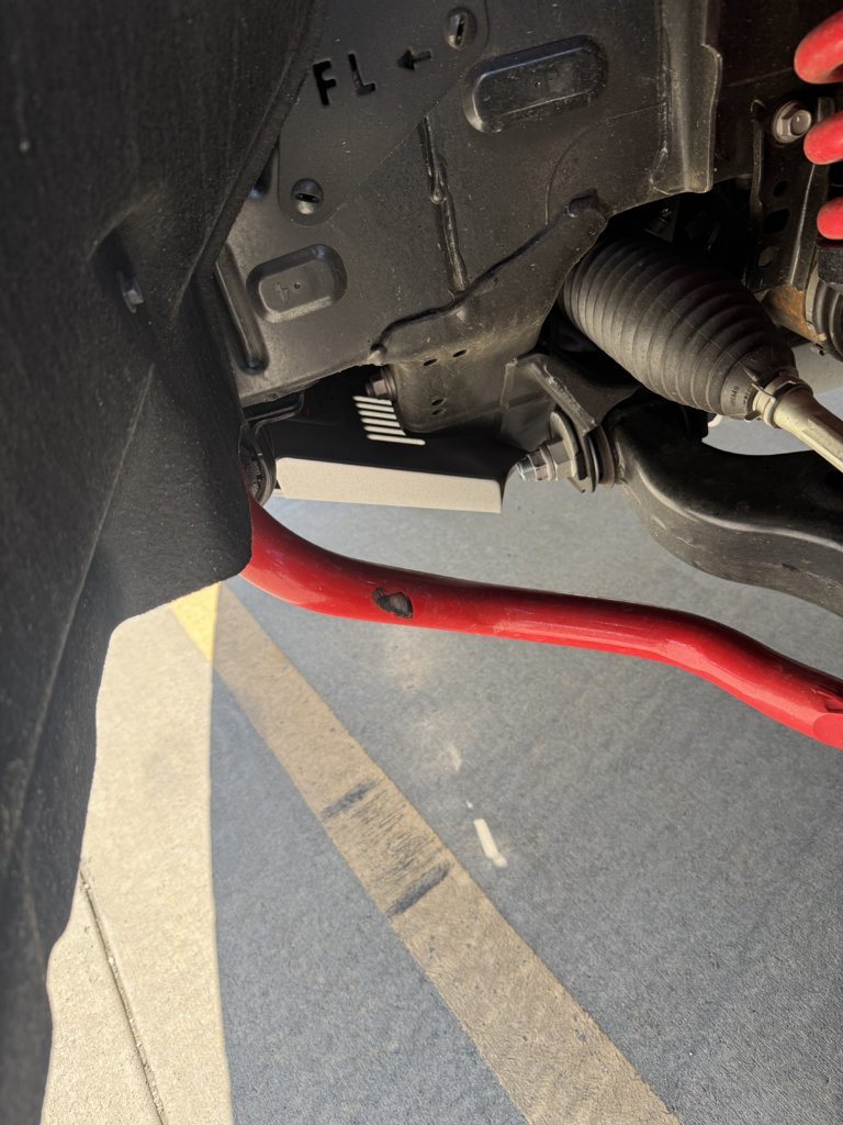

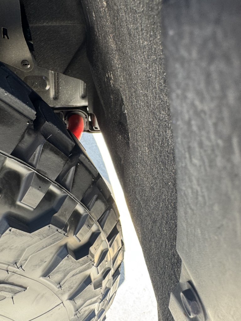

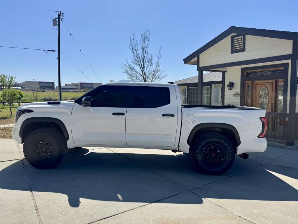

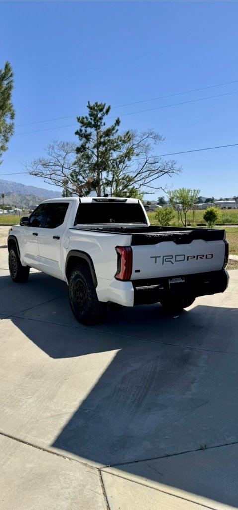

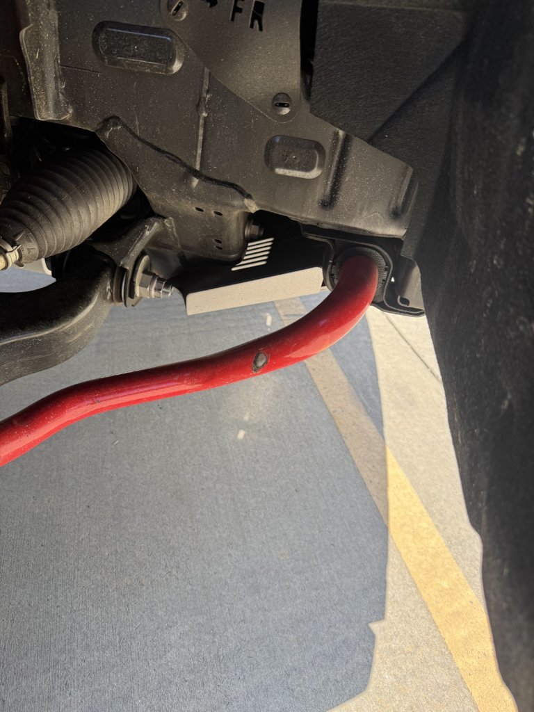

    IMG_0593.jpg IMG_0592.jpg IMG_0595.jpg IMG_0598.jpg IMG_0599.jpg IMG_0597.jpg IMG_0601.jpg IMG_0600.jpg
    Did rub slightly on sway bar when my tires were aired down to 30psi. Running at 40psi doesn’t rub. BFG just released AT ko3’s in 37x12.5r18. Would be a good option for slightly more clearance since they’re a half inch smaller.
