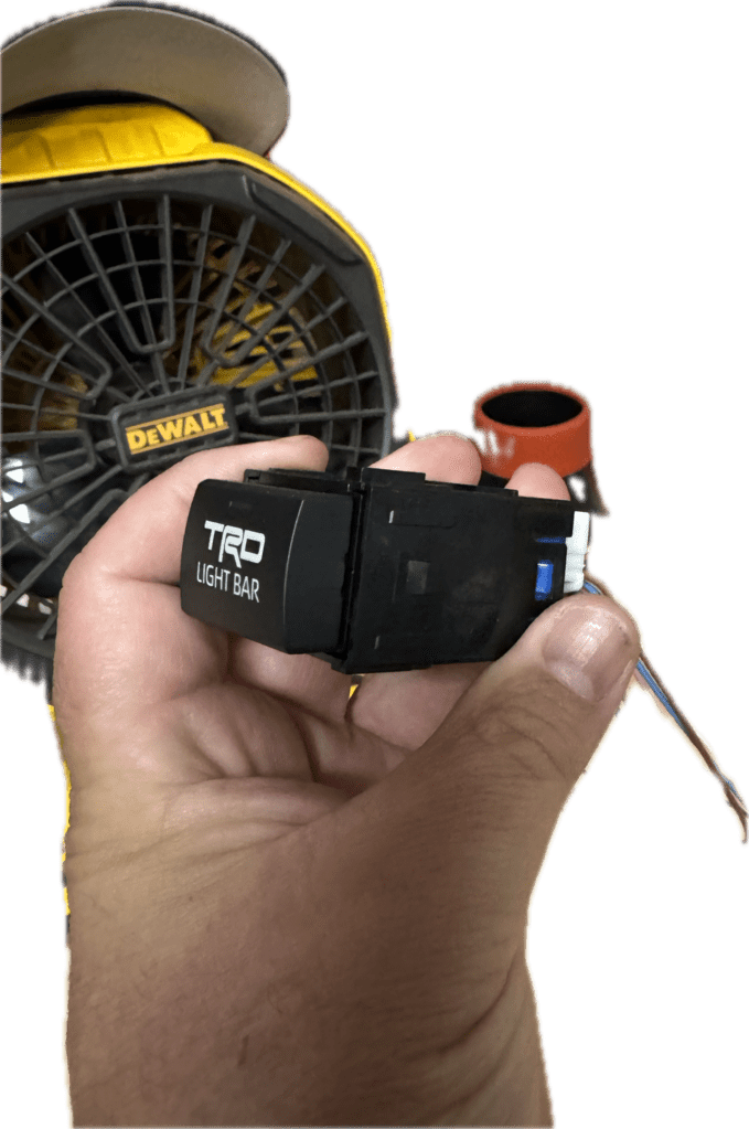

    To make the backlight illumination of the Light Bar switch dimmable (based on cycling the 'Instrument Panel Light Control Switch'), the following change needs to be done to the wiring diagram uploaded by @KClav:
    From the above-mentioned wiring diagram of the Light Bar switch (PT45A-34220-AA), connect PIN 7 (ILLUMINATION -) to the ILL- wire of any of the factory OEM switches mentioned in this thread below:
    I joined PIN 7 of the Light Bar switch in my Sequoia to the ILL- wire connected to PIN 1 of the existing factory 'Auto High Beam Switch' and now the backlight of the Light Bar switch dims perfectly when cycling the 'Instrument Panel Light Control Switch'.

    I realize this post is a bit old but I was able to figure this out on my Tundra. It appears that the dimming functionality is controlled by a potentiometer on the ground side of the circuit through the use of a floating ground. The voltage coming in on the + side is always 12v. The 'ground' side increases from 0v - 12v as the dimming increases (thus creating less of a differential between + and - and forcing a lower electricity voltage across the light. Therefore, if you want the dimming to work, you must tap into the purple (or whatever color it is for the switch you're tapping into) and use that as your new switch's backlight 'ground'. You can use any +12V for the positive on the backlight.
    I tested this today and it works.
