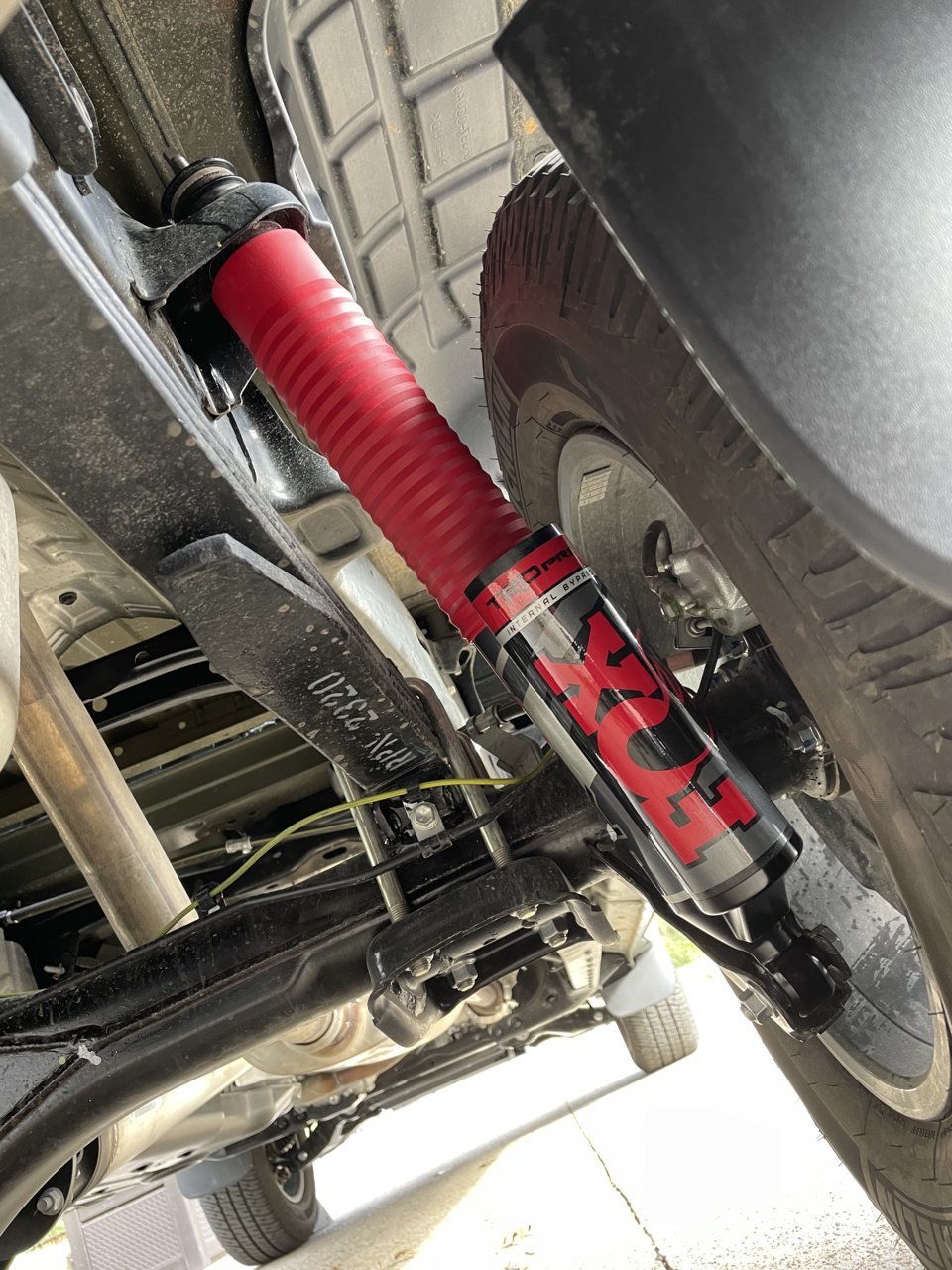

    Both of the rubber boots on my rear Pros have fallen down. Did you see this problem on yours? Can you give me details about how/where you installed the boot? It's super easy and I followed the TRD instructions and didn't install the lowest retainer washer under the lowest cushion (and on top of the boot), but evidently this is causing a problem or got a bad set of boots (very unlikely).
    Thanks.

    Hmm. I just installed the shocks with the boots already on them. Never messed with the boots. They’re staying up just fine.
    Badknees[QUOTED][OP] likes this.

    I can see from your photo that the lower retainer washer below the lowest cushion is installed as it was on the stock shocks. The TRD instructions say to delete this washer and I think that's causing my problems. The lower rubber cushion is moving/squeezing the shock boot off of it's molded/mounting washer, whereas having a retainer washer would isolate the top of the shock boot from the rubber cushion and probably prevent this from happening. Thanks again.

    Ah, I see. My kit didn’t come with instructions. Maybe that was another thing Sparks screwed up for me when they shipped it. I didn’t know I was supposed to leave that washer off. I just installed the TRD Fox the same way my Off Road Bilsteins were installed. So far, no problems! :notsure:

    I think the instructions are off and you installed correctly. It could be changes in the FOX suspension designs since they were first printed. I also noticed they state to re-use the stock sleeve, which is ridiculous since it won't even fit the FOX shock. I didn't get these instructions with my TRD stuff either and found on the internet.
