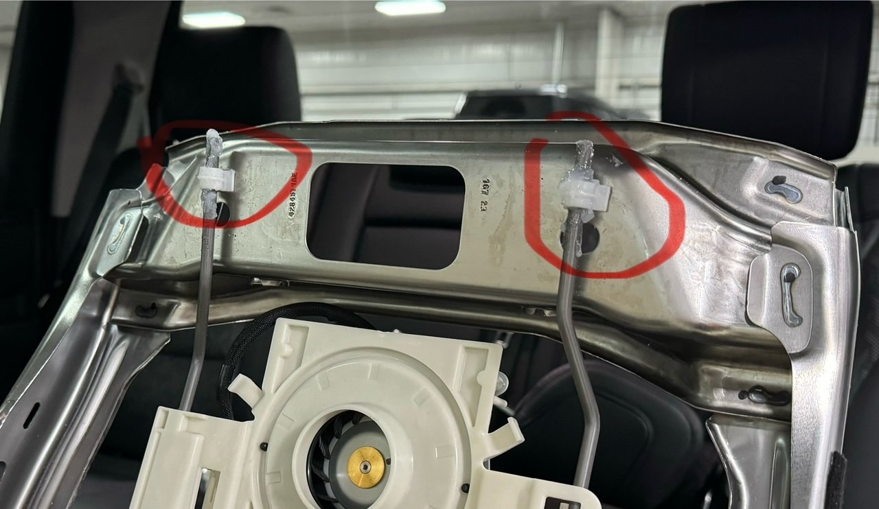

    I took my Tundra to the local dealer today. The shop foreman is awesome. He said they had seen a few of the early (2022) Tundra's with this issue and had to replace the seat. He called Toyota corporate and the instructions they gave him was to use heavy silicon grease on the clips that hold the rods for the seat fan. The rods move through the clips as the seat is reclined. Fingers crossed but so far, this has solved the problem for me. We will see if it holds up.

    See above for the fix. They originally put extra padding and it came back in a few days. They had a corporate engineer look and this is what they decided to do.

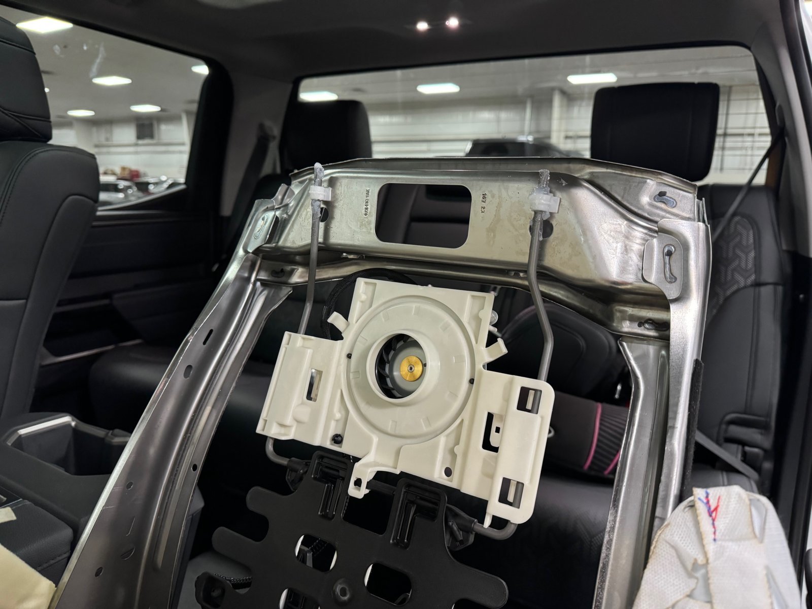

    Any idea how they got the seat down to the metal in these pictures? It appears they left the seat in the truck, so I can’t imagine it’s real hard to get it to that point? Any schematics or steps how to remove leather, foam, etc?

    The seat cover unzips from the backseat. There are also elastic straps under the seat that needs to be unhooked. Its pretty easy, but I took mine to my dealer anyway in case the seat needed replacement.

    I have been fighting this seat noise in my 2023 Tundra. I unzipped the back of my seat, unhooked the straps at the bottom and flipped the leather over toward the front. I was able to reach in and get to the clips referenced in @Philcam's post. I lubricated they heavily with silicon grease. IT WORKED!!! The noise is gone. I put enough on there that it hopefully will not come back. I will post if it does.
    If you do try to do this yourself, wear gloves. There is a very sharp corner on the seat frame that got me twice. I ended up wearing 9mil gloves and putting a piece of electrical tape over the sharp corner.
