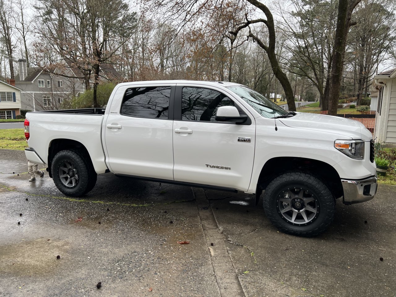

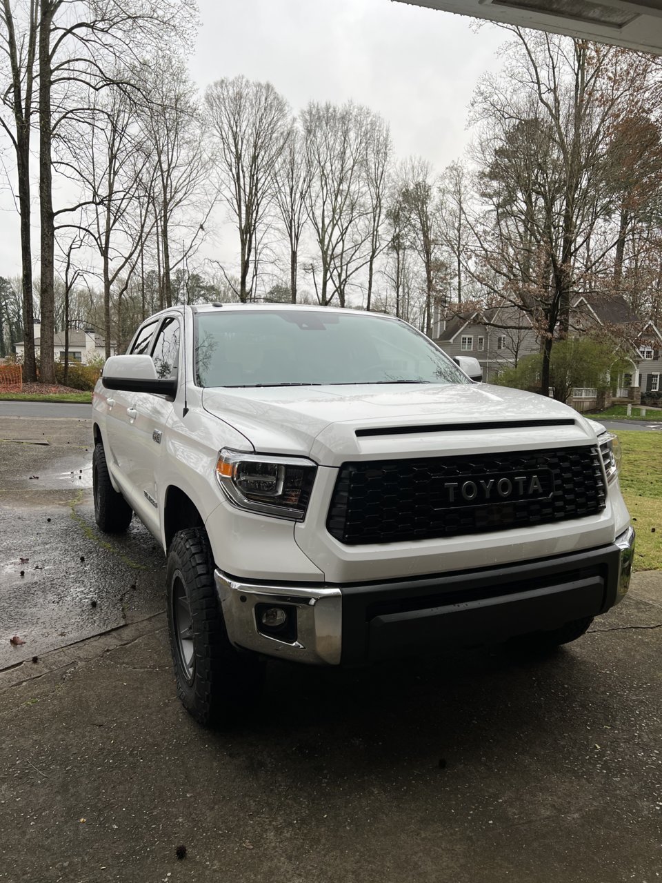

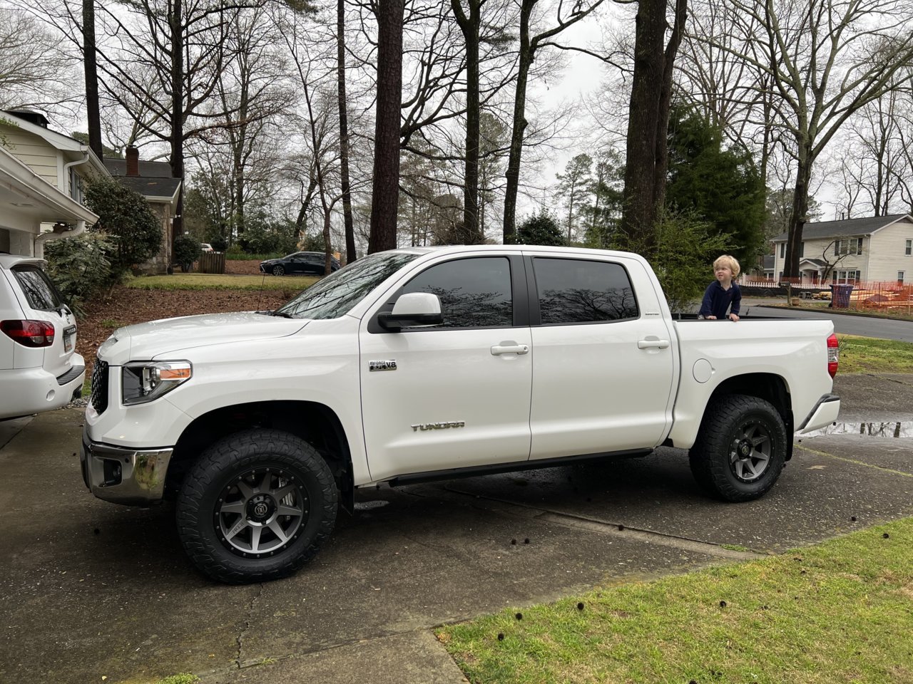

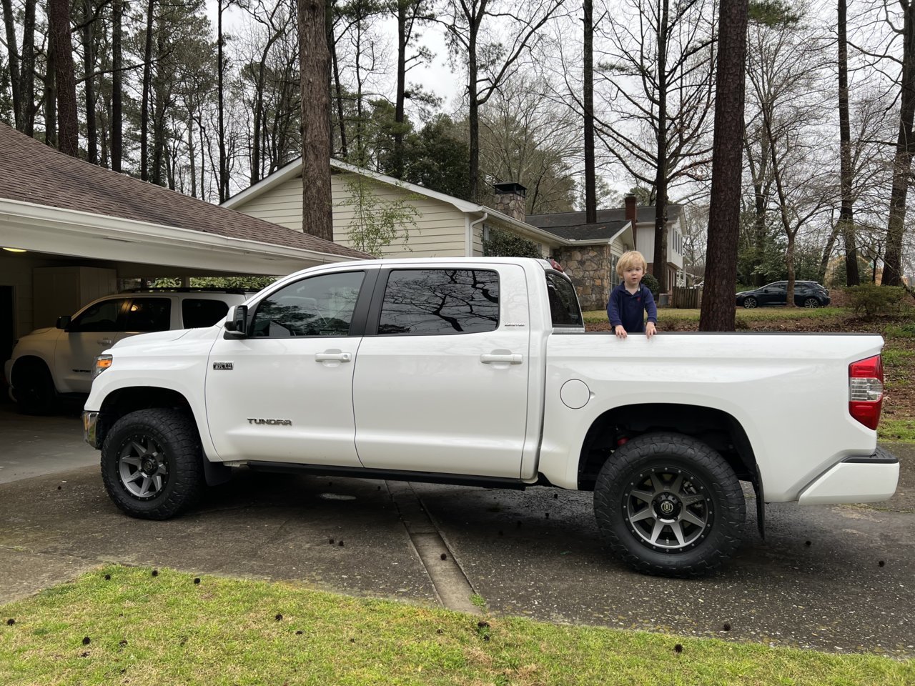

    Here it is.. does this look right? Seems way taller/bigger than i expected
    tires are toyo at3, 275 70 18
    wheels are 18” icon rebounds

    Looks great

    way bigger than i expected

    That's what she said.
    Looks good btw.
