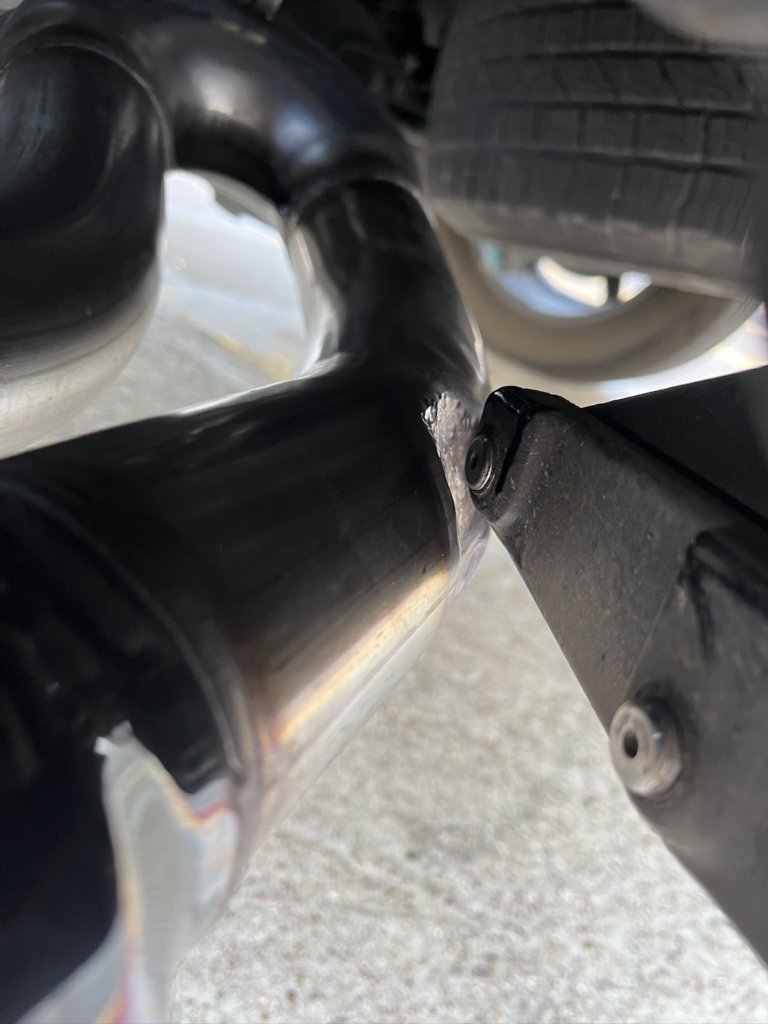

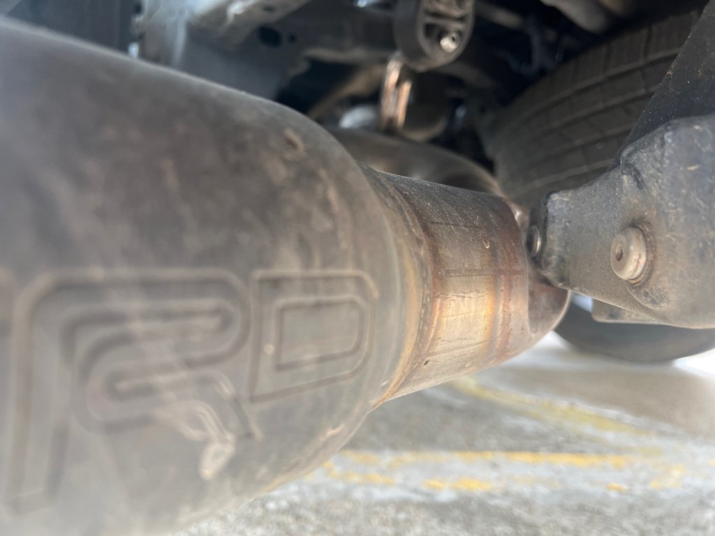

    Has anyone figured out how to make the exhaust work with the power step?

    @Alex261 currently it rattles a bit. However I’m in search at my trip to Home Depot this morning for a solution.

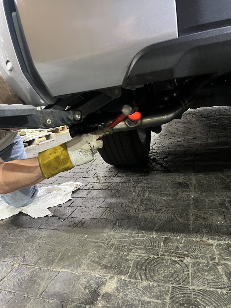

    I heated with a torch and dimpled it with a ball peen hammer. It took a couple tries to get enough clearance since the exhaust grows a bit when it's hot. The key was getting enough clearance so the step would extend with the exhaust hot and engine running. If the step touches anything it won't extend.

    So does it not touch now? I figured denting the pipe would be the solution

    It does not touch. Here's a pic I just took after lunch so the exhaust is hot.
