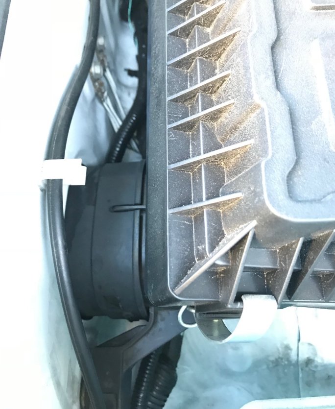

  15. Jun 13, 2018 at 7:09 PM
    nk1794
    nk1794 Always torque to spec
    Jan 24, 2018
    #12420
    3,755
    San Jose, CA
    2016 1794
    I dont know about 2nd gen but for the 3rd gen this is how it looks.

  21. Jun 13, 2018 at 8:01 PM
    CaptainJohnnySR5
    CaptainJohnnySR5 Tundra Lifer Now!
    May 27, 2018
    #15635
    207
    Capt Johnny
    Winter Garden Fl
    2012 Silver Tundra 5.7 SR5 2WD DC TRD Upgraded. 2017 SR5 TSS Off Road 4x4 DC Blazing Blue. 2019 1794 White TRD Off Road 4x4 CM
    I am totally addicted to Tundra Life now!
    Oh hell no! That totally explains everything forbus Gen 2 guys. Ours is way longer!!!!
  22. Jun 13, 2018 at 8:05 PM
    nk1794
    Jan 24, 2018
    #12420
    3,755
    San Jose, CA
    2016 1794
    It's the same as mine so all you have to do is squeeze it to make it smaller and then push it in pass that bump and it should be fine. Basically the bump has to be inside the fender.
    equin, Rngr188 and Skippy like this.

  25. Jun 13, 2018 at 8:53 PM
    #25
    Rngr188
    Rngr188 Ranked the best new member of all time
    Feb 9, 2017
    #6285
    1,489
    Chad
    Harrison AR
    2020 1794 MGM TRD OR
    Yep, push that "bump" into the fender and problem should be solved. @Rica25, can you physically see the "bump" if so squeeze the AFE some more until it goes through the opening in the inner fender. Once that bump is through the hole you will be able to move the box to its original position.
    equin, 15whtrd, Rica25 and 1 other person like this.
