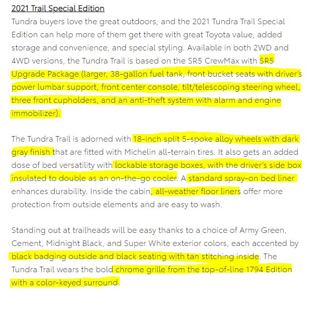

    It’s TRD Trail Edition. Nothing to do with any different “trail tuned” suspension. It’s just an appearance package that comes with a storage cooler in the bed.
    15whtrd likes this.

    @Lug Nut, I think the trail/off-road tuned shocks are on the TRD off-road. Fully admit I have not done more than a cursory search, but the Trail Edition announcement stuff is below. I highlighted the stuff that puts it above a basic SR5, and it doesn't mention anything for the shocks.
    Can you look at your shocks and report back what color they are? If they aren't Bilstein blue and yellow then they are likely the standard black Tundra shocks that are on all the non TRD Off-road/Sport/Pro trucks.

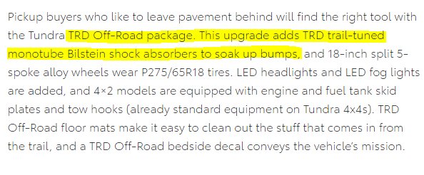

    33,789
    18" TRD Off Road Wheels
    Here you go OP, the "Trail Tuned" shocks are in the TRD Off-Road package.
    Good news is, if you want to swap to them there are usually plentiful take offs available from people who have gone with aftermarket suspensions.

    Indeed,
    I have the limited Premium Package with Options.
    The website says “trail-tuned Bilstein shock absorbers”
    The shocks on the truck are yellow body with blue boots. From what I understand, they are special built by Bilstien for the Toyota Tundra.
    Asking about bumpy road performance, compared to the standard shocks, because this truck feels stiff and bumpy. I only have 900 miles on the truck, all pavement and have yet to place a load in the bed. I have no standard truck to compare.
    I assumed that Trail-Tuned would mean softer. Coming out of a bumpy, light 97 Taco, I was looking for a heavy, smooth truck.
    I planned to replace the suspension in a few years anyway, but was hoping to at least enjoy and wear out the stock shocks before upgrading the tires and suspension.

    Ah, i see. I misread. I thought you said you had the Trail Edition truck.
    It will undoubtedly ride better if you put some weight in the bet, as all trucks do. It's a heavy truck, but the ass end is still light and will bounce a bit. The TRD Off Road shocks are softer than the stock black ones from what I've hear, but they aren't going to compete with any reasonable aftermarket shocks. Manage expectations, though. It's still going to ride like a truck no matter what shocks you put on it.
    Final thought, what wheels come on the Limited? If they are 20 inch, then that is part of where you are negating the shocks. More sidewall means more cushion. Lots of members have ditched 20" wheels for 18s and said it was a solid improvement in ride comfort.
