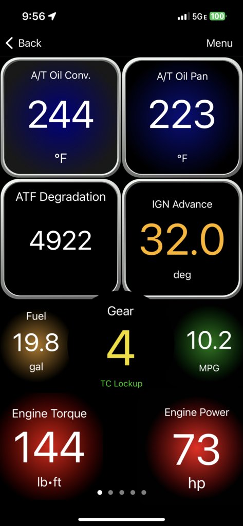

    My max readings while towing 8k# in S4 through hilly Arkansas terrain in my 2019 CM Limited TRD OR on stock tires no lift.

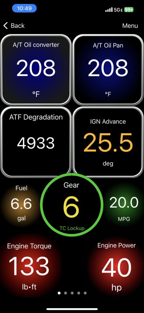

    Unloaded 6th gear cruising
