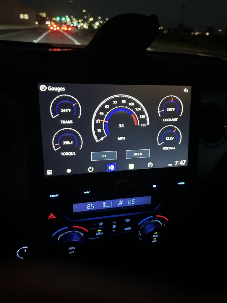

    I recently upgraded my head unit to a Kenwood receiver that displays additional gauge info such as transmission fluid temp.......Let's just say i' not happy with what i'm seeing.
    I never thought temps would climb over 220 on an empty bed so i never worried about it.
    Turns out, it hits 220 within 10 minutes on the hwy and 250 in texas summer heat.
    Big thank you to the honorable folks at TFL for conducting a legitimate test to ensure everyone, temps would not get passed a certain point in the worst of conditions......apparently, they should've conducted a harder test with an empty bed in texas heat on flat land.

    To everyone asking.....no that is not the torque converter temp, that is the transmission temp and it's 100% accurate.
    The info is fed directly from toyota computer via maestro. I also have scan gauge, it reads the same exact numbers.
    The temp get this hot every single time i drive an hour plus in texas heat.
