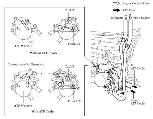

    Drain pan, fill pan with 4 qts, pin the thermostat open, drain 2 qts from cooler line, turn off truck, fill with 2 qts, repeat till fluid is clear. It can take 12-16 quarts total to accomplish this, took me 16qts last time to get the fluid looking exactly the same as the fluid that went in. Having someone help with cranking the truck is a huge help while you drain the 2 qts from the cooler line.
    Some people drain 4 qts from the cooler line, I don't recommend this because that's how much your sump holds. I'd rather not take the chance on running my sump dry, so I take the few extra minutes doing it 2qts at a time. 232k and she shifts like butter. Also, no need to ever drop your pan or change the filter, I have a thread disproving that myth on these transmissions, with pictures to prove it. I'll link if you're interested. Screenshot_20211109-214952_Acrobat for Samsung.jpg

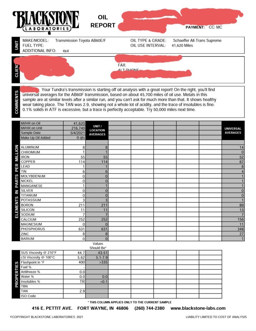

    What's funny is that UOA I posted was with the wrong spec fluid, it's slightly thicker in viscosity than what I was supposed to use. But it worked well and held up great, these transmissions aren't picky. I've since switched to Schaeffers 205A, which is the correct spec. Once this fluid runs its course I'll be switching to HPL fluids, so that I can have the same brand fluid front to back.

    UOA speaks volumes.

    - You'd have to pin the thermostat open each time you drive the truck around the hood to make sure that ALL of the fluid is circulating. Otherwise you could just end up mainly draining and filling the trans pan alone each time which would be a waste. And pinning that thermostat multiple times with a hot catalytic converter right there trying to burn a guy would be a PITA.
    - Each time you put fresh fluid in, it gets mixed with 2/3rds old fluid. And, it's impossible to say what % concentration of old fluid is what's coming out each time you drain. So doing it this way would take a lot more quarts of fresh fluid and more cycles in order to fully clean the system.
    I thought about doing this exact same thing myself, but I finally elected to spend $225 and have a trusted shop cycle out all the fluid at once with a machine that relies on the vehicle trans pump. That way it saved me money AND hassle. All I had to do after that was start the truck up while cold, put it into "temp check mode", and verify the fluid level was correct.

    I believe the cooler lines/cooler itself only holds about a quart, so you wouldn’t be missing much
