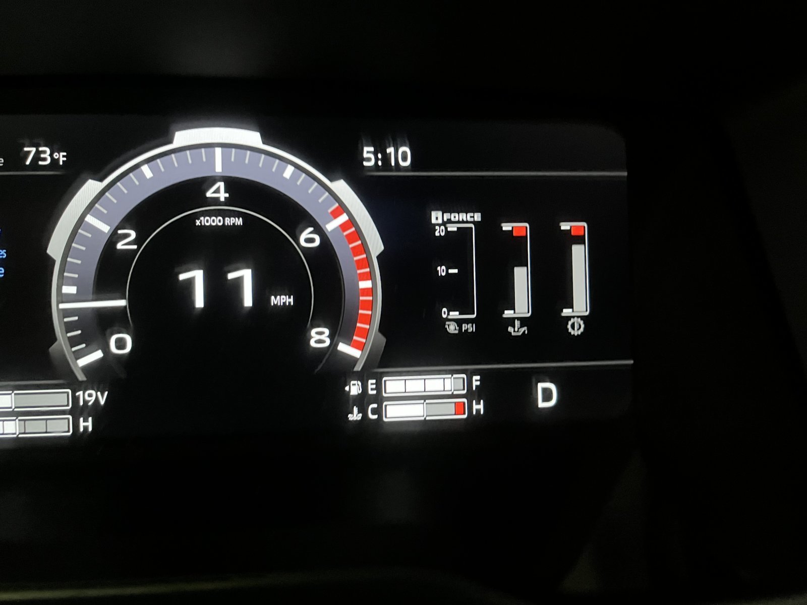

    25
    24 Black limited TRD
    I ran into this transmission temp issue on my first off road trip and it was what I would consider the bunny slopes. And I was in 2wd. Will try tow/haul next time around. I also tried manually staying in 2nd gear about 1800-2000rpm and it didn't make a difference. Alot of the uphill sections were only a few hundred yards long.
    Talk about being frustrated. I felt like I needed to peel the TRD off road stickers off.
    i snapped this pic at the top of a hill. Thanks @SDHNTR for keeping us updated with your findings.

    Yes, it will happen in 2wd also, just gets there faster in 4wd. PLEASE do us all a favor and report this to your dealer. Make them open a case with Toyota. They have no idea this is a regular issue. This needs to be recorded! Not enough people use these trucks in this manner to be noticed so the dealers don’t see this often and have no idea what to do. Nor does Toyota, I’ve had a case open for over a month now with zero resolution and zero answers. They can’t even tell me where that gauge is reading trans temp from, nor what the actual temps are when the gauge is reading that high. It’s an embarrassment!

    you can see in my pic that oil and coolant temps were normal, it was just the trans temp for me.
