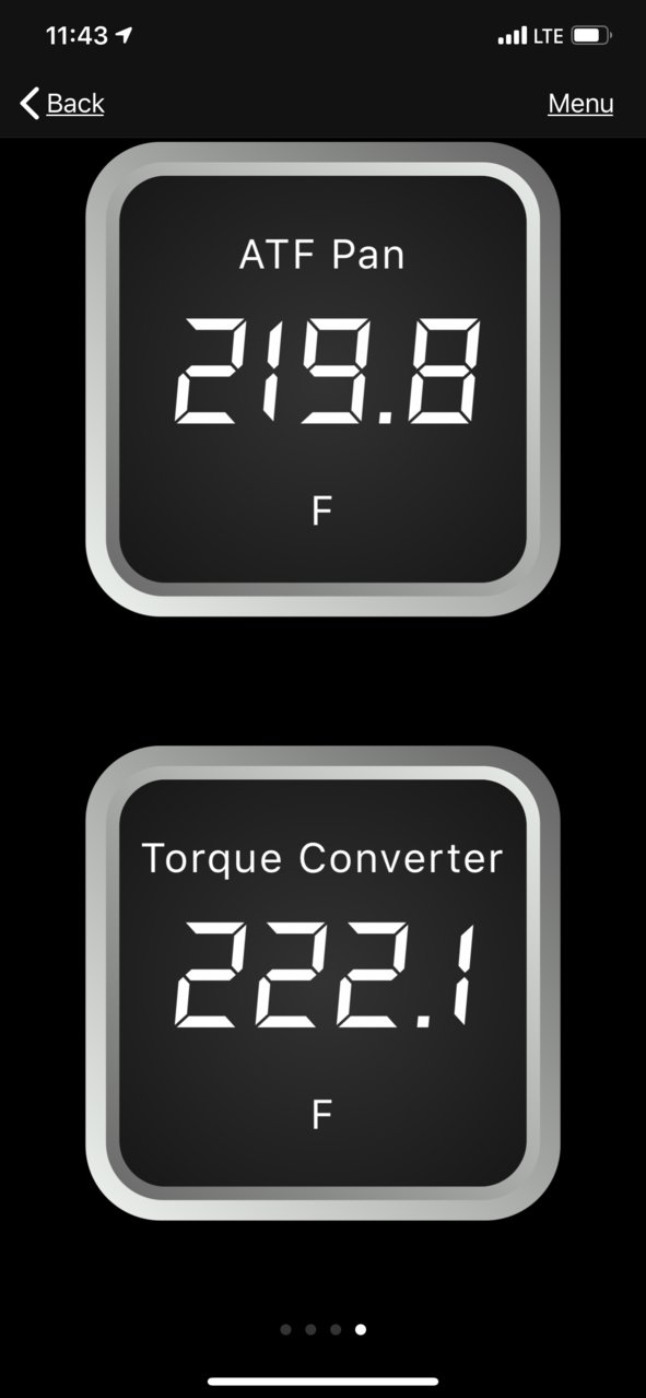

    Just had the same experience driving up Silver Canyon into the White Mountains east of Bishop, CA loaded with camping gear. Was 100 degrees outside and about 2/3 of the way up the 6K climb the warning light popped on. Dug around in the manual and found it said if the light turns off by itself, proceed with caution. Warning light went off in a couple minutes. And, yes, I was lugging it in 4Hi. No further problems when I put it into 4Lo.
    Tchase[OP] likes this.

    So I just got into the older trans cooler thread when it got locked, was a bit of a mess, but here’s my info. These temps were realized while towing a 3500lb V-nose trailer west on I-10 from Texas to California. Outside temps were consistently over 95. I kept the trans in S-4 at 60-65 mph and unless the converter unlocked it was fine. If the converter unlocked it would flash up to 255 and the pan to around 240 then cool right back off after locking up again.
    I’ve got a Hayden cooler setup on the way.
    The return trip loaded has been the same, I don’t know what the over-temp condition is but it isn’t 260 degrees.

    That’s about what I tow. You will be fine. While I do think watching the temp is smart, buy yourself a monitoring system to make sure you have a problem before you go solving anything. These treads can be “chicken little” inducing.

    Your climb was higher than mine, good to know your results same as mine once we were in Lo
