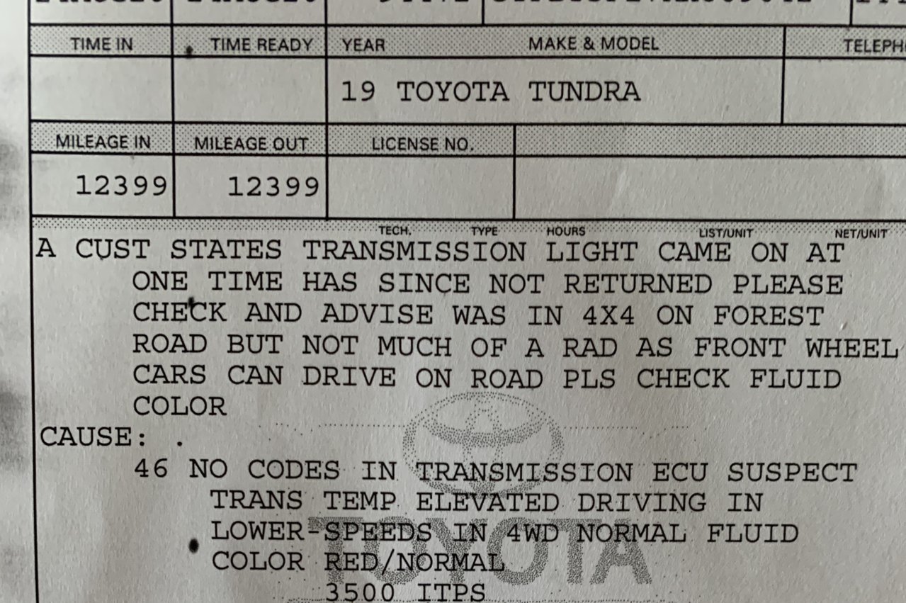

    The thing is we don’t know what the range is to trigger. The dealership did what the manufacturer recommended not much more to say.
    I’ve proven the truck performed flawless in 4 lo on my second run. And I could of probably made it in rwd without issue, but why not use the 4 lo.
    I’ve documented the incident, truck runs as it’s suppose. The “normal” might just be that, it’s normal to get warning letting me know my dumbass should of been in 4 lo if I wanted to go that slow...

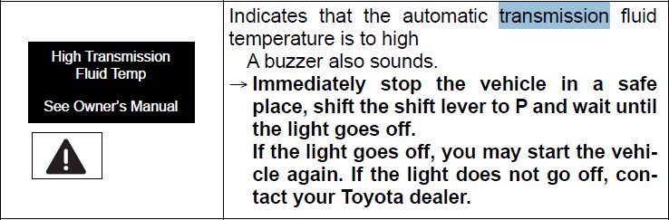

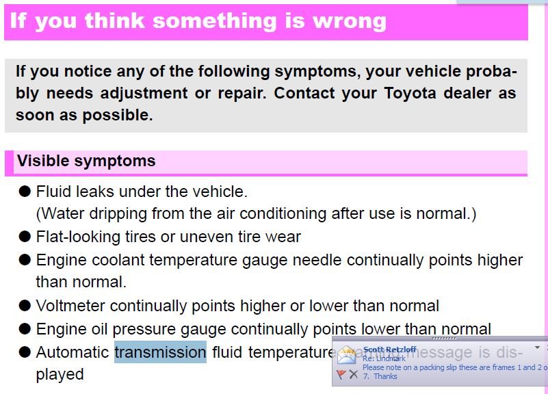

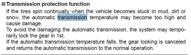

    In work
    I'm not so sure TIS is the factor in play here...
    Take a look at the screen shots from the owners manaul.
    On the message I got (the first pic) they certainly are not worried about it, pull over let it cool down carry on. nothing about going to the dealer. This is the message I got, I did not pull over for it to go off I kept going and about 1/2 mile it went off. The next 2 are not what I had but interesting...
  24. Aug 25, 2020 at 10:32 AM

    Yep I know about the software I have it and have used it. My take away is that the owners manual basically says if it hits a set temp pull over and if it cools down proceed. Nothing about you've boiled your fluid take it into the shop etc...
    There is also the transmission protection function how does that come into play?
    If you are saying that the TIS is telling the ECU to throw the warning message when hitting 302F the question is, is 302F a bridge too far? Because Toyota is basically saying no... just pull over let it cool down and proceed.
    I'm much further down the rabbit hole on this than I want or should be. I think the major take away is if your are in 4 wheel and going slow you need to be in low. If you are in 4 wheel and going fast you need to be in HI. It just never occurred to me that being in Hi while going slow would heat things up more, but it makes sense.
