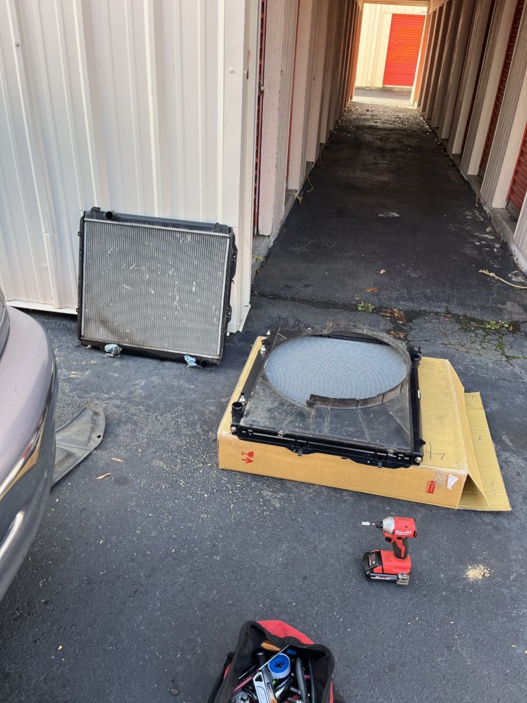

    Update here: new Denso unit installed

    Mini-Storage workshop - that’s a new concept.
