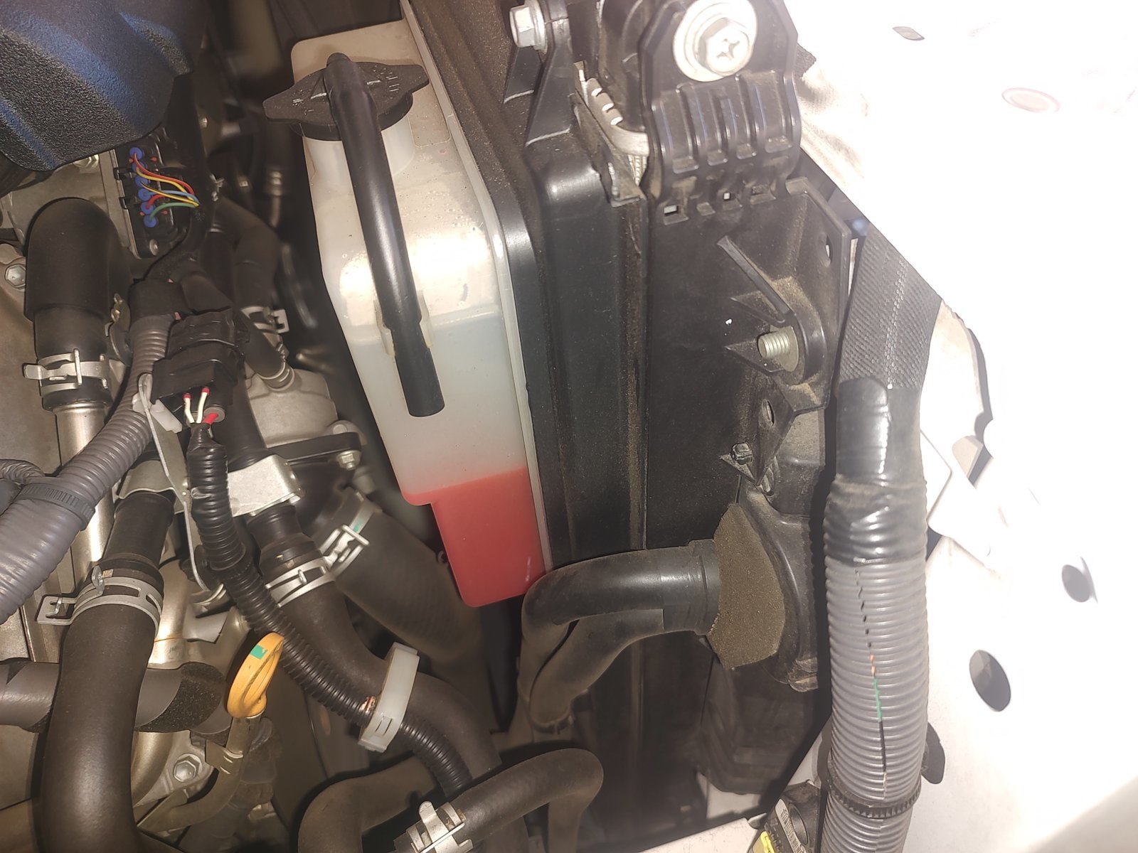

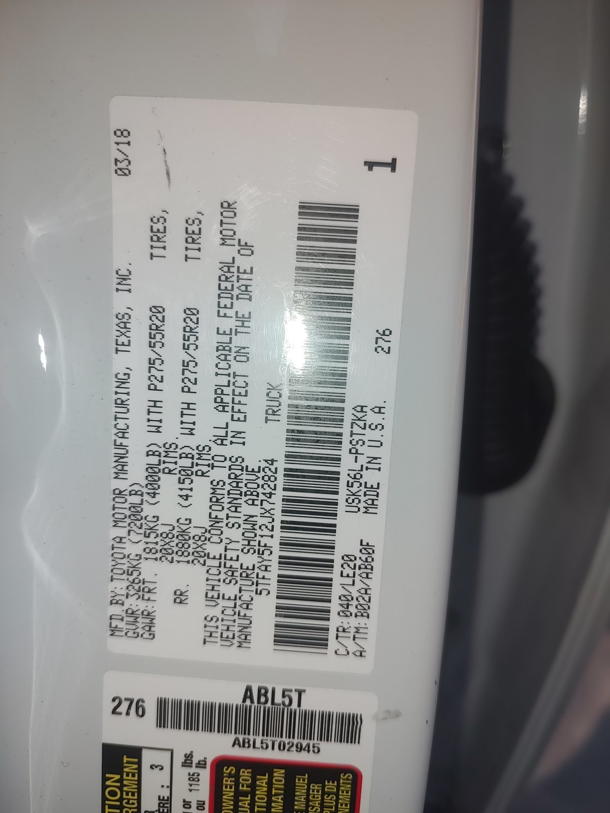

    But I seem to have lines running back to the transmission from that area

    03/18

    Well isn't that the strangest thing. It does indeed look like you have the trans cooler and running the R1234YF in the old AC exchanger. I was expecting a late build 2018. How well does the AC cool?
    Here is a picture of my 2016 and you can see it's the same as yours and it's using R134A.
    I use to own a 2020 and I'll see if I can dig up a picture of the R1234YF condenser.

    You are mistaken. 2018 was the first year for R1234yf but still had a transmission cooler. It is believed that due to complaints about less efficient cooling with the new refrigerant caused them to redesign the condenser thus eliminating the transmission cooler.

    Yes we have established that he already has the ambient transmission cooler. I did not know that Toyota tried using R1234YF in the 2018 rather than redesigning it.

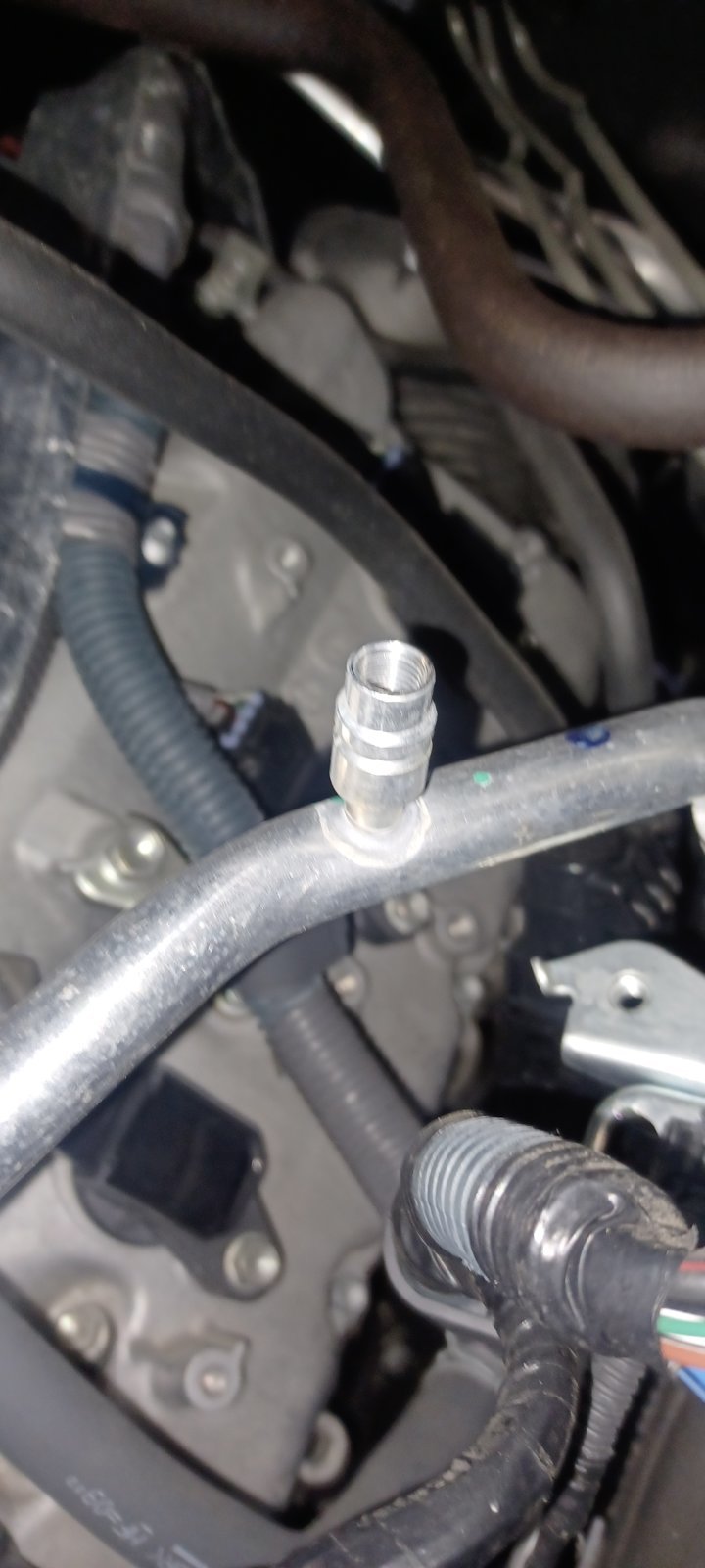

    I was just thinking the same thing. The AC ports are different between the R134a and R1234YF so switching refrigerant would require a port change so the R134a machine could be connected. The port is part of the hose so you would probably have to change the hoses unless you can find a AC shop that has adaptors.
    Here is what the R134a port looks like.

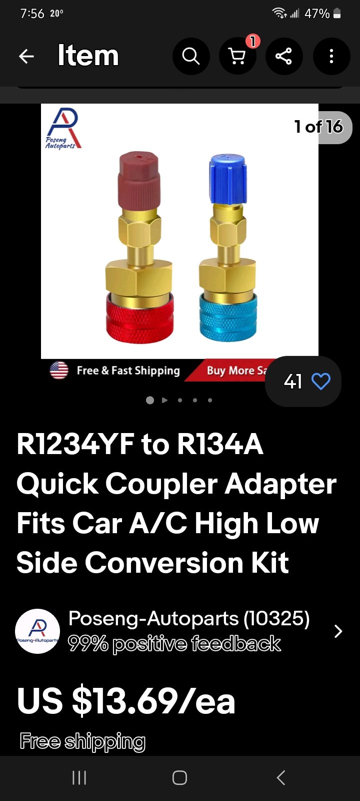

    I may have to find a local AC shop and ask them. Them having an adapter sure would be nicer than having to change the hoses out. May make a thread on here to ask other 2018 owners if anyone's already looked into this. I hope I'm just wrong and come summer it's adequate, but I'm already one of those guys who runs hot all the time, so I kinda doubt it.
