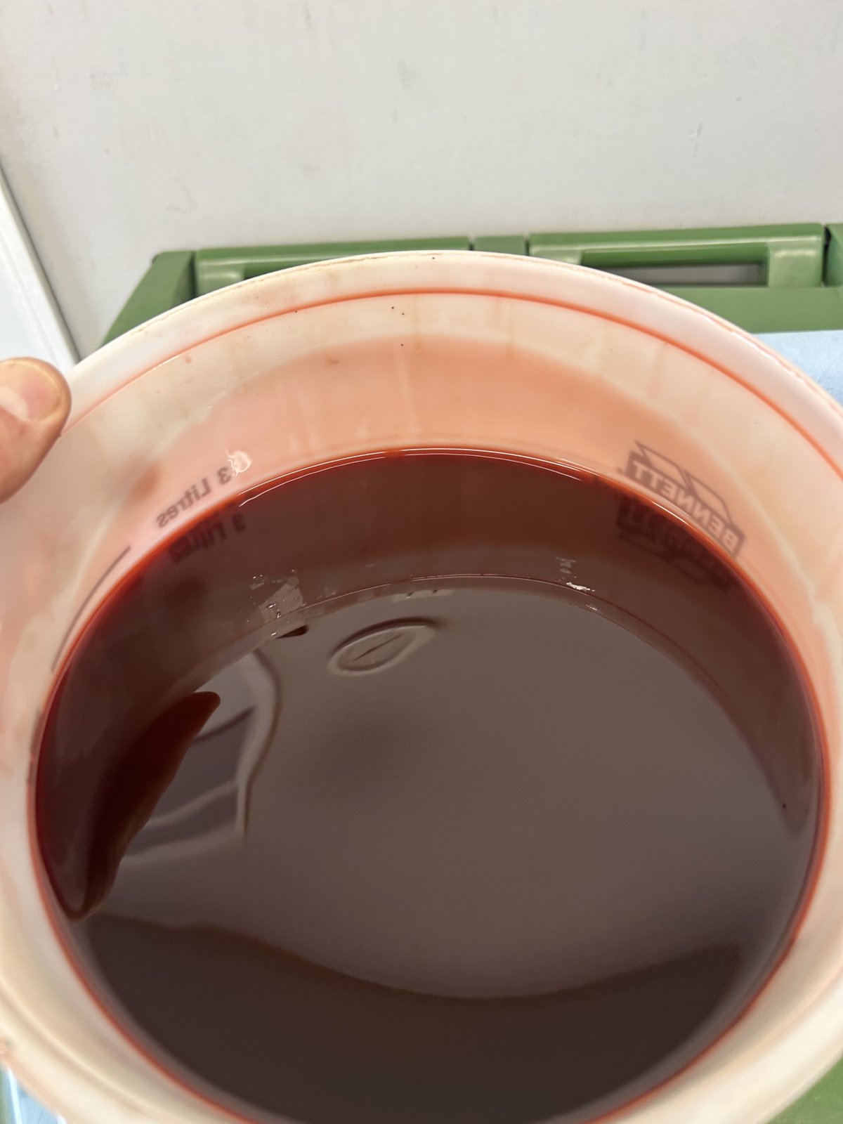

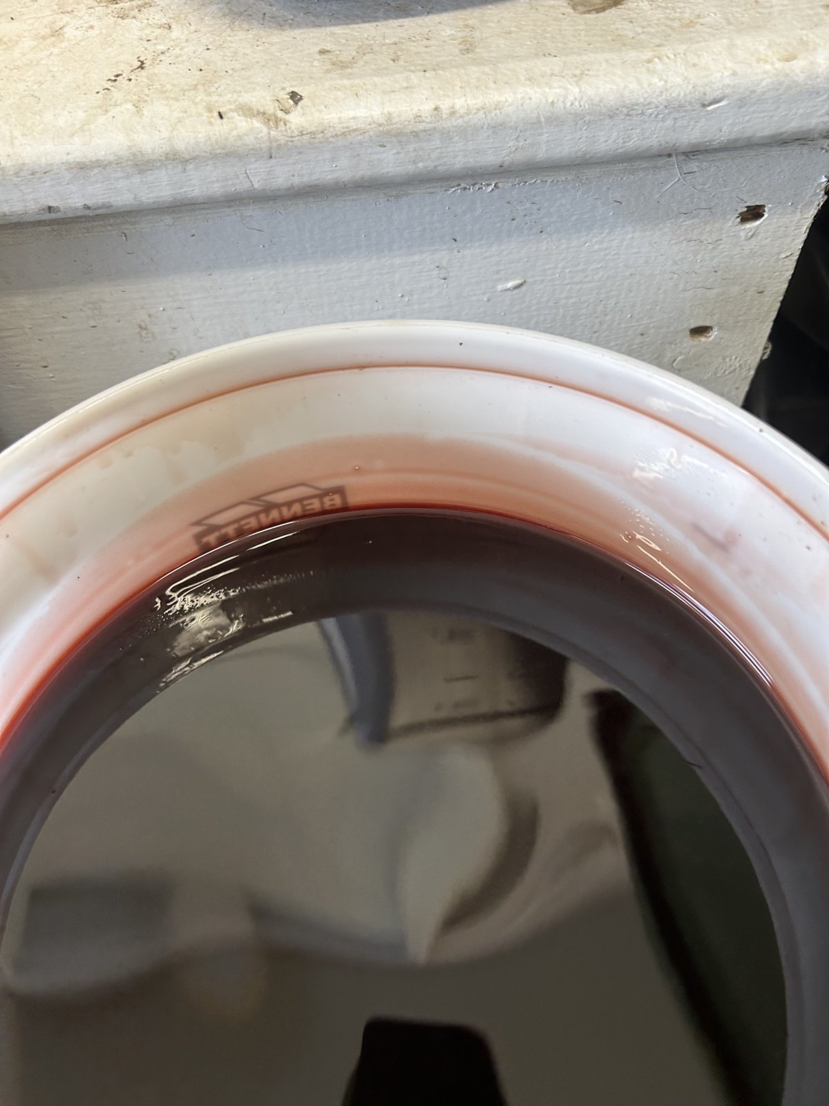

    So transmission has mostly fresh fluid in it now. Used Amsoil, drain and filled about 16qt total.
    I’m Canadian so I don’t know how many washing machines are in a quart or donkeys make up a mile so I’m switching to metric.
    truck has 70,000km on it, first drain and fill for the transmission. Of thw 70,000KM at least 30,000 are towing a 16’ enclosed, steal frame trailer… pretty loaded up.
    step 1. I changed the rear differential fluid. As recommended by posters on this thread. The truck had already had the differential fluid changed early on with Amsoil 75-90 severe gear oil. I wasn’t able to get Amsoil today and wanted it done so I used Lucas full synthetic 75-90. Old diff fluid was a little grey but not bad. I’d guess between 1/32 and 1/16th of an inch of material on the magnet. Worry free now that it’s done
    step 2 drained the transmission. Almost 4L came out of the pan. Put the same amount back in the pan, ran it for 5 minutes, shifting through gears. R-D- S1, S2 and up. Did this 4 times. So about 16L out and 16L in. Each time I refilled I put slightly more back as the new fluid was room temp and the transmission was warm to hot.
    Step 3. With the engine running and transmission at temp using a scan gauge, I then set the fluid level at the proper amount using the Toyota technique with the check plug.
    Here are some photos of the first drain vs the last drain. I’m planning to repeat MAYBE, next month. Maybe.
    Ruggybuggy and Hugemoose like this.

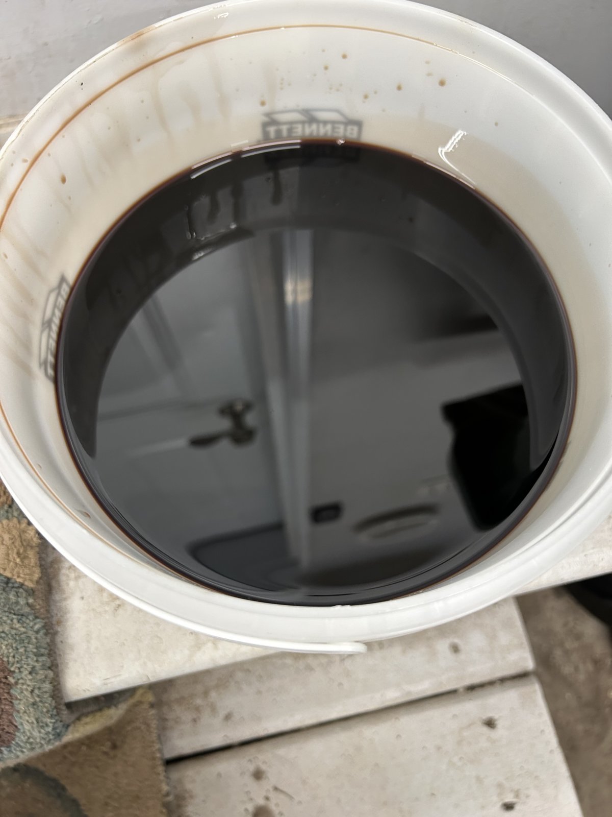

    Been a couple months and I decided to do a drain and fill again today, just to see how the Amsoil looked after a winter of driving and hauling. Again %90 that this truck drives it’s pulling a fully loaded 16’ enclosed trailer.
    Still looks new - as it should.

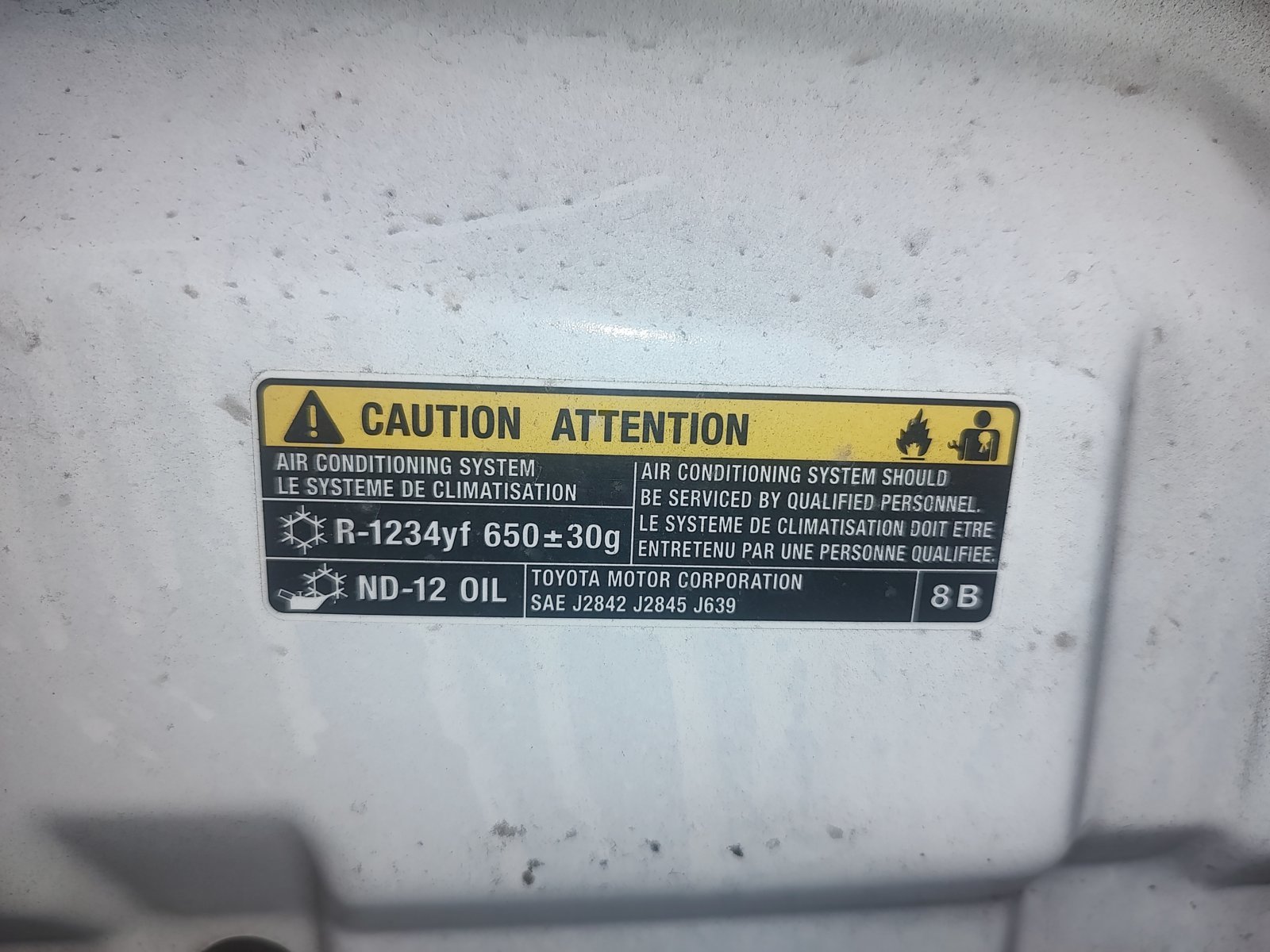

    The 2019 to 2021 use the new R1234YF and looses the transmission cooler. There is no heat exchange between the AC and transmission. The R1234YF Tundras use a stand along condenser. The T1234YF refrigerant is less efficient at exchanging heat so the condenser is larger then on previous models which used R134. Toyota could not use the AC/transmission heat exchanger because of the new refrigerant so they simply dropped it and relied on the warmer/cooler heat exchanger mounted on the transmission. Because the new Tundra was coming out Toyota decided to simply just remove the transmission cooler rather than redesign to save money.

    So is everyone saying that 2019-2021's have no cooler mistaken, and it's actually 2018-2021?

    Open your hood and look at the sticker that shows your refrigerant type. If you have R-1234YF you do not have the ambient transmission cooler.
    Your 2018 should have R134A so it should have the cooler. I've made the year correction in my post.

    Wow, a 2018 using R1234yf. Then unfortunately you don't have a ambient transmission cooler. What is your production date, month and year, on the door sill?
