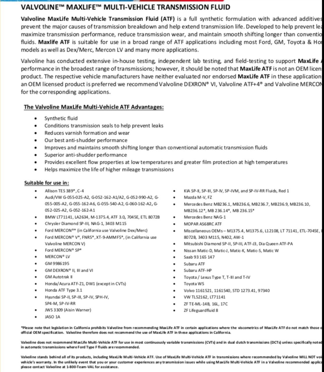

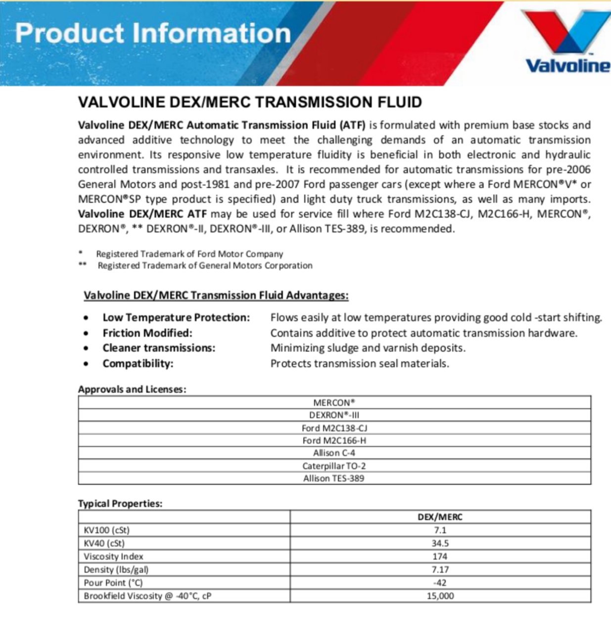

    Marbles has made good points, specifically about the licensing. What he can’t argue for or against is the exact formula in these aftermarket type fluids and whether they are lacking the fortifications.
    My opinion is to use the Valvoline DEX/MERC because if you read the specs it fits a tight range of vehicles that require DEXII/III as the 2002 Tundra requires.
    The Valvoline Maxlife seems as if it tries to please a wider range of vehicles which gives caution to me, but others here have used it with no problems.
    I’ll post the two spec sheets together so you can see. What I find interesting is the DEX/MERC has a licensing and approvals table (Maxlife does not) which I was hoping Marbles would catch/comment on with his legal slant when I posted this spec way back in post #8 of this thread.
    DEX/MERC has the DEXIII licensing per the spec. Its cheap and readily available. A no brainer.
