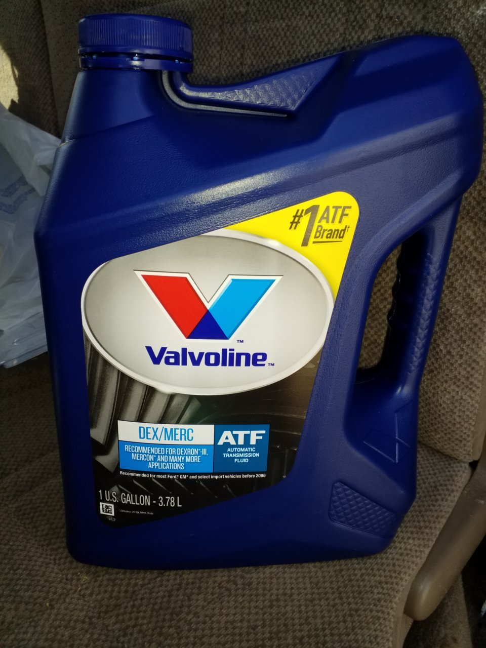

    Stick with Valvoline Dex/Merc (DexIII) on the early 1st Gen Tundras. Cost about $14 a gallon. Its very specific to our transmissions.
    The Type-IV works for other members here. Reason I don’t use it is it covers a wider range of transmissions (see spec) and it costs more. I do drain and fills every other 3.5k mile engine oil change so new approx 4.5 Quarts drained and filled at 7k miles. Extra left overs goes to suck and fills on the Power Steering.

    I can chime in. I got started with max life for Honda’s and have used it for several years and 100000+ miles about three times. I put it in a 2008 sienna at about 130000 miles and just sold it with 230000, no problems. It’s in my 2006 4.7 liter now. Like PHM says, the blue bottle is the right answer for Dex III trucks. It’s good quality fluid. It also mixes fine with the factory fluid. Red bottle is fine if you want to go with a single fluid for all vehicles also. I’m doing that right now, actually.

    The good stuff. My PS leaks so much I just carry this around with me.

    I have this one, and the red jug now. Keep it with the truck. (Red jug is for car.)
