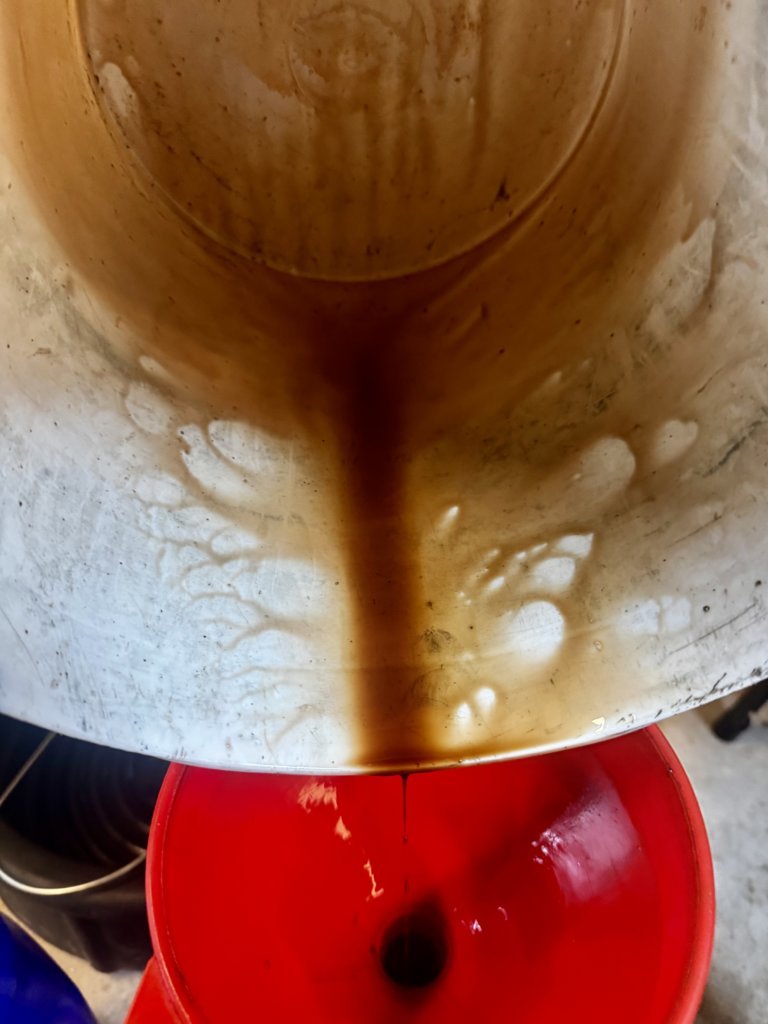

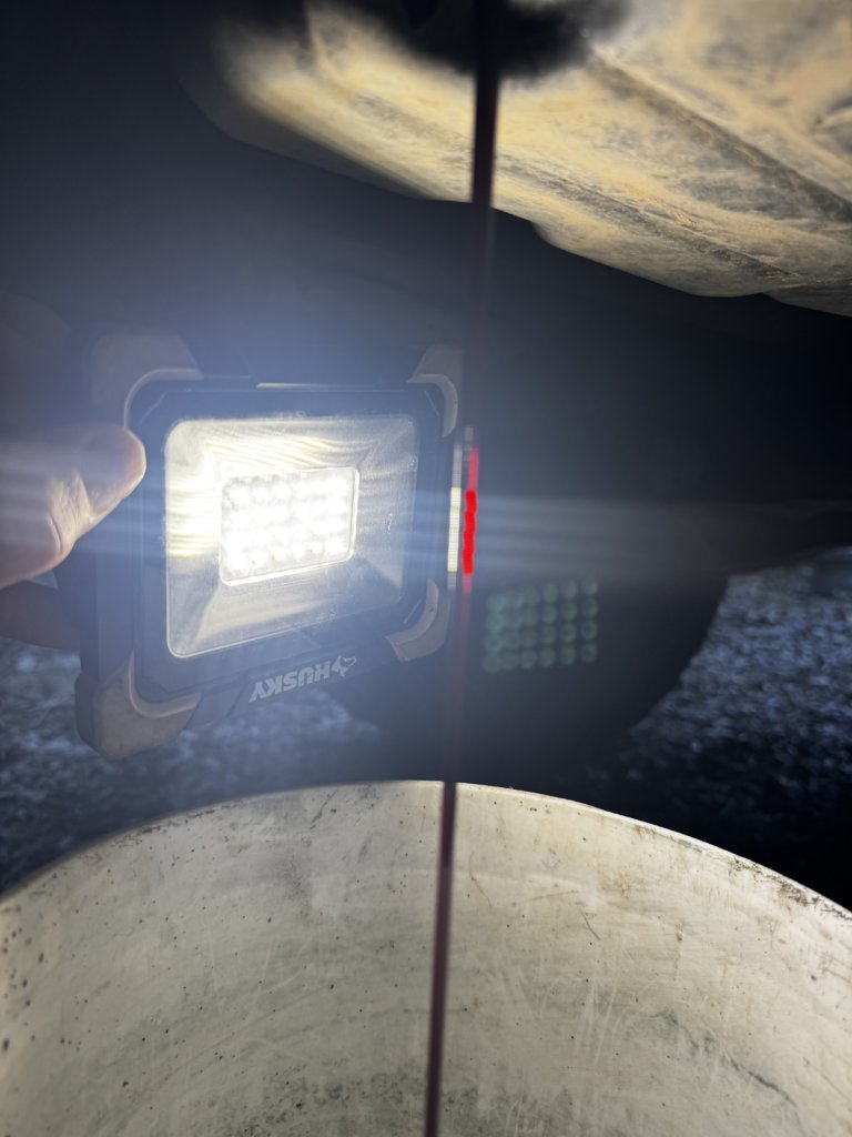

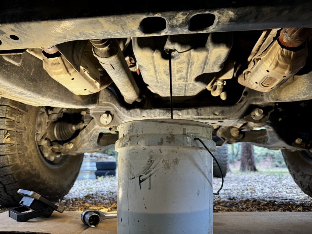

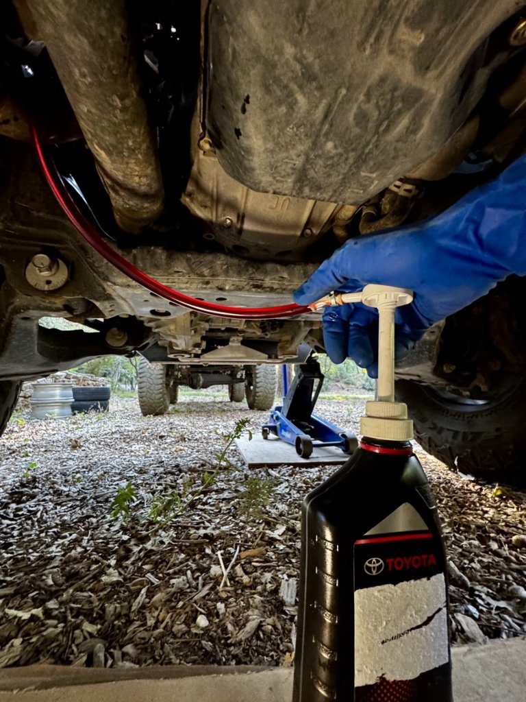

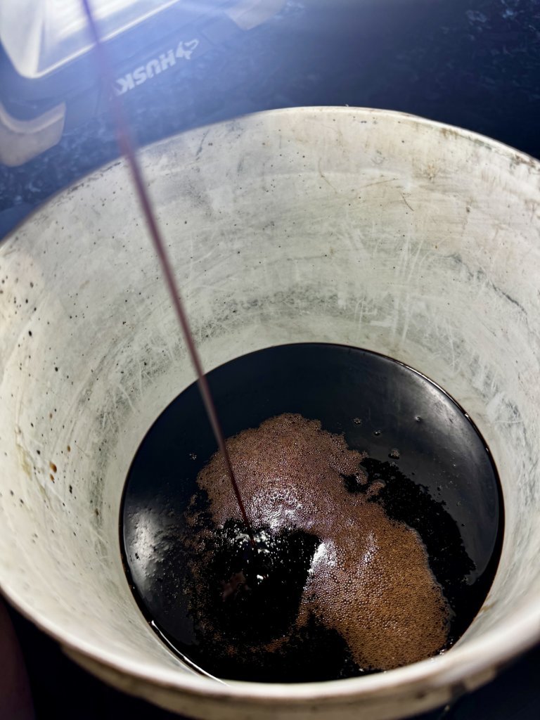

    Okay, it’s done. It does seem to shift slightly smoother (maybe)
    The ATF that I removed still had a little red color to it, but it was dark. The littlest amount of glitter against the white background of the bucket, and no foul smell to the old fluid with 120k on it. The drain and fill took approximately 3.5qts.

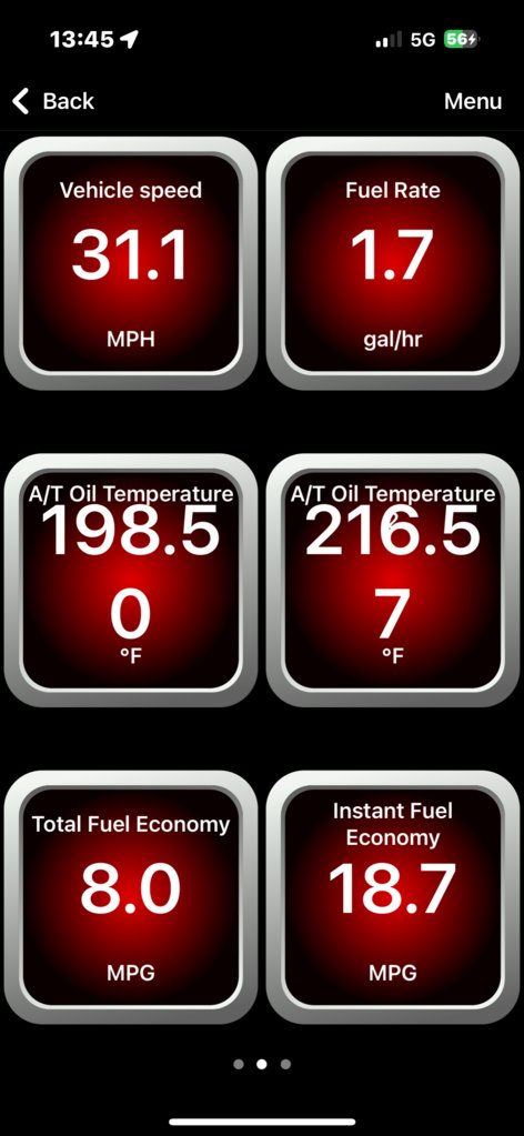

    My normal operating temperature appears to be between 180°-200°f.
    There are two transmission temperature sensors according to the OBDLink MX+. The first one seems more stable, and the second one jumps around a lot. Here are some photos of the job.

    Great job. The lower more stable temp is your pan temp. The higher more volatile temp is the torque converter temp. It will match pan temp if locked for a while. When unlocked, there is more friction in the converter which cranks the heat up. They can be 50° apart at times.
