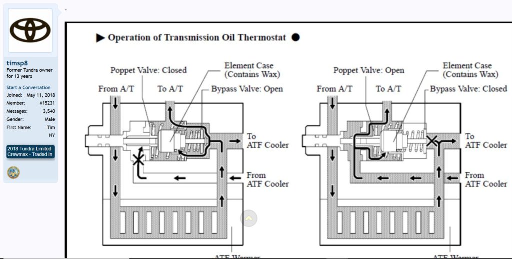

    How much did you get out after adding 1.5 quarts during check process?
    Theoretically cooler hasn't filled yet, when thermostat opens it will fill then you may be low. I would pin it open go through the check process again and see where you are at.

    2021 SR5 CM 4x4
    You could of been low initially or some fluid can bypass thermostat by design ... I don't know.
    I'm curious though, so go ahead and do the check process with it pinned and let us all know.

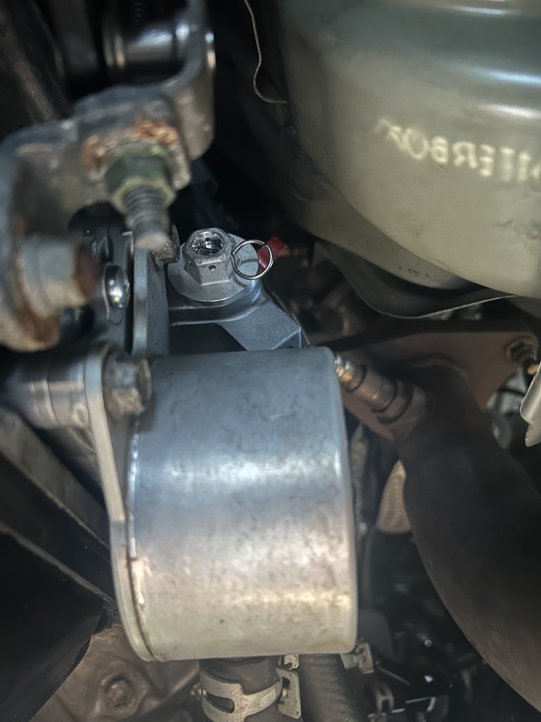

    Ok getting ready to go out, pin the thermostat and do the check procedure again. Couple questions:
    1. Should I add more fluid? Initially added the 1.5 quarts and did the check procedure. I got about 4 ounces out and then closed it up. Before do the check procedure again, should I add more fluid? If so how much?
    2. After I get the level right, I eventually want to do a drain and fill. Should I just replace what comes out or should I go through the whole process of adding extra fluid and doing the same check procedure again?
    thanks in advance
    joseph_womack likes this.
  13. Aug 9, 2025 at 5:13 AM
    #43
    shawn474
    shawn474 Lego connoisseur
    Jul 23, 2019
    #33569
    2,876
    MoCo, Maryland
    Welp, got under the truck, removed the skid plates and found that the thermostat shipped pinned……so the fluid level was correct.
    Tunrod, joseph_womack, yakeng and 2 others like this.
