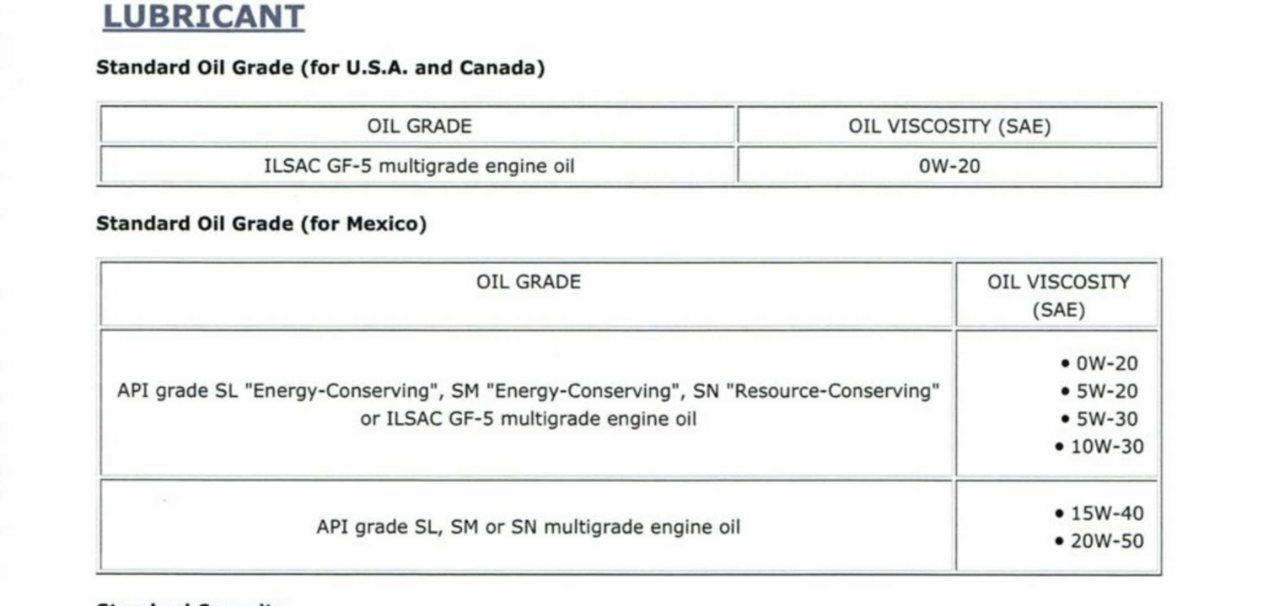

    Incase you were not aware, 0w20 is only speced in the 3UR-FE 5.7 engine in the USA. The same 5.7 engine in the Tundra in Mexico is allowed to use many different oils. This is a screen shot of Toyotas TIS system I paid a subscription for to use and save PDFs for maintenance. I can post the PDF if you don't believe me.

    Yep, I can't believe how many people I have told this too. The same old tired argument gets put forward-'the tight oil passages', 'the engine was only designed for 0-w20 or 0w-16'. Nope, all BS.

    Yup, trust me I did extensive research before making the switch and once I seen Toyota actually saying the same exact engine in another country can use a variety of viscosities that settled it for me. Too bad that gentleman blocked me and will not be able to see he is misinformed.
