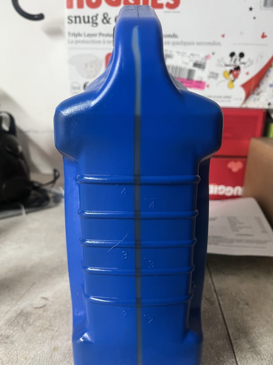

    Ready for another drain and fill on my rig - I always get 4 qts.
    Wallygator likes this.
