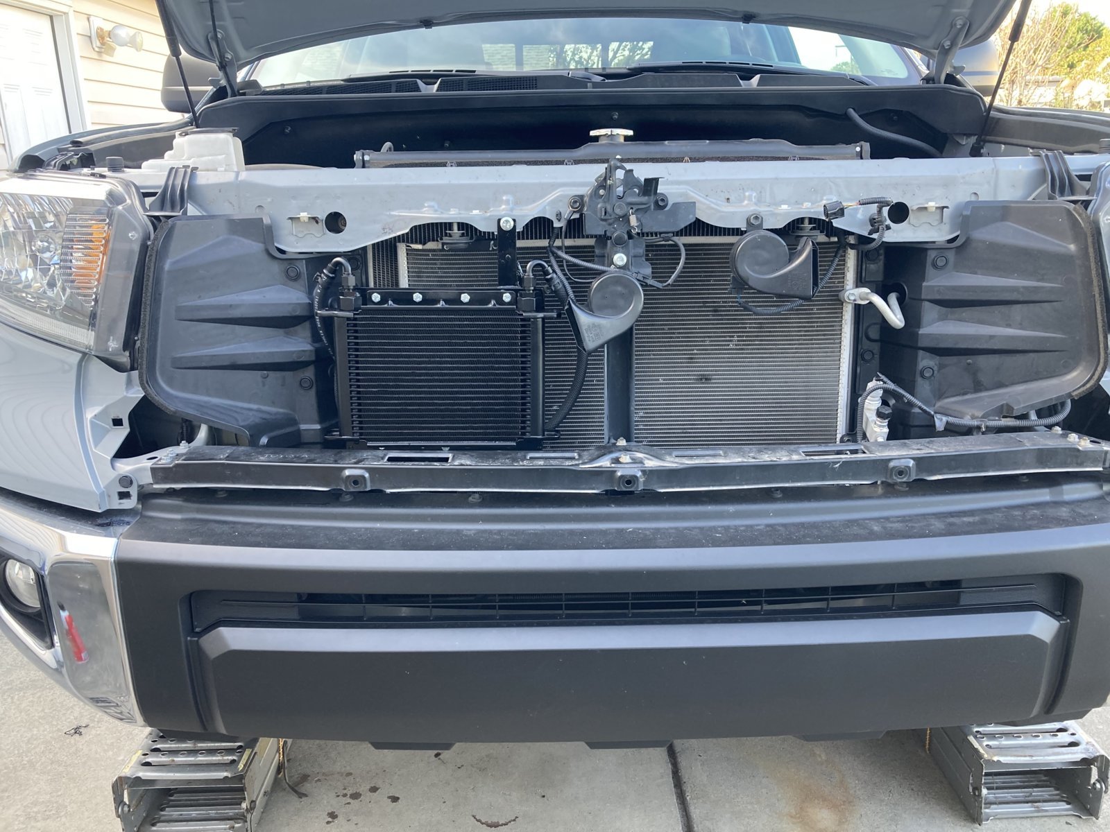

    ATF Cooler, FRAC, RCI Skid
    Installed 11/7, 15-Row
    Genuine Cooling Systems, full kit.

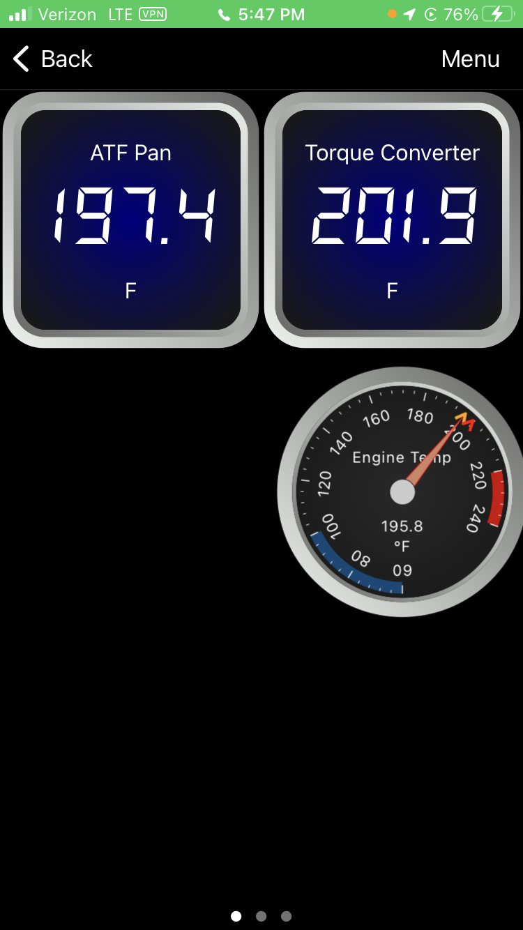

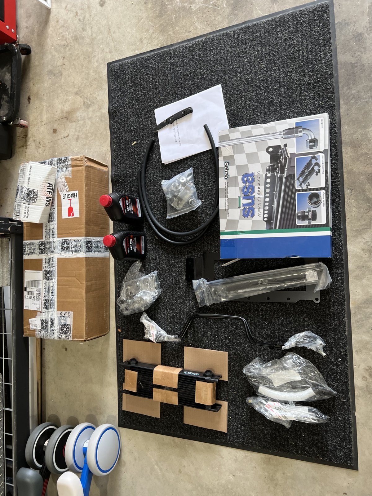

    New to the forum. My wife’s grandfather was leasing a 2020 Tundra SR5 double cab that I was able to buy for the pay off amount when it was time for him to turn it in. It had 24k miles when I got it in June. Knowing all the service history and how he babied it, I couldn’t pass it up. I’ve been reading though the forum and decided to add a transmission cooler also.
    The kit was out of my price range so I’ve been gathering the parts over the past few months and finally have everything I need. I went ahead and downloaded OBD fusion to get some before numbers for comparison. I live on the SC coast so the terrain is pretty flat so the reading surprised me a bit. It was rainy and in the low 60s today. I had the cruise set at 45.

    Second, congrats on your purchase. Sounds like a great opportunity that you capitalized on.
    Question: What part of your reading has you surprised? Most people were seeing around 225-250 unloaded. At or under 200 is great compared to factory acceptable levels. Hope that is helpful.

    2020 SR5 Crewmax 4x2
    I live in upstate sc and that’s around what I see just driving around with no cooler in the winter. About 5-10 degrees warmer in summer. Really the only time I see anything remotely close to the 220-250 numbers some have reported is if I’m sitting in traffic and not moving it might creep towards 220. But it quickly sheds about 10 degrees once I start moving

    Thanks.
    Honestly I wasn’t sure what to expect. Seeing 200 when it’s 60 degrees out and raining made me a little nervous as to what it might hit in the summer heat. Either way I’ll feel better once I get the cooler installed. We usually make a couple trips to the NC mountains each year and between the wife and 3 kids, we’re usually pretty loaded down.

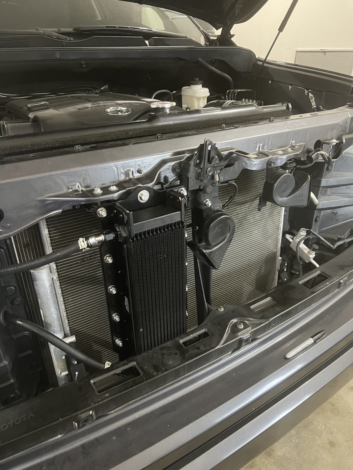

    Finished up the install on Saturday.
