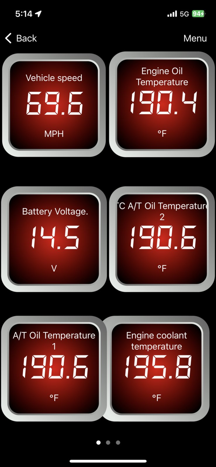

    your engine oil gets over 220? Wow, the highest mines ever been is 200, that’s going up steep grades with 37’s and stuck gears

    No one actually knows what the oil temp runs at for a Tundra since there is no actual oil temp sensor that can be read unless you add one. The OBD MX+ that I have has a "calculated" oil temp you can read but it just follows the same temp as the transmission fluid. I think he might have mean the coolant temperature, the oil temp I wouldn't think would be at 220 normally.

    AB60 has not one, but two physical ATF temperature sensors: in pan and by the torque converter. The values are not calculated, they are converted from the machine form to human-readable.

    I see, I was going off my OBD fusion App, I assumed there was a sensor for that.

    Apparently you did not read. I was referring to engine oil.

    I did too, then someone informed me that there's no sensor and I started watching it and realized it will just stay with the transmission temp.

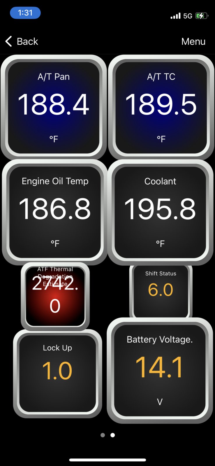

    Questions on reading the temps (first drain and fill at 90k)...
    1. What OBD sensor you using, that you have the Fusion app giving you the numbers?
    2. Any expenses/mods beyond the sensor and the app?
    3. How do read the ATF thermal degradation (I guess mileage it 'calculates' you've put on your trans or on the fluid? Both literal how to read (it's on the OBD app readout), and figurative (it's a number 0-4000, so 60000 means you've killed your tranny).
    Thanks!

    1. VPEAK BLE+
    2. I believe you'll need to buy the Toyota "Enhanced Diagnostics" in the fusion app if you want to read thermal degradation. Some other scan tools can read it too, like a lot of the Launch and Autel.
    3. See above how to read. The reliability of this number is pretty suspect and it's just a number with no real explanation on how to interpret it. Our Sequoia maxed out on it's number and it shifts smooth as glass. The max is 65535. It isn't based on mileage but supposedly thermal readings in the ATF. How it exactly determines the number is a mystery to me. Here's the readout from my Launch tool:

    Probably some mathematical formula based on sustained and highest temps and how those temps break down the friction modifiers in the fluid based on lab testing.

    I just added the PID to my dashboard in Fusion. Was surprised that my number is so low at 62.5k miles. I added that PID after my first drain and fill; don’t have any idea what it read before it got 5qt of brand new fluid.
    What I’m wondering is, does swapping in fresh transmission fluid bring the number down? Is it taking readings from the fluid itself, or is it more of an estimate based on mileage/fluid temp history? I would guess it’s the latter, meaning the estimate will continue to climb even if you drain and fill on a regular basis.
    I’ve had this big Hayden cooler on here since a few months after I bought it. Just thought the estimate would be higher; I haven’t been exactly easy on my truck. :notsure:

    My understanding is you have to manually reset the counter after a fluid change.

    The number is based on the temperature of fluid overtime the number will go up faster the hotter the fluid gets. It needs to be reset manually. Toyota recommends resetting if more than half of the fluid is replaced. I reset mine after a few drain and fills using techstream.
