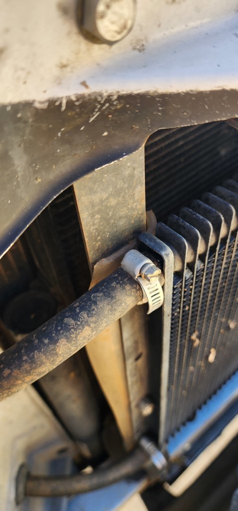

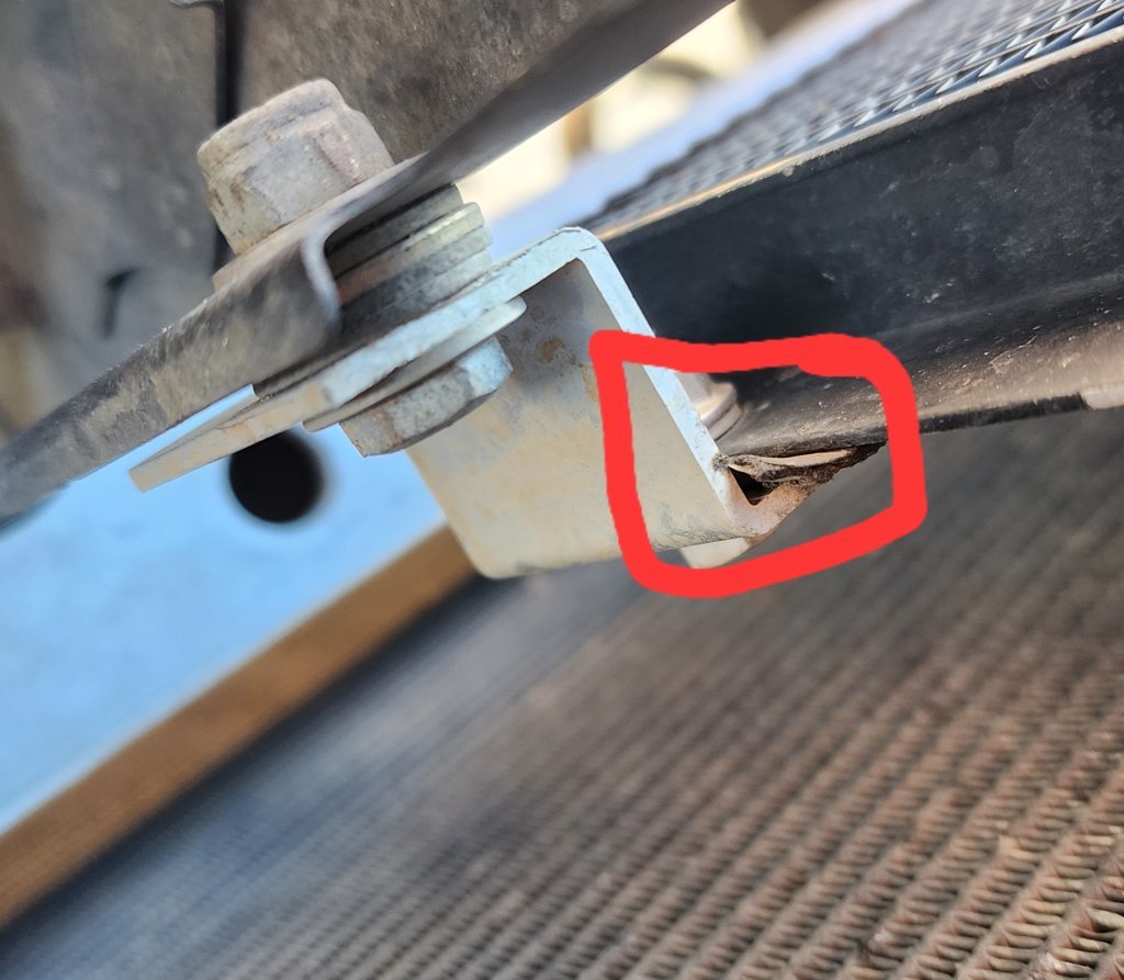

    The second picture is the right hand side of the cooler

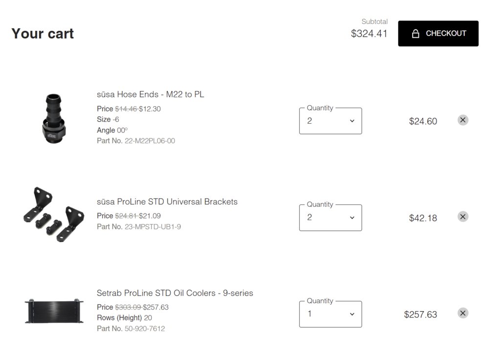

    Hey pman9003
    Does this look about right?

    Do you have any photos of that with the 90 and one 45 fittings.

    You are going to want different connectors. You have the straight ones in your cart, you need the 45deg or 90deg versions. Either of the two part numbers below. I am running two 90deg fittings. @BushBandit has said running one 90deg and one 45deg works even better, and I can see that being the case.
    22-M22PL06-45
    22-M22PL06-90
    https://setrabusa.com/products/susa-hose-ends-m22-to-pl?variant=41774934556726

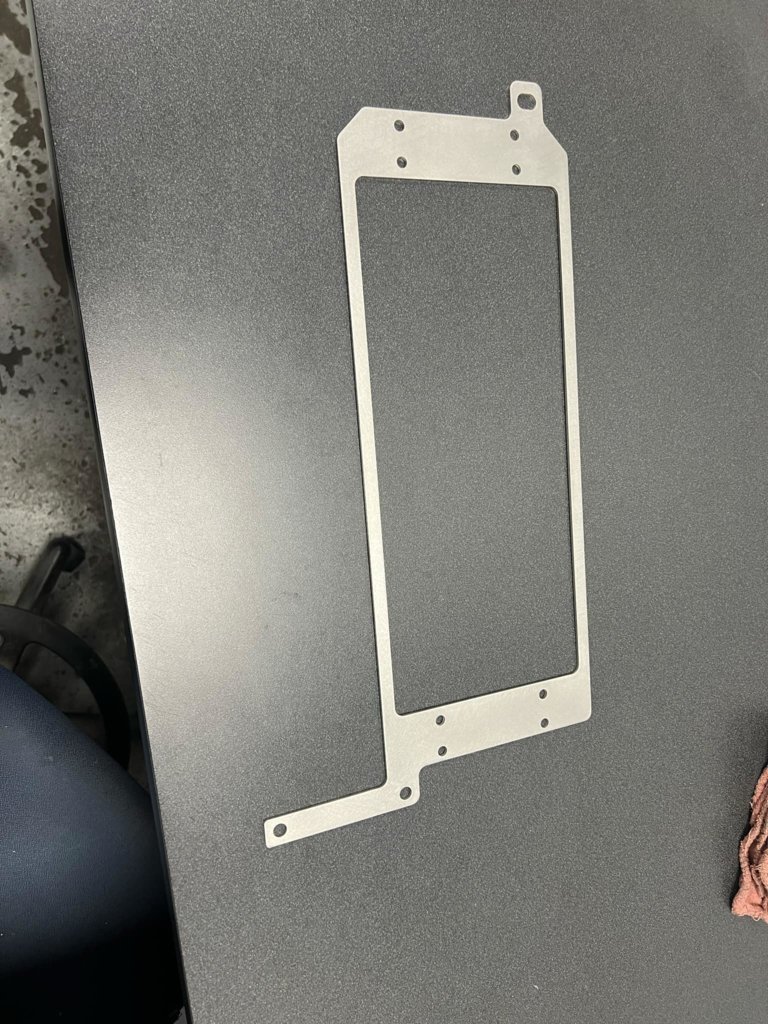

    Got my friend to cut me one. Now I need the cooler and parts.
