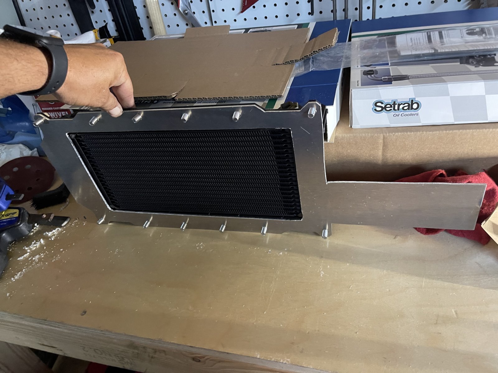

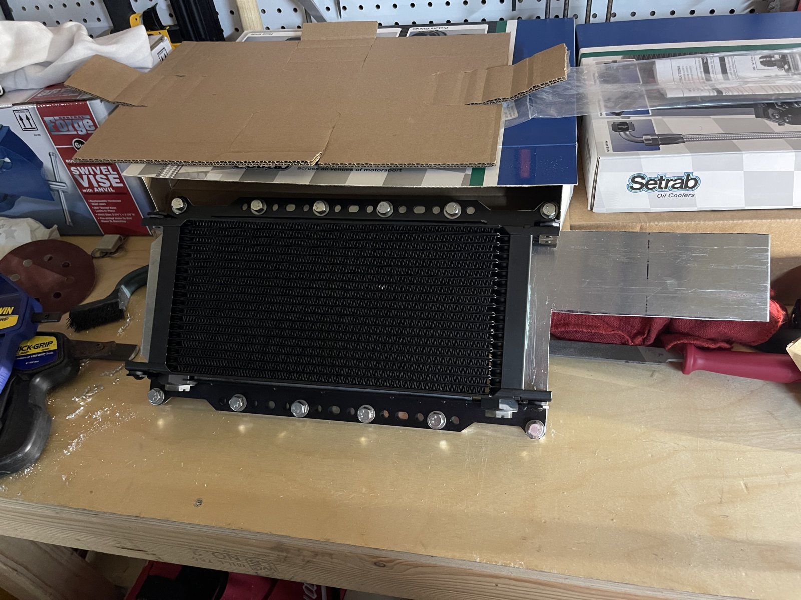

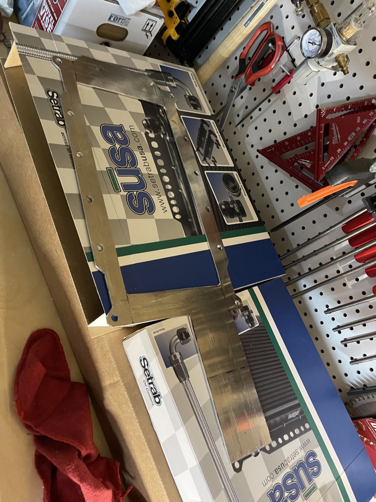

    I’m working on a few different styles. All use the same two bolting points at the bottom. One version has a tab that comes off near the top and attaches to the bolt that the condenser mounts uses to add a second point of contact on the top. Another other uses one point of contact. The brackets are flat for simplicity, I don’t see why this won’t work. Also, the bottom bolts it seems easiest to just put some spot weld nuts on a piece of metal for the bolts to attach to. I also toyed with another style that adds a mouthing point to the hood latch support, this would require drilling a hole and I’m not big on that.
    The first few bracket are based off the Setrab cooler. I’m sure other brackets could easily be made for multiple cooler sizes and models.
    I’m not looking to get rich, I was surprised to find that no one sold just a mount. I like to DIY things as I’m sure others on this forum do. Maybe no one is interested and I’ll just make a few to for friends and people local to me.
    I don’t think it’s a huge concern but I do plan to cover the hose from the cooler to the hard lines with a UV resistant split wire loom, spiral hose wrap, or protective nylon hose sleeve. Given how open the front grill is I don’t think some UV protection wouldn’t hurt and the cost is minimal. My history with boating has taught me that the sun is hard on exposed rubber.

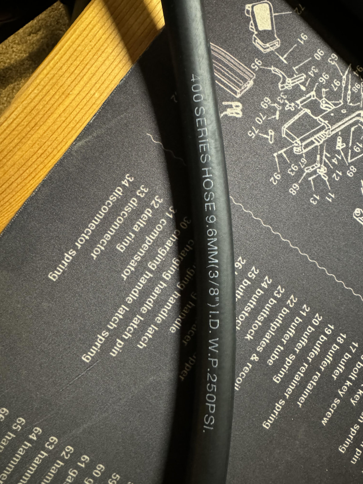

    400 series hose 9.6mm W.P. 250 psi

    Very helpful, thank you. I’m surprised that it only took 6ft of hose. For some reason I was thinking I’d need 8ft. I should be getting some brackets in the mail this week to test fit.

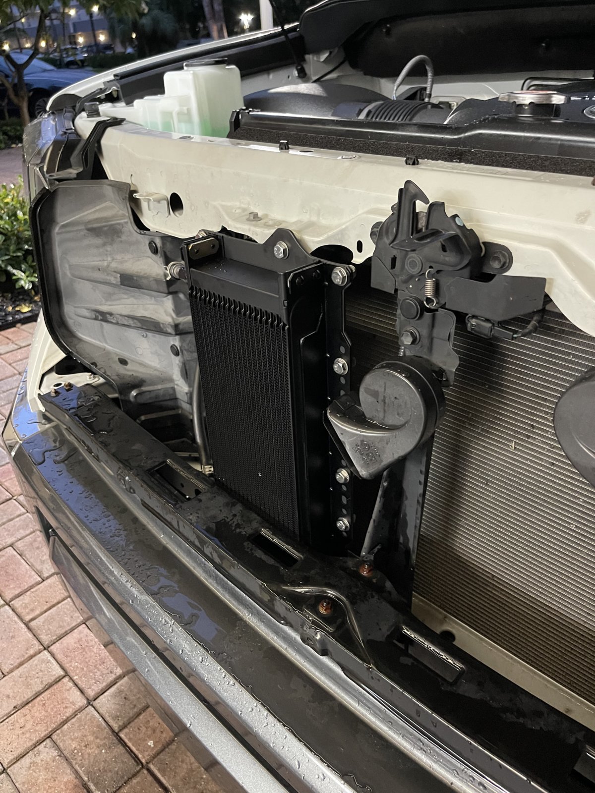

    I was able to get most of the transmission cooler kit installed today in a few hours. The Gates brand transmission cooler hose I bought was very stiff and didn’t want to go onto the hard line that runs from the thermostat to the front of the engine. The Gates hose is 3/8 but just stiff. I lubricated the hose and hardline but still it would only go about halfway. Gates hose part number is 27059 with a max pressure of 400 PSI.
    I went to Autozone and they had 3/8 transmission cooler hose which online said it was made by Continental but that same part number was printed on a hose that also had Duralast on it when I went it it the store. The hose had writing showing the J1532 rating with a max working pressure of 145 PSI. Will this be strong enough?
    The OEM short lines that run from the thermostat to the hard lines didn’t seem as robust as the Gates or the Duralast and went into the hardline with too much trouble.
    I considered putting the end of the Gates hose in some hot water to soften it up but not sure if it will split eventually since it would be so tight?
    Radarninja likes this.

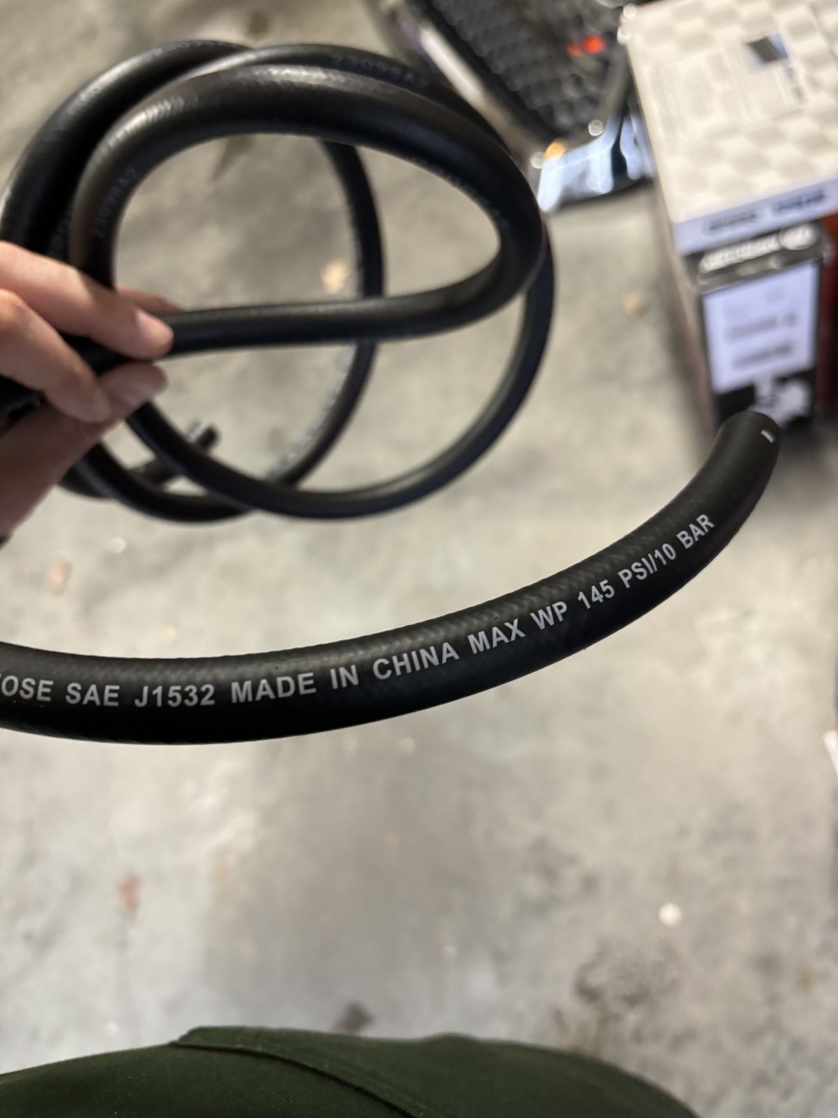

    This is a pic of the hose that comes in the Transmission cooler KIT. Not sure where it's sourced from.
    Here is a link that looks to be as good if not better.
