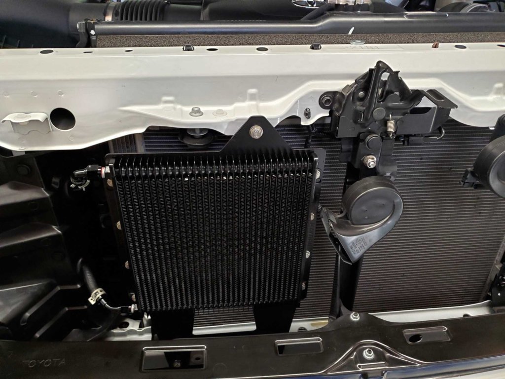

    Hayden 689 cooler installed with AN fittings from @LoMile_21
    He has a thread going in the 2.5 GEN forum where he does a cost breakdown and talks about installation for those interested. I believe this to be one of the most cost effective ways for adding a transmission cooler.
    Thanks for the photo @LoMile_21

    This may have been already mentioned or else I saw it in a video, after some thought I may go back and Loctite the threads on the cooler to fitting threads. This would need to be done after getting the hoses set in the desired position. I did not use thread sealant and did not observe any leaks, but I would sleep better knowing they won't loosen due to vibration. The fittings seal on the angle of the flare. Also make sure to hold the cooler side with a wrench when tightening.
  24. Mar 15, 2025 at 5:04 PM
    #54
    Jmunk
    Jmunk [OP] New Member
    Dec 18, 2023
    #108654
    137
    2020 Tundra SR5 Crewmax
    I have always just left the threads dry and assembled AN fittings. I do mark them with a paint pen on both sides, this way I can look and get a visual on if they’ve backed off any - none have. Some thread sealant is an insurance policy.
    It’s always a good practice to use another wrench to counter hold the other side of the fitting when torquing down.
