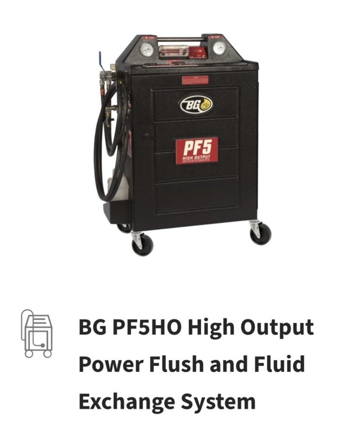

    Let’s do a flush day, sequoia vs 4runner; who’s will have zero issues after……

    I’ll pass on the power flush - I also don’t pressure wash my engine.

    I don’t have a need or want for a power flush when the vehicle can do the same thing in a “safer” manor

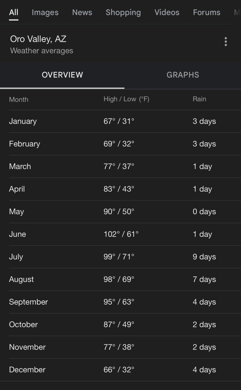

    Ideally we try to do it when it isn’t 110 outside.

    October - April.

    We ain’t Phx

    Basin heat is brutal.
