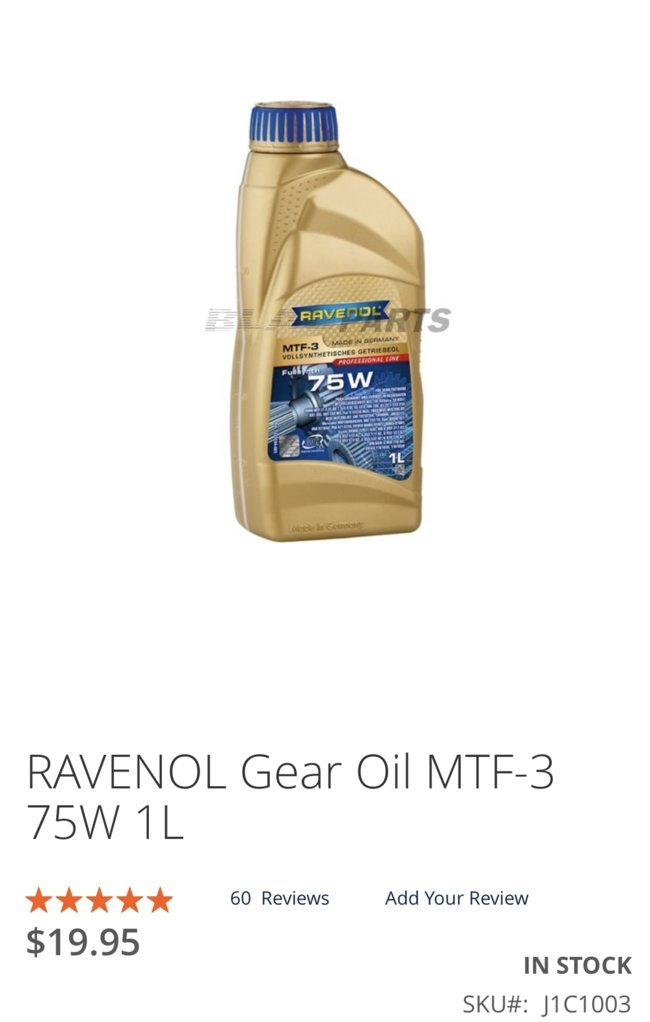

    At 1/4 the price, I hope it is a suitable substitute. I was not willing to gamble.
    Just my $.02

    Whats a 1/4 of the price?

    Ravenol $18
    LF 75 Toyota brand $80

    The comparison

    The Toyota 75W transfer case fluid can also be identified by more than one-part number. As many know Toyota has several divisions that operate in a variety of regions worldwide to support their automotive network. These different Toyota transfer case fluid part numbers are dependent on the regional location or country.
    Toyota Tundra 4WD models requiring 75W transfer case fluid part number 08885-81080 and 08885-81081. These transfer case fluid applications apply to models available in America only.
    Ravenol MTF-3 75W is a replacement for both Toyota transfer case fluid part numbers 08885-81080 and 08885-81081 for the following Toyota Tundra 4WD model fitments.
    • 2013-2020 Toyota Tundra 4WD 5.7L V8 gasoline models use 08885-81080 or 08885-81081 transfer case fluid.
