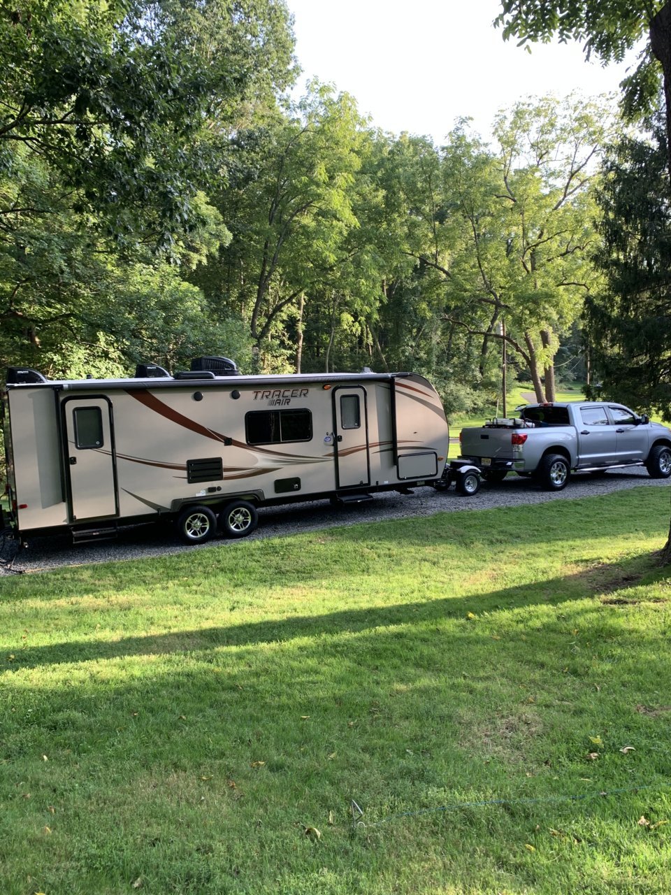

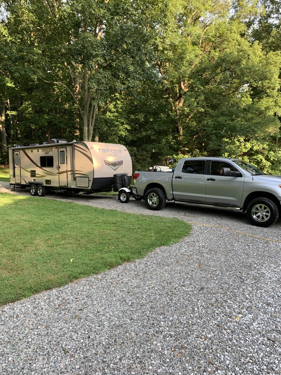

    I have a 2012 tundra crewmax and I use a trailer toad to pull my travel trailer. The trailer is 6000lbs loaded with a 650 lb tongue weight. I’m within all my ratings towing, which I have checked on cat scales fully loaded with family. Where I wanted more payload is I also
    Have a cricket mini golf cart i take with me now. So I needed to move the tongue weight off to stay within all my legal limits. Now my payload is still under 7200lbs and my gross vehicle is under 14000. It tows amazing with no sway and there’s no jarring in the truck because the toad has its own suspension. Backing is very easy as well. I picked mine up used but like brand new for $1700. I have been around cars, trucks and heavy equipment my whole life. The toad is a very well made piece. Any questions just ask. Happy to answer.

    Awesome info. It's good to hear from somebody that has actually used one.
    Can you post pics of the set up?

    That's awesome! This looks like a great solution for Tundra lovers who want a little heavier tongue weight.

    Are you using the stabilizer bar they reference on their website?

    yes round bar setup. I also have a Reese dual cam setup so I can pull the toad off put the dual cam on and use that if I want as well.

    If you are willing and able I’d love to see more photos of how you are setup. This looks like the solution I need to tow my trailer as I am currently at the truck payload limits. Does not make sense to get a HD truck for the driving I do when not towing.
