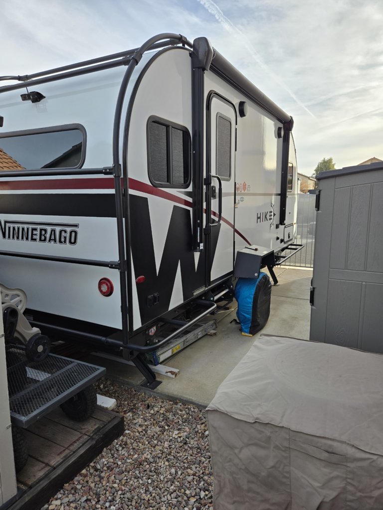

    Cleaned, inspected, and repacked wheel bearings on a '22 Winnebago Hike, looks good last a long time. Also stuck borescope down toilet to have a peek in black tank. Not horrible but we can do better. :rofl:

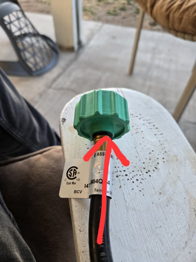

    Went camping Monday so on Sunday I ran all system checks and found one propane bottle pigtail leaking gas at the connector. We normally just run the left bottle so I decided to run the right bottle this time and got an immediate stench of propane. Soapy water sprayed it and it was pissing out from back of connector. Just another failure point I never expected. 20250205_164720.jpg

    If i recall, propane lines are on a 5 year replacement schedule.

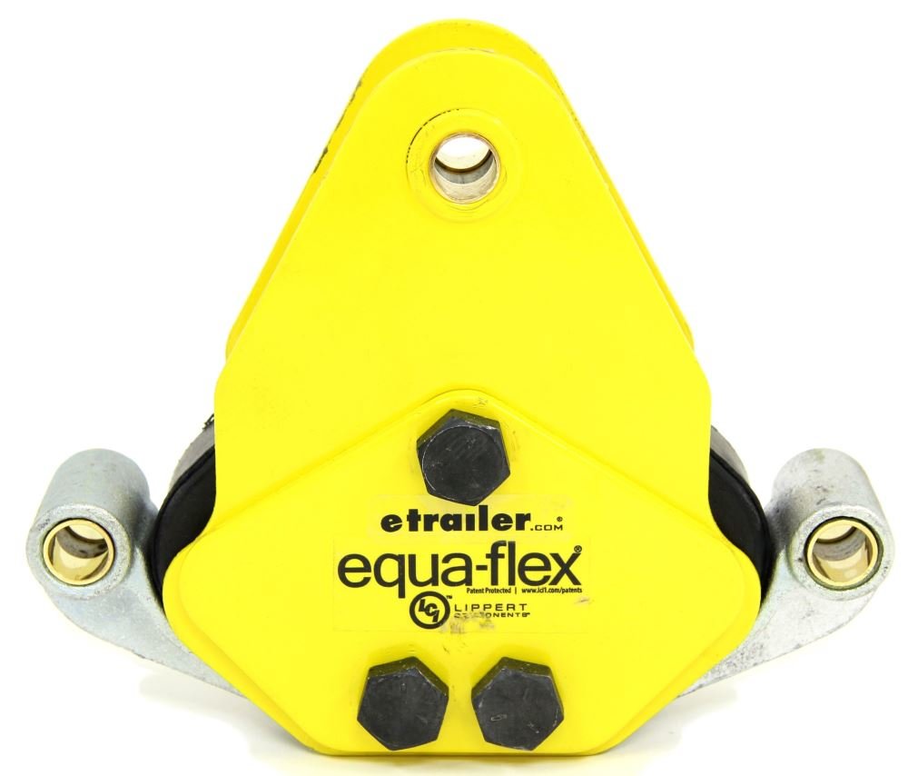

    My 7x16 enclosed is due for some maintenance. It’s my workhorse and has treated me very well, so I need to repay the favor. This weekend or next, I’ll be installing some Lippert Equaflex equalizers and greasable shackles, along with packing bearings and checking brakes and such. I replaced the tires last year but they are wearing down again (tires do that…); hopefully they make it through the summer.
    My travel trailer came with CRE3000 equalizers and it seems to tow smoother. Hopefully the Lipperts are worth the upgrade
    Anybody have experience with them?

    @blenton I put a set of those Lipperts on the 6.5x16 I'm currently refinishing so we can haul or SXS around. I also replaced all the leaf springs (a couple were bent), added a set of greaseable shackles, replaced the brakes, replaced the bearings, installed new tires, and painted it. I just have to install the rest of the lights so unfortunately I haven't road tested it yet. It was a lot of work but my wife's uncle retired from his stone mason business and hadn't used it in years so he gave it to us. It's a 2003 and has had zero maintenance. LOL. Here's a before and after, it still needs the lights finished and deck installed. Hopefully Sunday I'll wrap up the lights.

    @blenton I finally got to take a trip with those Lipperts and it towed really well. Did about 1300 miles of mostly interstate but there were some tight, curvy, WV back roads along the way with some pot holes and it seemed to soak them up well.
