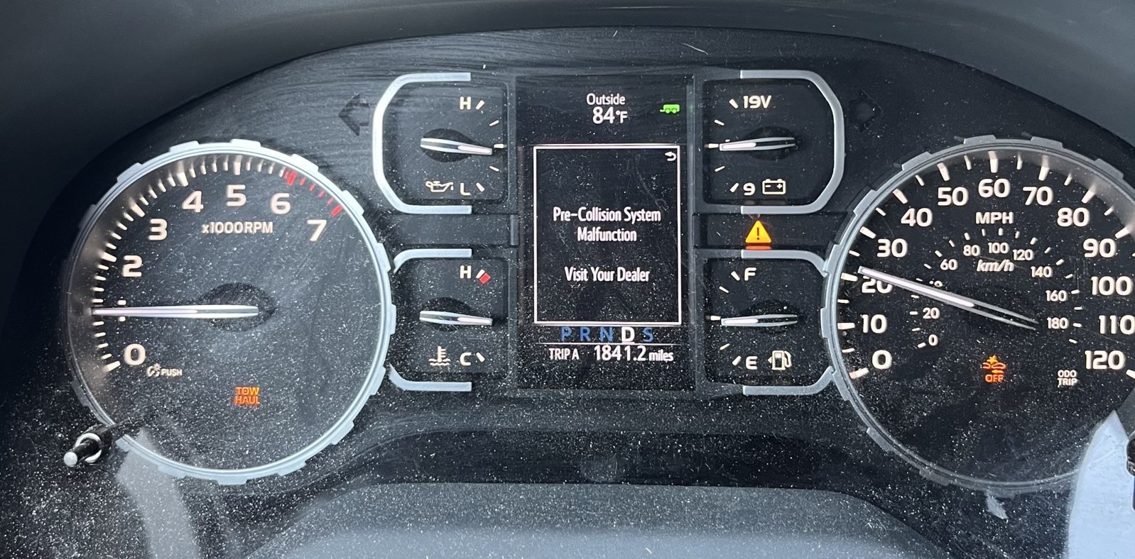

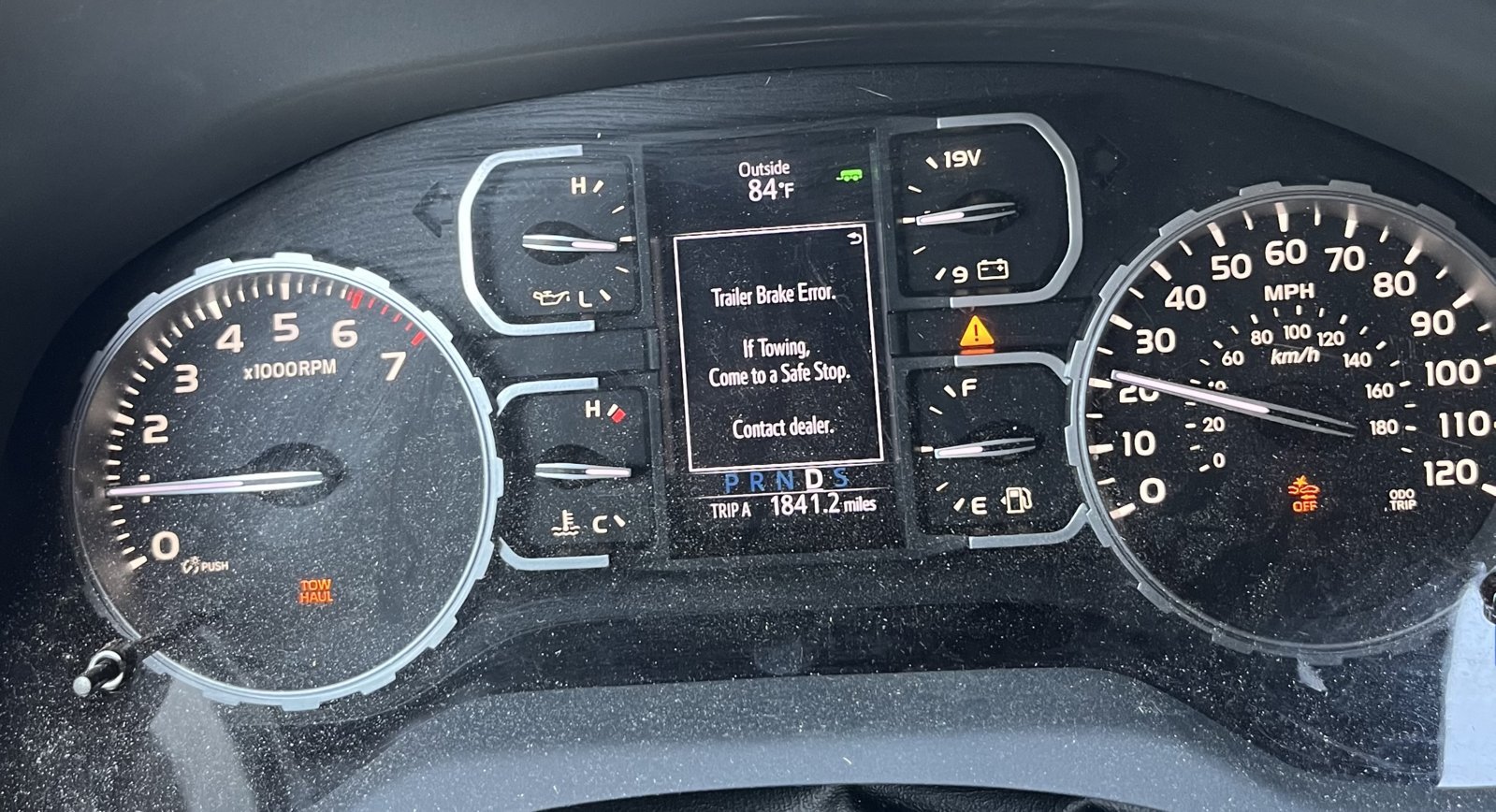

    Last month while towing my horse trailer I got these two warnings flashing on my dash. I had hauled to an event in the morning with no problems but when I got in vehicle to go home, these warnings were there. Have not noticed any issues with the feel of braking. And I have lights and signals working throughout.
    I hitched to our flatbed trailer to determine if it was related only to the horse trailer. Nope. I get the warnings with either one.
    HISTORY: I’ve had this truck for 3 yrs and from the beginning I’ve had an intermittent message with the IBC telling me the trailer was disconnected. Also have had the collision warning go off at seriously weird times but intermittently as well. Weird meaning an oncoming car in the opposite lane (not drifting over) and the blaring sound going off. Hate that. Most recently it went off on the interstate. I was in left lane next to the divider pylons for the toll lanes. Someone in the toll lanes passed me on the left (they get to go fast because they pay $$) and that bloody alarm went off. Scared the out of me! But intermittent meaning pretty rare that either problem has happened.
    Husband just took the truck to dealer (like it says in both warnings) and they had no idea and sent him on his way, so no help there.
    Has anyone experienced this or have any thoughts?
    UPDATE: After going back to Toyota, this time with a trailer in tow and having hooked to 3 different trailers but getting the same warnings, I stood my ground and told the tech, service writer, and another guy standing there that they needed to quit blaming the trailer and start looking at the “brain” of the truck to figure out the problem. Told them I wanted them to contact Toyota corporate to figure this out.
    Well, shazam! They called a short time later and learned they had a device they could plug into the 7-pin at the back that replicated a trailer and figured out the “brain” needed a new relay. Ordered a new relay. It came in the next week. All was well and I was able to haul my horse to NC with one hiccup.
    After taking a rest stop, when I restarted truck I got a different pair of warnings: “Pre-Collision System Unavailable” and “Trailer Wiring, Type, or Connection Fault”. Grrr! Still needed to get gas so went to get gas, shut it down, restarted after and haven’t seen any more warnings. Lights and brakes are working. The only change I made was to use a Velcro strap around the the trailer plug and hinged cover on the 7-pin receptacle. No issues since.
    I wasn’t thrilled at having an integrated brake controller but bought the truck during COVID when it was hard to get anything. Thought “What happens when the integrated brake controller has issues?” Prefer an aftermarket which can be switched out in a jiffy for a couple hundred bucks. Integrated going bad means you have to motivate techs to go beyond their usual scope, wait for parts to come in, and return to have installed.
