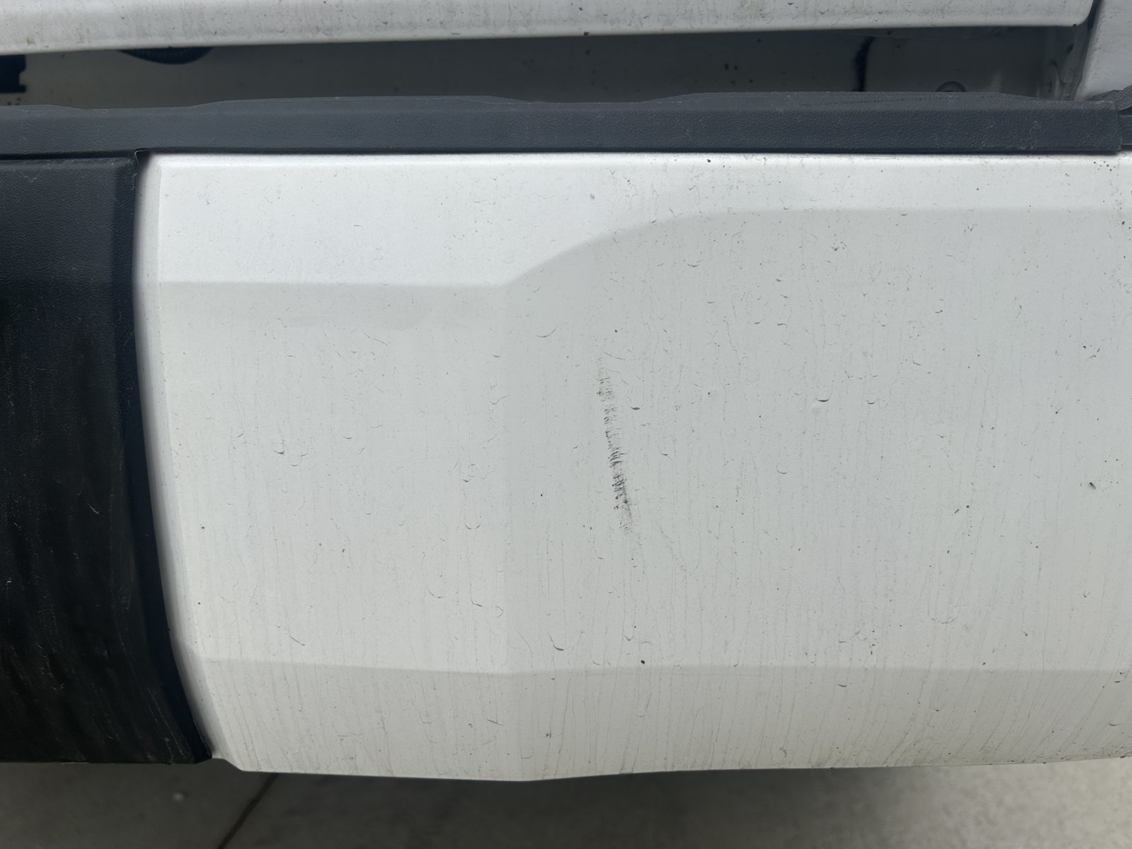

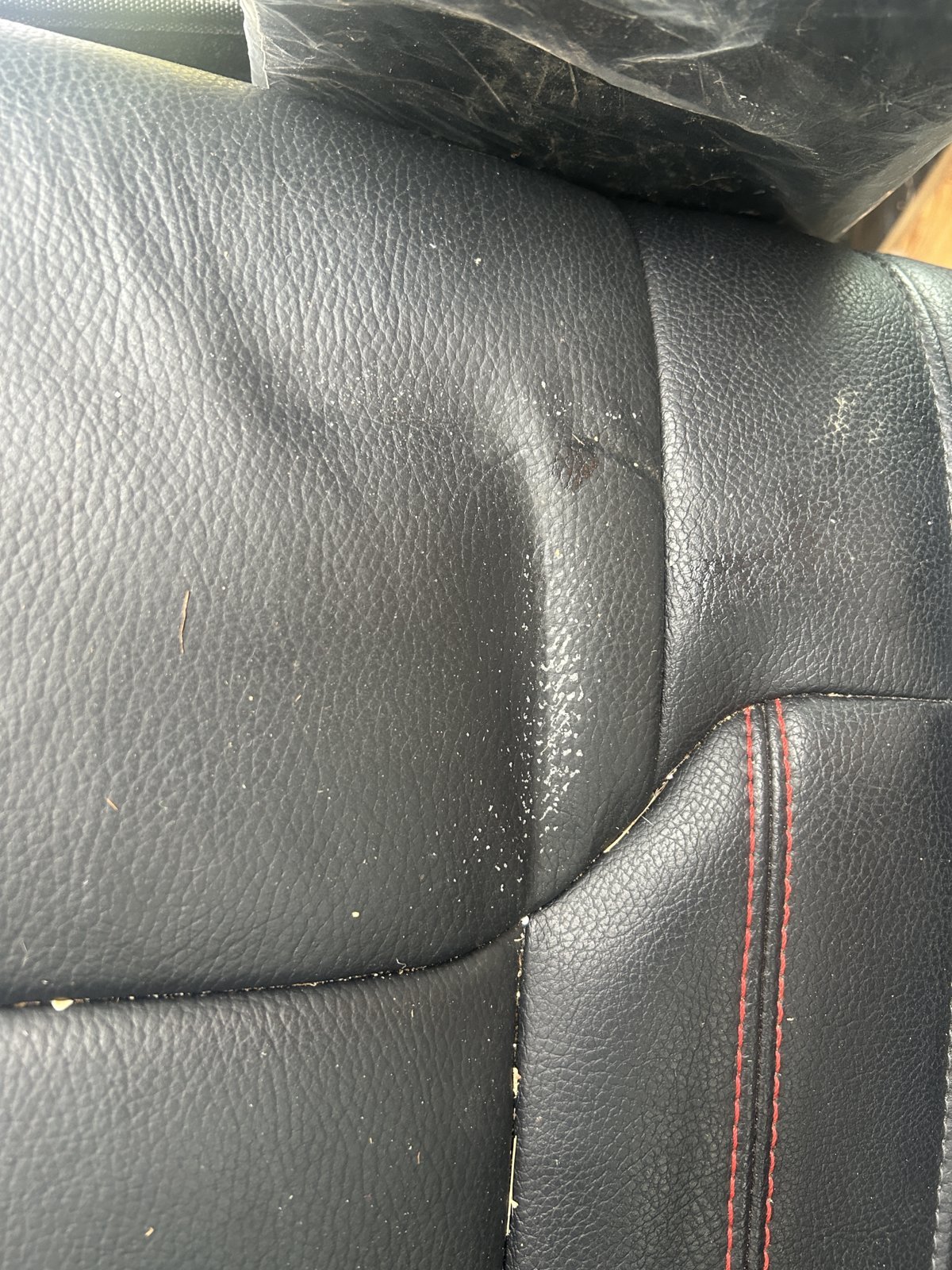

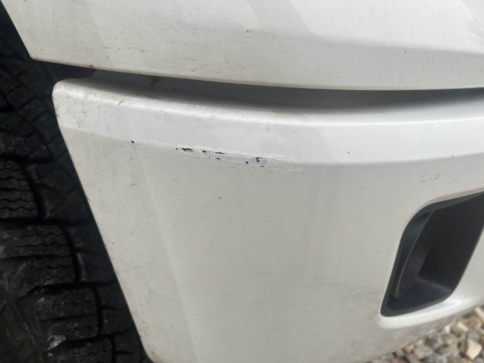

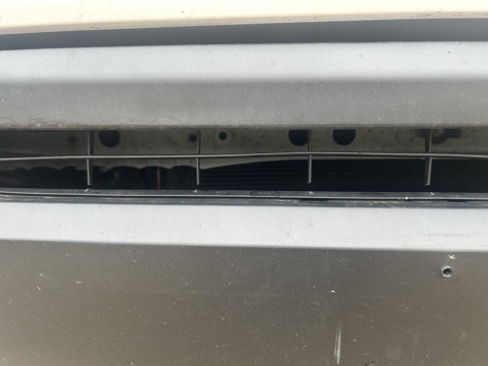

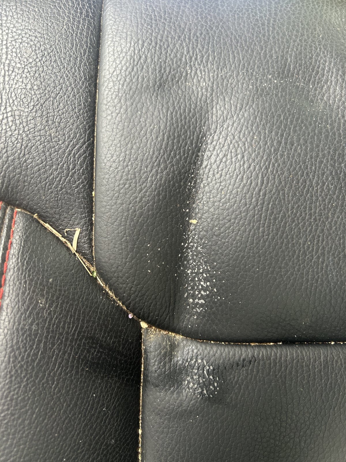

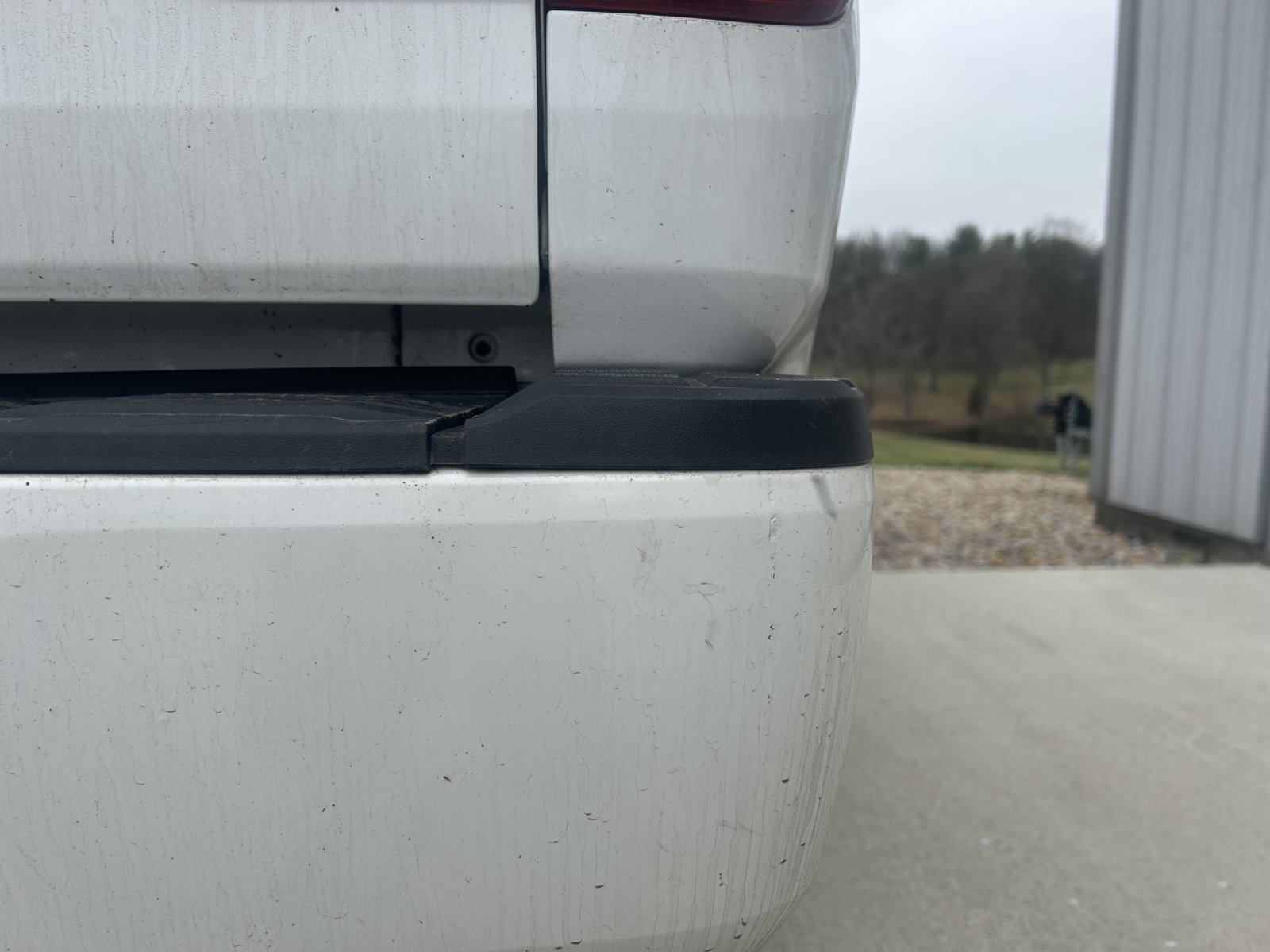

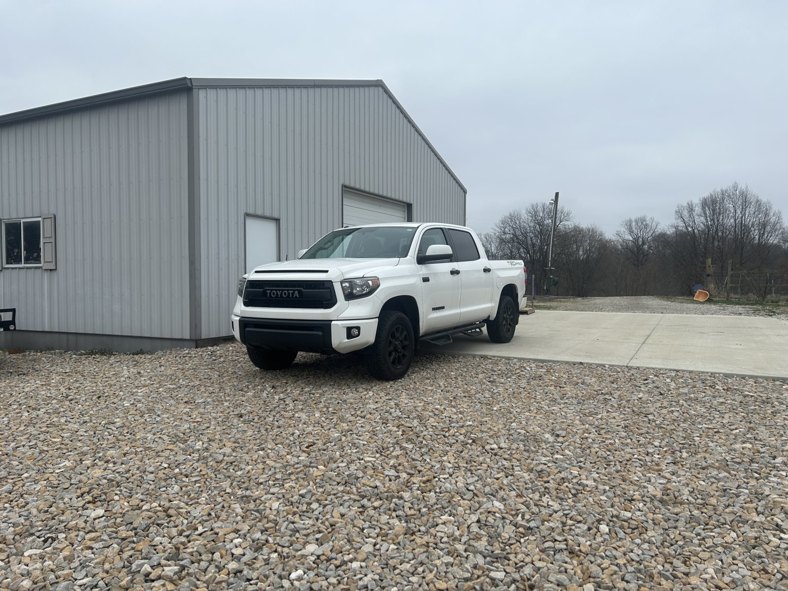

    Hi all,
    I have a few light scuffs on my front and rear bumper that require some touch-up. I also have some issues with my leather in the backseat. I had child seats installed in the back and under them, I put down some of the "child seat guards" but when I removed them recently, it appeared to have affected the leather a little bit.
    I'd like to fix these things before taking it in. I also have a dent in my tailgate but I'm going to leave that one up to the dealership/next owner.
    This has been an incredible truck and if I didn't have a need to tow more, I'd be sticking with this truck for a long time.
    Anyone have advice/links for cleaning up these minor scuffs and doing the leather repair?

    Start with thoroughly cleaning and conditioning that leather. Some heat will help too. The scratches seem to be through the paint which would require touch up. Then the question becomes, just to polish the area for maximum shine and leave the scratch? Or try to touch up and draw attention to the area with a messy touch up job. Could get a quote from a body shop to see what they would charge for it, but I bet in the end it won’t matter to the dealer taking it on trade.

    Looks like some of the scuffs could easily be buffed out. The other ones down in the paint would need touched up. Not sure about the leather but there might be some products out there that can fix that finish.
    Also wash that thing and then we can see some better pictures lol

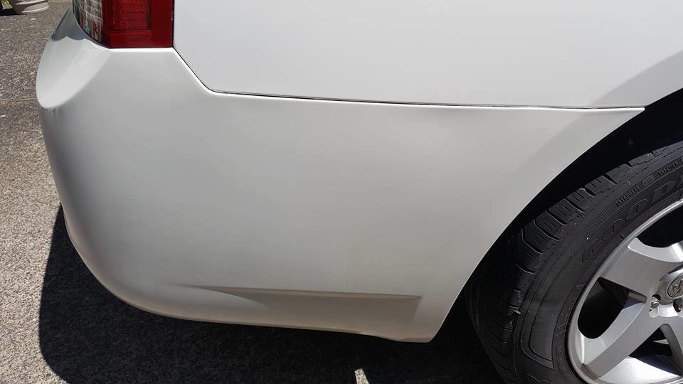

    I had some bumper scuffs and scratches on a Charger I owned and did a DIY job on. It's not really that hard and depending on the area only takes a few hours. All it took was a hand sander with varying degrees of sandpaper grit, primer, color matched paint, a basic buffer, buffer compound, and material to mask the area or areas off. Turned out pretty damn good.

    Hey, thanks. I'll be washing it before taking it for the trade-in.
    I found this for the leather. It allows you to pick the manufacturer, interior dye color and gloss. Think of a low gloss -satin.
    https://leatherworldtech.com/produc...bx3xLGD6roWDiObI7lnmmTMccz1c6QyhoCgzgQAvD_BwE
    There's also this leather product but it doesn't say specifically for autos:
    https://clydesleathercompany.com/pr...5eprb6K2l7EumNsh8MZBoCiyQQAvD_BwE#looxReviews
    Also going to grab this for the scratches to see if I can make it look like new again:
    https://www.autozone.com/paint-and-...t-super-white-ii-pen-paint-code-40/460687_0_0

    Seat will pop out, give it a few days.

    I think he's referring to the scuff marks in the leather. Not necessarily the indentions in the foam.

    I don't see anything. Looks more like some spilled juice or other kid's byproducts.

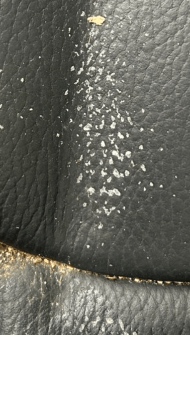

    This is what I'm seeing. The white spots from where something is abrasive against the leather and wearing it down

    Or white came off car seat?
