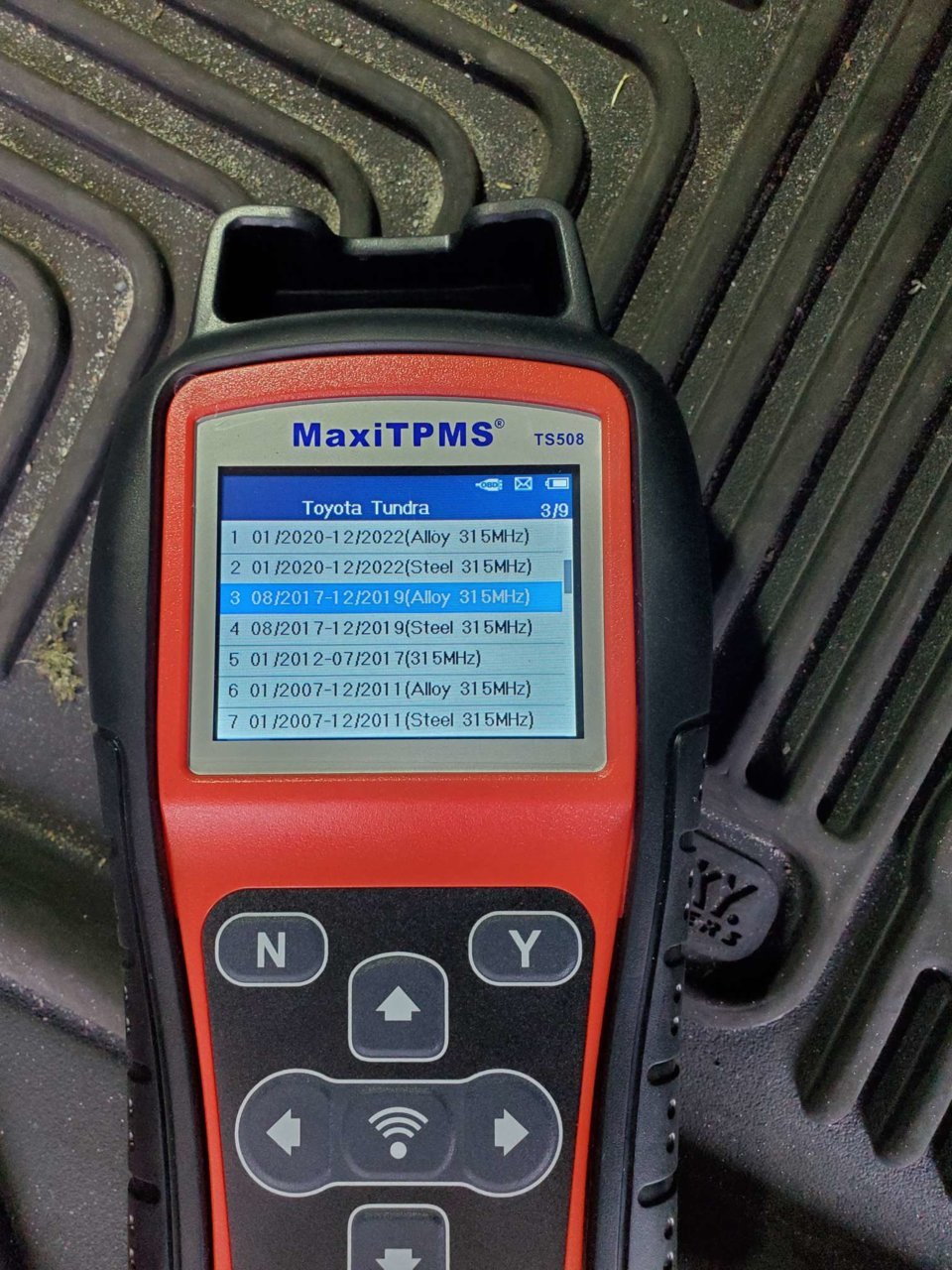

    I haven't tried yet, but I did talk to Autel today. He said try an earlier model year (#3) or drop the tire pressures about 10 pounds and it should trigger the sensors to be detected.

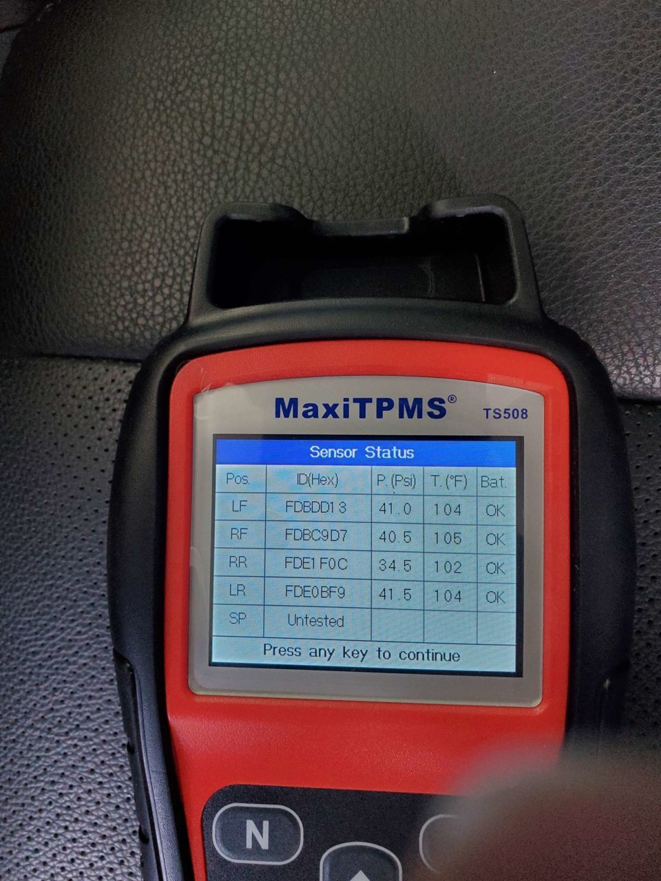

    So I was able to use #3 and it was able to read and trigger all 4 sensors very easily. Now I'm stuck on the position relearn procedure. When I turn the ignition on and plug into the OBD, the tool does not do anything. Am i.missing something? I can't believe a tire rotation can be such a PITA. The truck apparently sees that the sensors are there and just not showing the pressures. I deflated the tires to 30 psi and the TPMS light came on with a notification that a tire was low. I aired them all back up and the light went out. I tried the reset again as stated in the manual and went for a drive. Still a no-go on detecting pressures...that's why I bought the tool. At least the 4Runner shows the pressures, just in the wrong tire positions as I rotated tires from front to rear. I haven't even messed with that one yet.

    I'll look at mine and post pics. The 2020 option in the TS508 doesn't work for the 2020. I had to use the 2019.

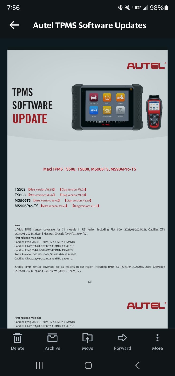

    Update available for the TS508
