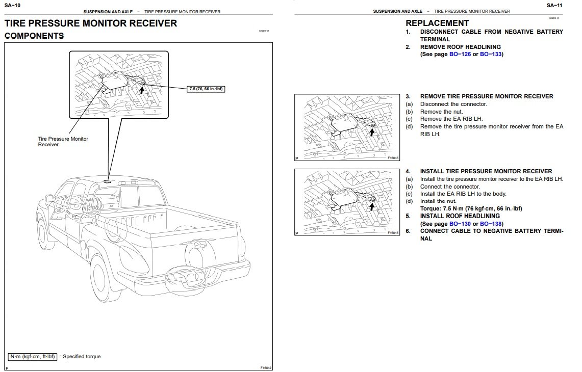

    I know all about what the TPMS does. I know about grounding one of the wires. I know about supplying a 5V signal to the ECU to make it think all is good. Knowing all of that does not tell me where the TPMS Module is located. That is what I would like to know. Where can I find the TPMS Module on a 2006 Toyota Tundra? Mind you this is a 2006 Tundra. I DO NOT need the TPMS and I do not need to spend the money to fix the TPMS. I just want to bypass the TPMS. Can anybody show me where the TPMS Module is located and how to access it?
  7. Jul 30, 2022 at 6:25 AM
    BubbaW
    Aug 19, 2019
    #34845
    3,831
    Bubba
    Where Eagles Nest
    04 DC LTD 4X4 4.7 V8
    T150 Lover
    The 06 TPMS RX is located in the roof and removing headliner is how you would access it.
    from 06 FSM....

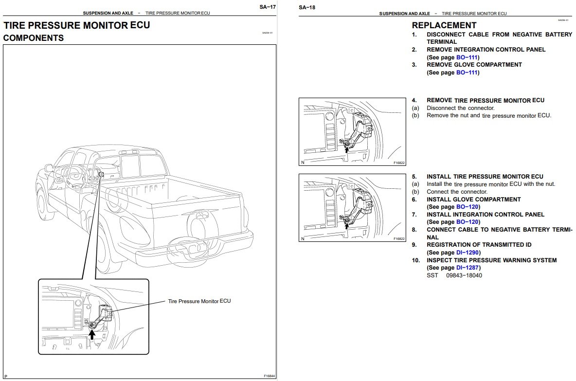

    from 06 FSM....
    edit....

    If you remove the glovebox, you can find the TPMS ECU (not the receiver) to the left toward the head unit and above the HVAC controls. Access is a bit tight, but I was able to get to the connector and do what needed to be done. The module is labeled. Both were on ‘06 models as well.
