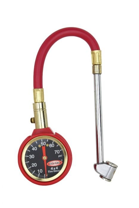

    I'm old fashioned and still talk to my tires with one of these (that includes the spare).
