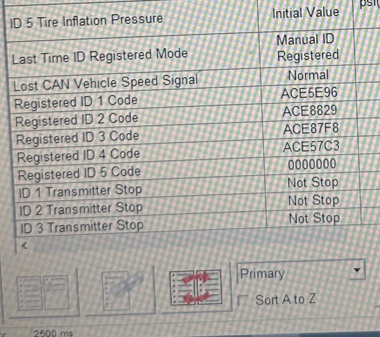

    Does this look like the correct sensor ID codes? They seem odd since they all start with ACE
  6. Feb 18, 2024 at 5:30 PM
    #36
    Cassidy1866
    Cassidy1866 New Member
    Aug 28, 2023
    #102926
    62
    2023 Tundra Limited TRD Off-Road
    Yea, those look right. The 5th OEM sensor I purchased had a 7-digit ID code that also happened to start with the letter “A.”

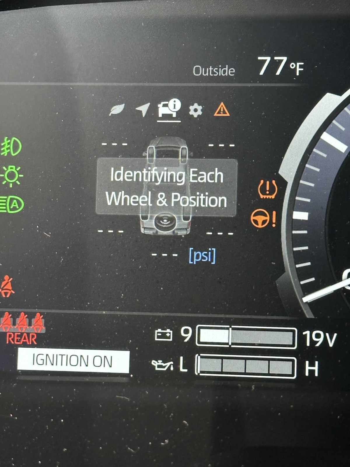

    -Turn the truck on, drive a couple miles so that the tpms's are activated.
    -On the dash menu, navigate to settings>vehicle settings>TPWS>relearn
    -Start driving once the tire pressure light is blinking. My truck took 10-15 mins for the tire pressure light to go away. All four tires are recognized and show correct pressure.
    What's probably more difficult is to get the 5th wheel to register. The tpms on each wheel only gets activated once the wheels have been turning for a little while. So, carrying a static wheel in the spare location isn't going to turn it on. I'm guessing you'd basically either have to sync up the original 4 wheels, then the swap one active wheel for the spare and relearn again, or, manually program all 5 at one time.

    Boom! Easy as 1 2 3… I’ll post some screenshots later on how to do it with tech stream…going to get it balanced now. Hopefully it will be showing the PSI by the time I get back..

    is that a screen shot of a 2022+?
  23. Feb 24, 2024 at 5:52 PM
    #53
    Dpoll995
    Dpoll995 New Member
    Jul 6, 2017
    #8436
    341
    Houston TX
    2024 Tundra Limited
    Yes 24 limited

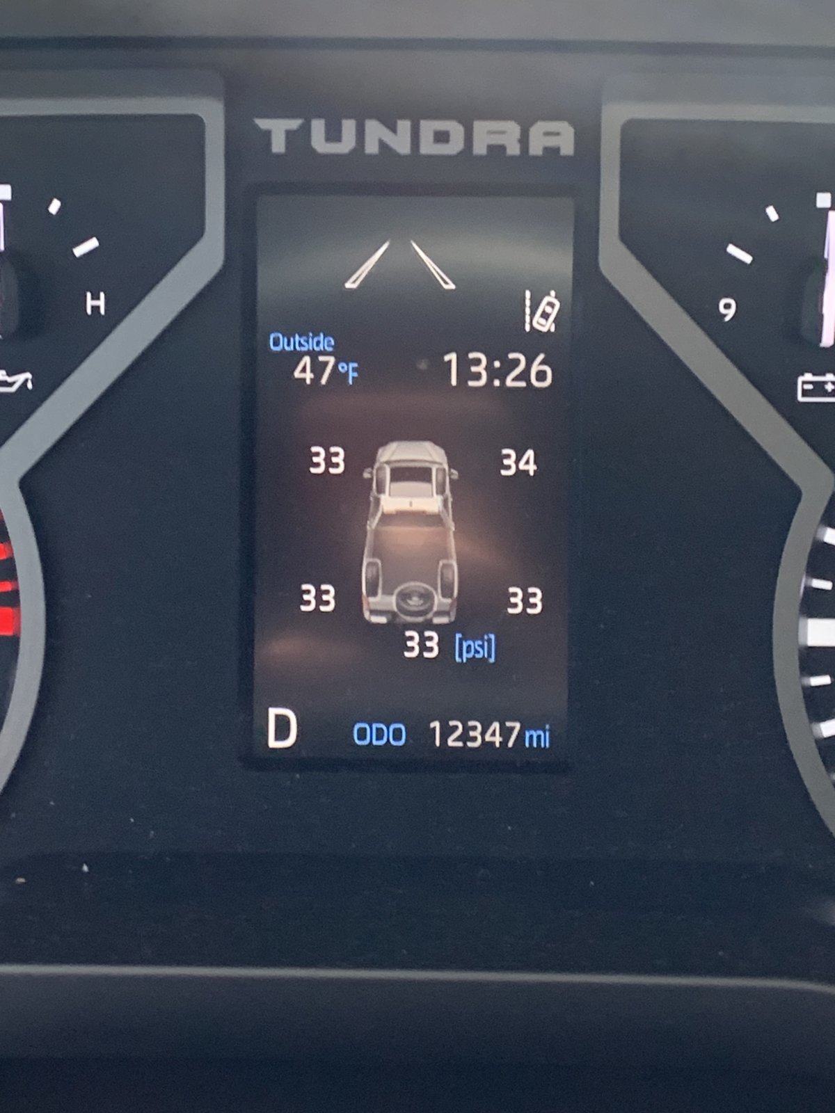

    I had the dealership activate my 5th sensor spot this week when I went to pickup my 2nd key.
    I didn’t have the full sized spare with me. Strangely it took them nearly 2 hours to get the truck finished. When I got home I mounted the 5th wheel and started the relearn process again. The sensors took much longer to learn this time. Four wheels took about 20 mins. Adding the 5th took about an hour and 15 of total drove time over two days. The truck continues the relearn even if you turn it off overnight.
    Happy to say that of this morning all 5 are displaying on the dash.
