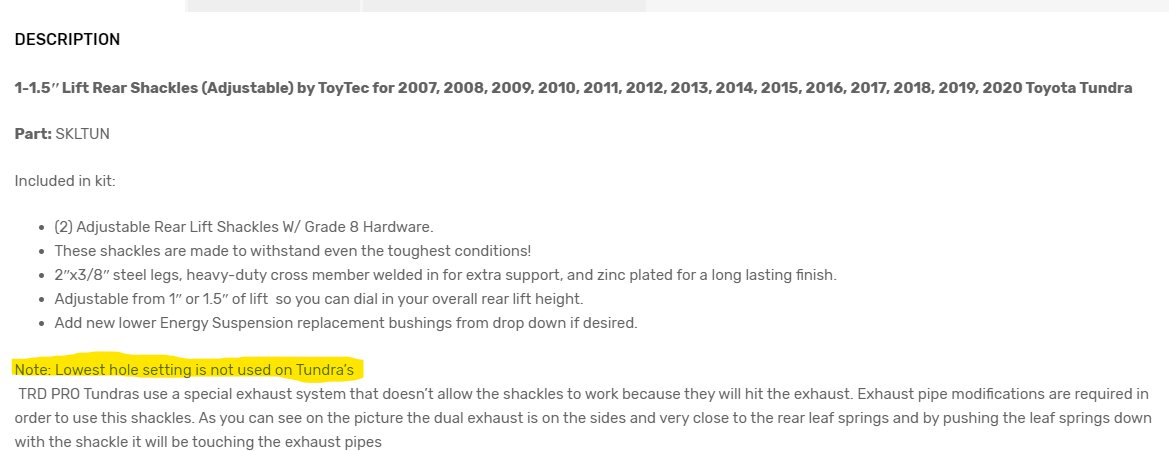

    so the description for Toytec shackles states that they are not to be used on the lowest hole setting for Tundras. If thats the case, then wouldn't the bolt rubbing issue be non-existent?

    The lowest hole would put the shackles through the bed. The second hole you have rubbing on bed bolts. Makes you wonder why that if this is designed for the Tundra then why is there a third hole at all.

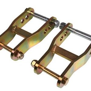

    Alot of them
    The older ones have 3 holes as pictured. The new black ones do not. They only have 2 holes.

    thats what I saw as well. new ones only have two holes and if you are not suppose to use the bottom hole as noted. would the shackle still hit the bed bolt on the top hole?

    The bottom hole on the older ones doesn't get used on the Tundra. On the black ones, the lower hole is the 1 inch setting, and the other is the 1.5 inch setting. The 1 inch setting is what touched the bed bolts on some trucks.

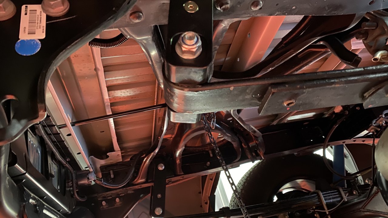

    Update: I got the squeak on one side. It’s been a few weeks since the install, things must have settled.
    I am debating my options. If I have to take everything off to grind the bed bolt I may just replace them with CB +1s.

    You should be able to do it without removing the shackle. A few on here have done it.
