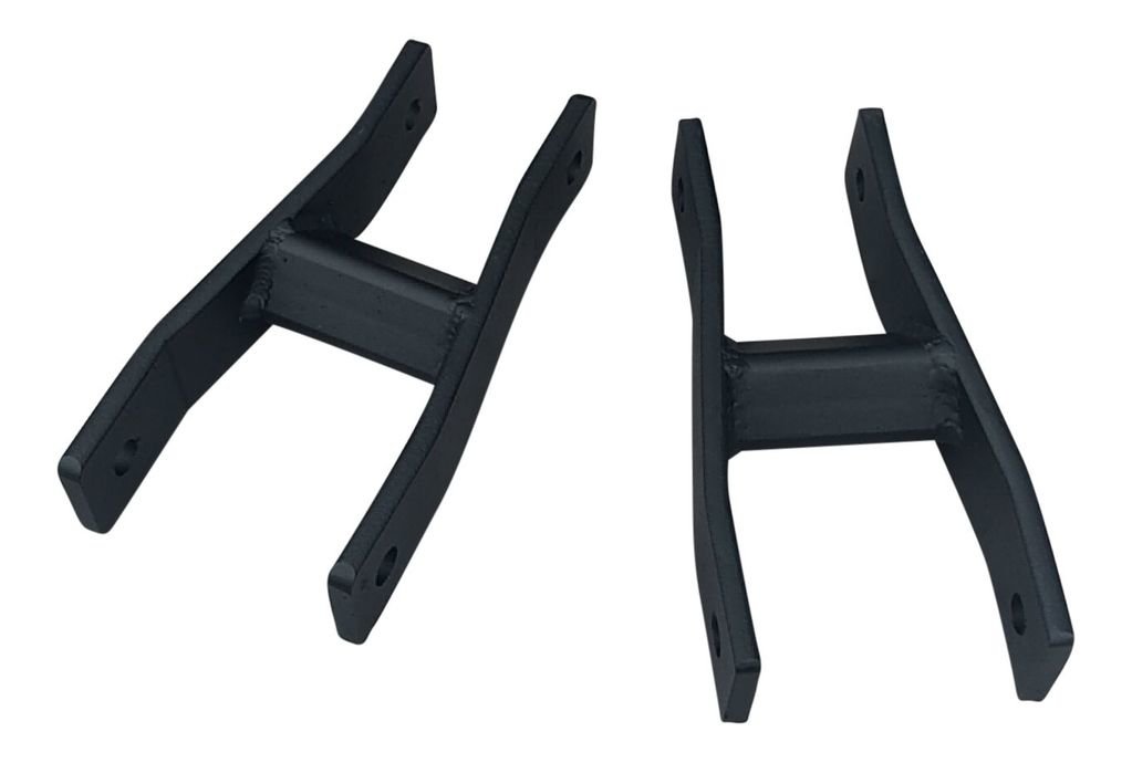

    I want to hear some reviews on the Proform Fab shackles, only $50.

    Very heavy duty. Very affordable. Nice powdercoat finish. Mine were jigged up slightly off when welded. Upper bolts don't line up. About 1/8" off on both shackles. Going to attempt to correct the issue otherwise calling Toytec for another set of their shackles. Had them on my 07 for 5 years with zero issues. CB's are decent too. Depends if you want adjustability or not. CB and Toytec are both long time approved vendors here.
    Squig[QUOTED] likes this.
  20. May 1, 2020 at 8:21 AM
    #50
    43,525
    I want to clarify this...
    I'm not telegraphing any negativity towards Pro Form Fab. This is partly my fault. I had these sitting around for months. I should have checked them closer when I first got them out of the box. The Pro Form guys were nice. I'm sure they would have sent me another set. A bit late late now to complain. Things happen. :thumbsup:

    I have decided to go with Pro Form Fab 1.5" for $49.95, it's a shackle, no frills, no bushings, no hardware. You use your factory hardware. No way a 1.5" shackle is going to adversely effect your springs, I just don't see that happening.
    I like the price point and simplicity of the Pro Form Fab Shackles. K.I.S.S.

    But wait, I just had a thought. Are the factory shackle bolts Press Fitted? If so, how will I use those bolts on the Pro Form Fabs?
    DUH ME :facepalm:.

    The factory bolts are pressed in, so I don’t know how you reuse stock hardware...:monocle:

    I just spoke to the guy at Pro Form Fab. He says to use a hammer and knock out the bolts from the factory shackles. They have splines and will press fit into the new shackles. WE SHALL SEE.

    Yep this is what I did with my pro form shackles

    So, you had no problem knocking out the factory bolts, then using them in the new shackles? That's good to hear.

    Correct.
